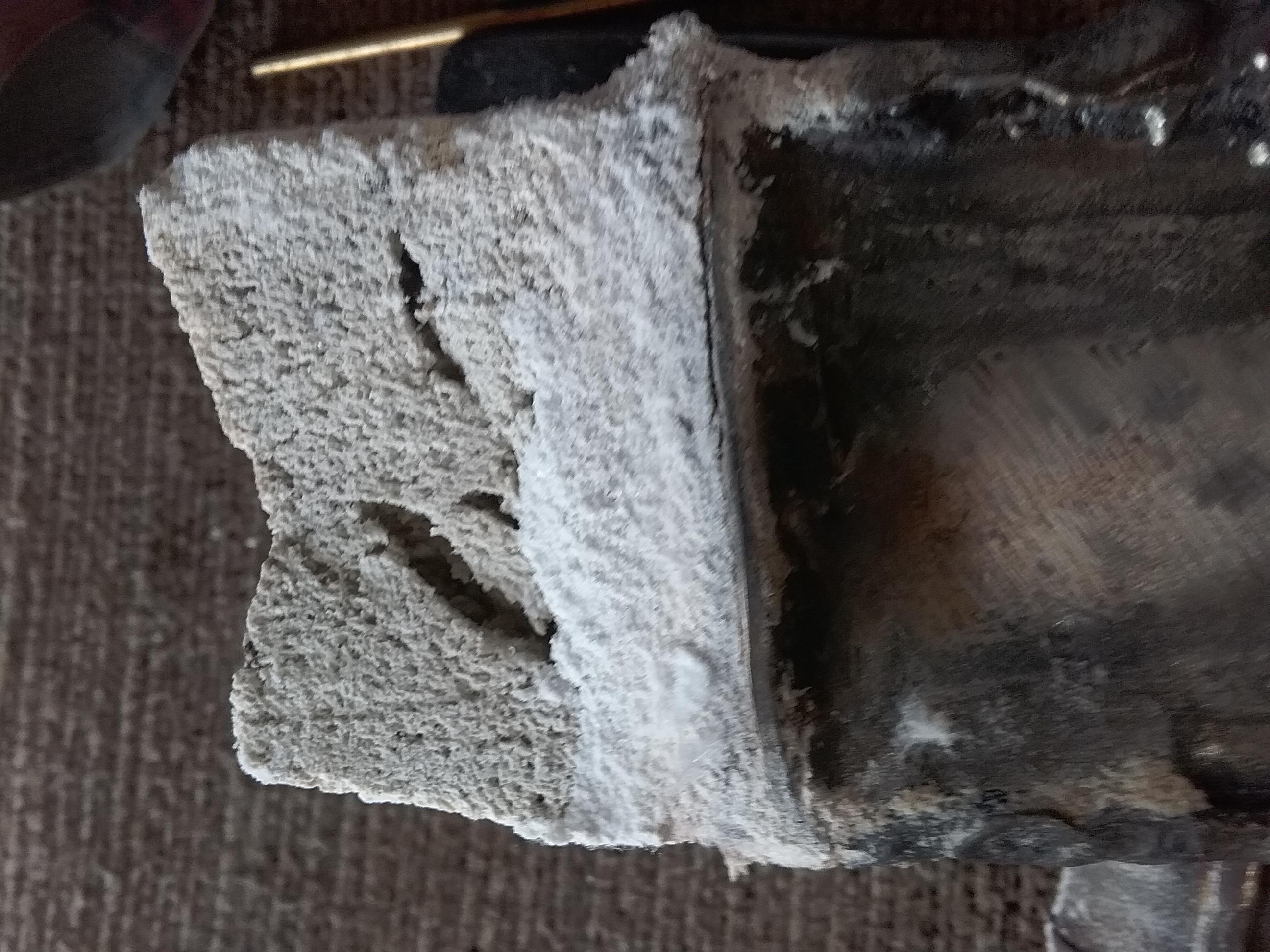

Update:  My (NARB) IFB ribbon burner block with 1/8" drilled holes failed tonight.  However, it appears to me that the forge exceeded the maximum temperature of the fire brick rather than cracking or crumbling.  I had been forging billets for pattern welded blades for a couple hours at nearly white heat when I heard the change in the burner.  It looks like it slumped inwards towards the plenum.  I'll know more this weekend when I have time to remove it and examine it more closely.
This was just standard soft 2300 degree F insulating fire brick.  I'll probably get some Morgan K26 or higher rated bricks and try again.  Overall I still think the concept has merit.

Morgan K-26 is only rated a little hotter than 2,600 f. IIRC they make IFB rated significantly hotter. 2,800 f - 2,900 f  I think?

I have some Matrikote I may try, but I'm thinking that if the internal forge temperature is higher than the maximum temperature the brick can withstand and maintain structural integrity it probably won't matter much if the outer surface is coated or not.  Worth a try though since it doesn't cost much to do it.
I was actually pleasantly surprised that up to this point I hadn't seen any cracking between the drilled outlet holes or any of the other normally observed failures of the bricks when they are used as forge walls or baffles.

Here's a couple pics of my soft insulating fire brick burner block meltdown.  What appears to have happened is the burner block melted (or at least sintered) in the interior of the block without significantly deforming either the plenum side or the forge side of the burner block at first.  The third picture shows the plenum side of the burner block after removing it. Eventually gravity won the battle and the weakened flame face of the burner block slumped inward towards the plenum.  My NARB is floor mounted facing upwards.  In addition to turning a portion of the IFB into a glazed maze of tubes, a portion of the side also failed and turned a small section of Superwool into a similar material.
On the bright side, the time to remove the burner, take pics, break out the old IFB, drill a new block, seal it with refractory cement, and remount in the forge was less than 2 hours.  That includes one failed burner block that I managed to break by pushing a little too hard when fitting it into the plenum.  Of course these things always break when you are nearly finished rather than when you first start out.
I have a couple 2600 F rated bricks (Greentherm is the brand I think), so I used one of those for the replacement burner block.  I ran the forge for something like 6 or 7 hours between Saturday and Sunday without mishap.  I did a little more forge welding, but I did back the temperature down a little.  So far so good with the new block.
