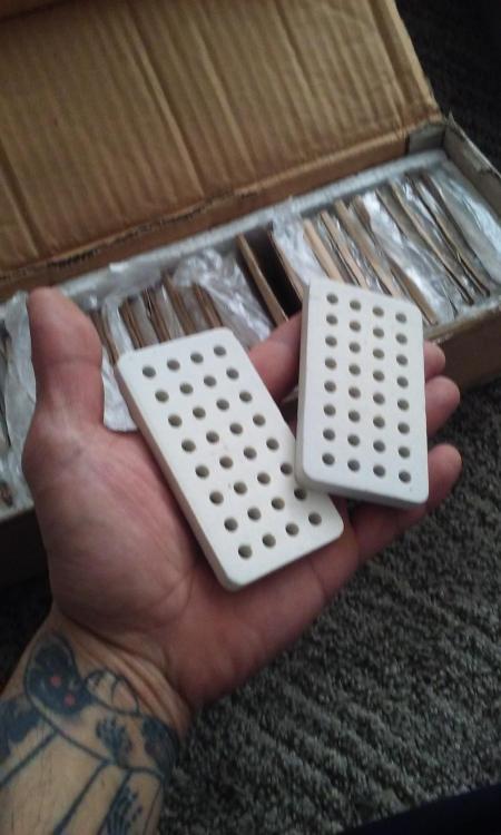

Jbradshaw Posted July 9, 2019 Share Posted July 9, 2019 I used a forge this weekend that was running a multi port burner using a ceramic foundry filter for the face (3/4” T burner). We ran the forge for at least 6 hours with no backfire. I’ll post a picture from the manufacturers website below of what the filter looks like. He only used one filter about 2” square so there was still a hot spot in the forge. I think two of these stuck together with some furnace cement would make for a nice burner face and spread the heat a little better. So far I’ve only been able to find these for sale by the box. With the smallest box being 100 count. It also has me wondering if anyone got anywhere with using the ceramic barbecue blocks. I saw a test burner a few pages back but no final product. Quote Link to comment Share on other sites More sharing options...
671jungle Posted July 10, 2019 Share Posted July 10, 2019 I have not visited that project in a bit. although i am thinking of building a heat treat oven with 1/4" burners that may power these little bbq plates. the pic is of a 1/2" if i remember correctly. I didnt tinker enough to get the ratios right but it is definitely doable. I am concerned of thermal cycling cracking. Maybe a Kasto 30 soaked ceramic wool layer over the face might help? On 7/9/2019 at 7:41 AM, Jbradshaw said: foundry filter that looks ideal On 6/28/2019 at 10:18 PM, Frosty said: IT'S R O B O T FIGHTING TIME! such a good show! Quote Link to comment Share on other sites More sharing options...

Frosty Posted July 11, 2019 Author Share Posted July 11, 2019 Shambolic? Great term, consider it adopted, that's the secon today. One of the guys in our club is still looking for his, "Forever Anvil." I've built 1" burners but it's tough fitting them to the forge properly, all that heat is in one place and its hard to turn it down low enough. I think your excessive "dragon's breath" is an example of too much burner for the volume. Even a ribbon would have similar issues. With 2 burners in the same volume you have much better temperature control, you can shut one off for serious curn down. Nice story but I don't see any pictures. You don't REALLY expect us to believe it without pics do you? Frosty The Lucky. Quote Link to comment Share on other sites More sharing options...
