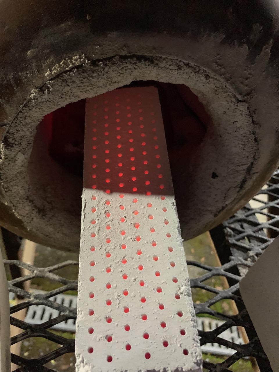

D.Rotblatt Posted April 29, 2019 Share Posted April 29, 2019 On 4/28/2019 at 12:03 AM, D.Rotblatt said: One thing I'm thinking, is that I don't need as large an internal forge diameter with this burner In line with my earlier thought, I added an inch of ceramic fiber to my forge reducing the interior to about 4.5" wide and high. The burner is actually about an inch higher since the brackets didn't allow it to be lowered too much. Since the forge is 8" long, that gives it an internal size of around 180 square inches. Maybe smaller since the top is rounded (kind of...it's an odd shape now). Runs fine with the NA 1/8" ribbon burner, no problem with back pressure. Definitely getting hotter easier and quicker. Choke wide open. 5lbs = 1950, 10lbs = 2150, 15lbs = 2250, but didn't go up much at 20 lbs. So I closed off the top 1" of the door with some ceramic fiber and the temp jumped up to 2300. Then I played with he choke on the burner (it's a standard Reil burner going into the plenum), and closed it down about 60-70% and the temp went up to 2370. Two lessons learned: 1) a lot of heat leaves out of the top of a high door, 2) a reducing flame seems to be hotter in this forge or with this ribbon burner. Dan R Quote Link to comment Share on other sites More sharing options...

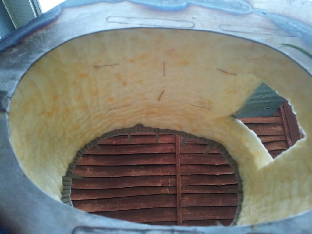

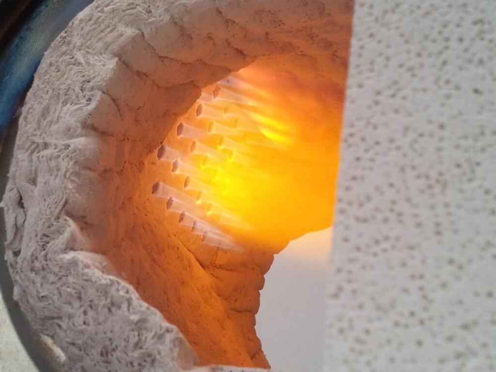

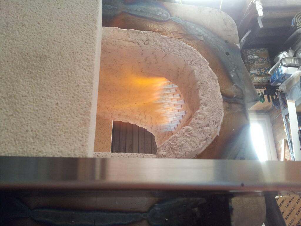

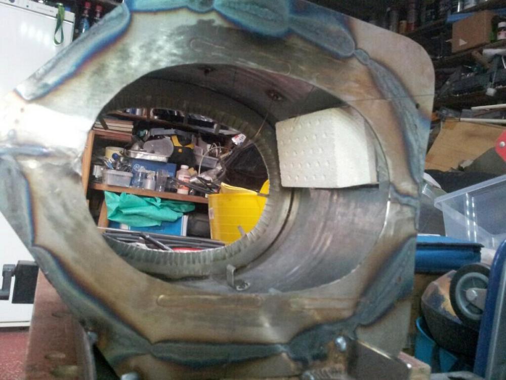

tinkertim Posted May 2, 2019 Share Posted May 2, 2019 DIY forge / NARB update. Initial Forge Shell 1 Initial Forge Shell 2 Spraying rigidiser 1 Spraying rigidiser 2 Second layer rigidised Initial NARB lit to cure Colloidial Silica slurry / Zircopax Hotface. Curing Hotface 2 Curing Hotface 3 Curing Hotface 4 Dan's (@D.Rotblatts) Colloidial Silica slurry / Zircopax mix seems to work very well as the Hotface coating. I've probably mixed too thick a solution of the coating initially, but the Ceramic Wool, the NARB flame face and the Insulating Fire Brick (IFB) took the Hotface coating well, in fact the IFB & NARB have a near-glazed appearance. I will be adding some extra layers with some glass bubbles in it at the weekend, as well as a few tweaks to prevent flame leaks around the ends of the IFB. I will also be making a raised floor to reduce the working volume for smaller jobs. Very pleased with it so far. Tink! Quote Link to comment Share on other sites More sharing options...
