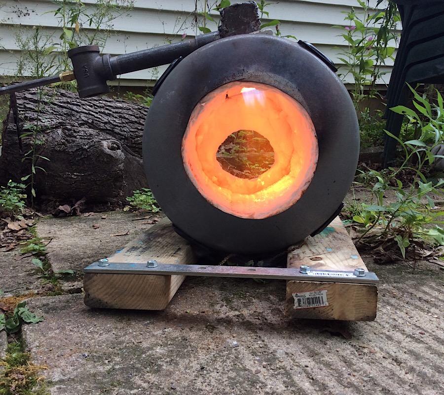

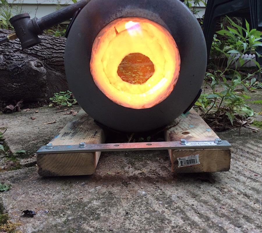

Lou L Posted September 25, 2018 Share Posted September 25, 2018 Okay, I am a good way i to my forge and ribbon burner and wanted some feed back. So far I built the burner and, when outside of the forge it has the blue jets, a large blue secondary flame but with orange red flames kicking about here and there. I’ve read that this is commonly caused by the kastolite. I also determined that some crayon particles were still wedged in the jets and, after cleaning them, I got a cleaner flame. I completely failed to take a picture of the burner outsid of the forge....no idea why. But the forge has since been built and I took it outside to finish the rigidizing process. The flame seems good but it certainly turns into an orange read swirl in the forge. I would appreciate any input on the forge, the flame and particularly on the process of lining it with kastolite. I intend to use metal flashing to make forms for the inside of the forge so I can apply the kastolite in one session. Is this madness? This is at 10 PSI....the next is at 6 PSI. Quote Link to comment Share on other sites More sharing options...
Frosty Posted September 25, 2018 Author Share Posted September 25, 2018 Looking GOOD Lou! Yeah, Kastolite has a calcite binder and it makes a bright orange flame that isn't really dragon's breath. When you're curing off the rigidizer the yellow orange you see is sodium flare (I THINK) from the fumed silica. Uncoated Kaowool doesn't make the yellow orange flames, I had to give it a try to see so I tossed a small scrap in. I don't think I ran a ribbon outside a forge long enough to even warm it up so I can't say much there. I wouldn't worry about different outlets having flames a little different than others, these are home built. A little yellow or maybe interesting color flickers is no big thing. All the crayon and such won't be cleaned out till you get it good and hot anyway and a little paraffin in the fire will make it really rich. Yellow flame rich, till it's gone. Linoleum makes a good mold for refractories. Roll and tape it to shape, when the refractory's set untape it and peal it out. The only thing mad about you is trying some of this whacky stuff we dream up. Frosty The Lucky. Quote Link to comment Share on other sites More sharing options...

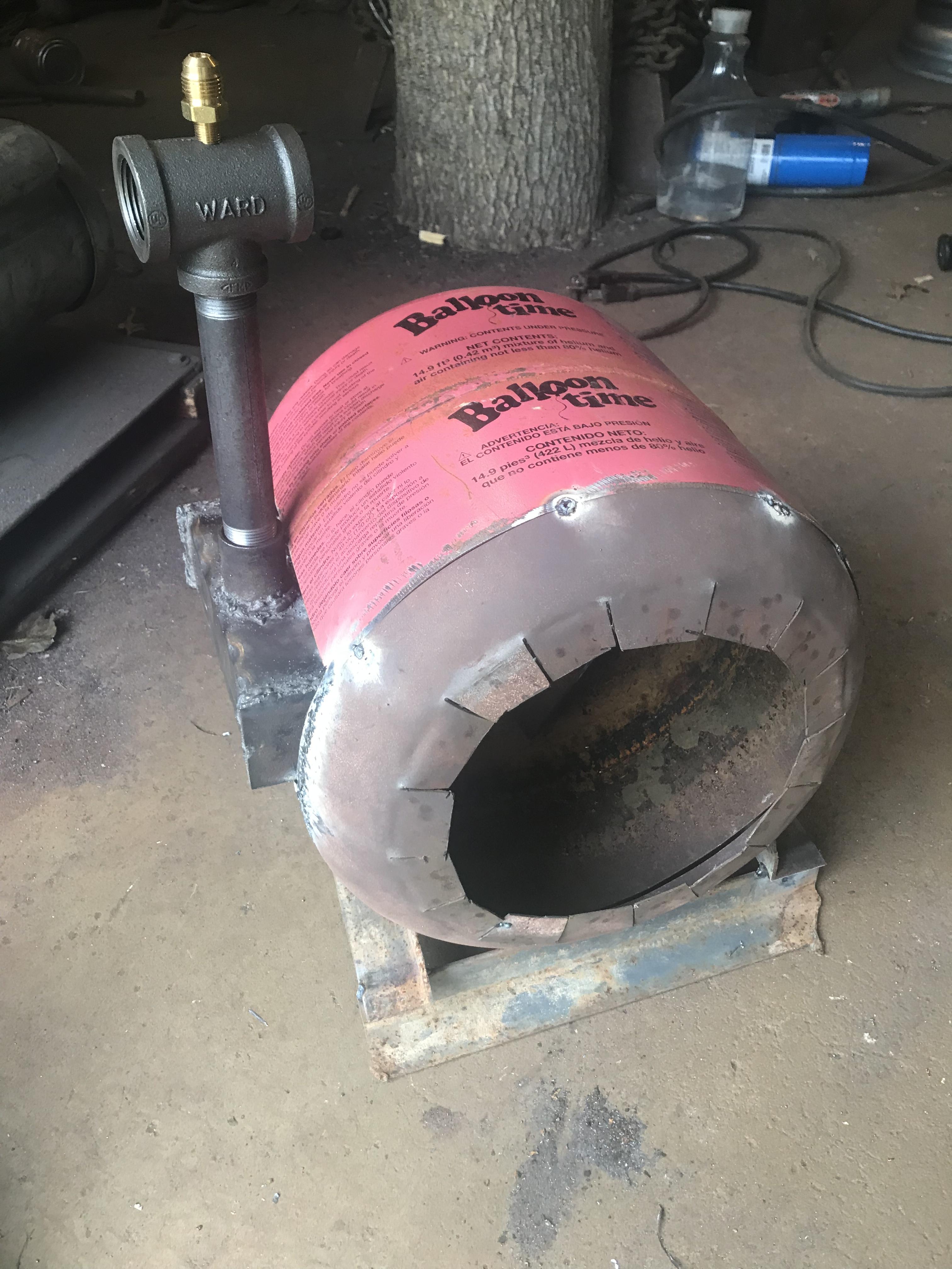

JHCC Posted October 17, 2018 Share Posted October 17, 2018 A question about alignment of the burner tube relative to the forge: most of the pictures shown here have the tube running horizontally or a bit below, with the burner blowing either straight down or a little off TDC. I'm planning to set the block of my NARB so that the flames enter the forge horizontally and roughly tangential to the interior of the shell. This would mean that the burner tube will be vertical, as in this photo of my setup awaiting refractory: My question is this: should I leave the burner in this alignment, with the tube rising UP from the plenum, or can I have it pointing DOWN? If the latter is okay, the air inlet will be below the opening of the forge (possibly even below the level of the top of the stand), thus reducing the chimney effect and distancing the air intake from the heated forge exhaust. Additionally, the gas supply line would be both farther from the heat and not sticking out in the middle of my (rather small) shop. Any thoughts? Quote Link to comment Share on other sites More sharing options...
Buzzkill Posted October 17, 2018 Share Posted October 17, 2018 For burner placement and orientation I like Daguy's setup. It has great distance between the burner block and the opposite wall, it induces significant swirl, and it doesn't take away much, if any, of your floor space. https://www.iforgeiron.com/topic/60067-it’s-finally-burning-a-first-build-story-photo-heavy/ As far as the tube orientation, IMO extending down is better for the reasons you gave. I've only used horizontal, or nearly so, tube orientations, but I can think of no reason your idea wouldn't work as well or better than other options. Quote Link to comment Share on other sites More sharing options...
JHCC Posted October 17, 2018 Share Posted October 17, 2018 16 minutes ago, Buzzkill said: For burner placement and orientation I like Daguy's setup. That's the basic idea, but rotated clockwise about 30°. 17 minutes ago, Buzzkill said: I can think of no reason your idea wouldn't work as well or better than other options. Good; I shall plan on that, then. Quote Link to comment Share on other sites More sharing options...
Buzzkill Posted October 17, 2018 Share Posted October 17, 2018 The only difference I can see in rotating it 30 degrees is secondary combustion may not be complete before impinging on your stock. If you look at the video of his swirl the visible flame diminishes to almost nothing about the spot where your stock would rest on the floor. I don't see this as a major concern, and it may even be a moot point once the forge is up to temperature, but it is a slight difference. Quote Link to comment Share on other sites More sharing options...
Frosty Posted October 17, 2018 Author Share Posted October 17, 2018 That should work fine John though I haven't experimented with that orientation in a forge. Even with the tube vertical up I haven't noticed much chimney effect. I don't think it can draw well through all the outlets as opposed to one large diameter one. Frosty The Lucky. Quote Link to comment Share on other sites More sharing options...

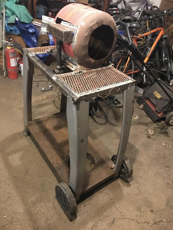

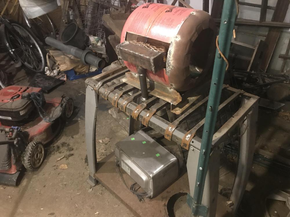

JHCC Posted October 18, 2018 Share Posted October 18, 2018 The plan is to mount it on top of this old gas grill base, which is currently the support for my forge’s removable flue and previously was my hammer rack. Still figuring out how to make that happen. Nice that it already has a spot for the propane tank, though. Quote Link to comment Share on other sites More sharing options...
Daguy Posted October 19, 2018 Share Posted October 19, 2018 17 hours ago, JHCC said: The plan is to mount it on top of this old gas grill base, which is currently the support for my forge’s removable flue and previously was my hammer rack. Still figuring out how to make that happen. I LIKE! Quote Link to comment Share on other sites More sharing options...
JHCC Posted October 20, 2018 Share Posted October 20, 2018 And here we are: (Awaiting refractory.) Quote Link to comment Share on other sites More sharing options...
Daguy Posted October 20, 2018 Share Posted October 20, 2018 Looking good. Quote Link to comment Share on other sites More sharing options...
Frosty Posted October 22, 2018 Author Share Posted October 22, 2018 Looking pretty good John. I like how you T is positioned it keeps the hose out of the way. What color are you going to paint it? Frosty The Lucky. Quote Link to comment Share on other sites More sharing options...
