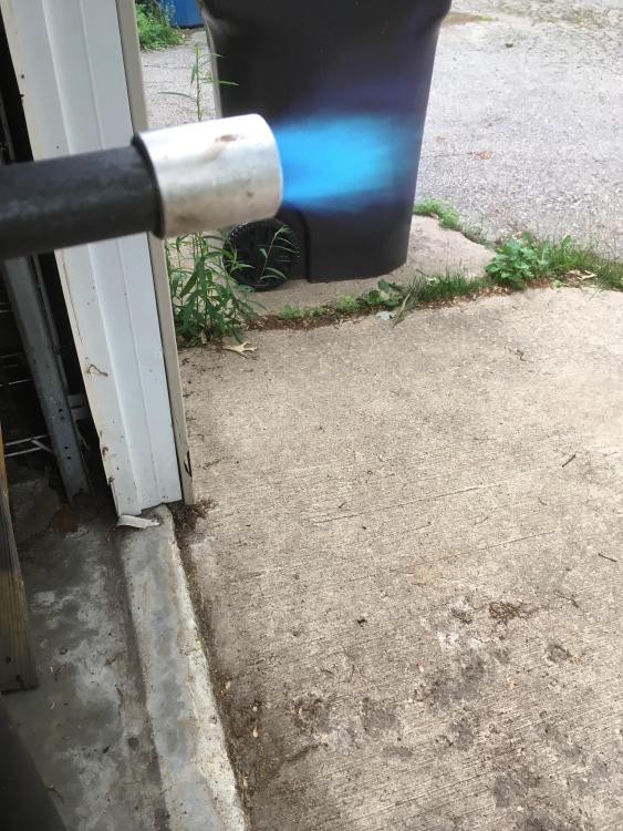

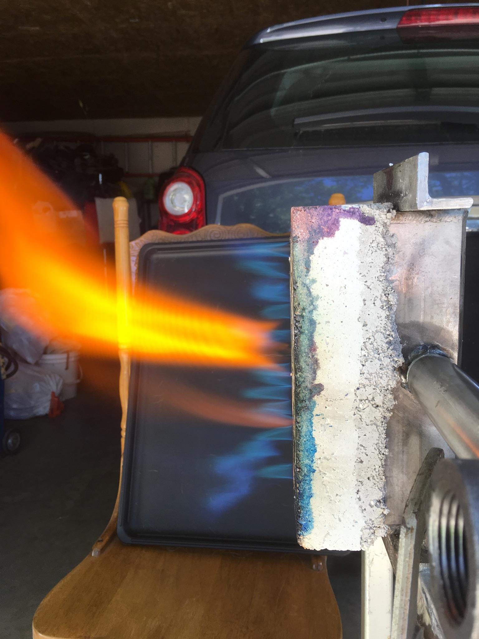

Well my crayon project is going mostly well.  I have some VERY positive things to report, but I'll probably be recasting.
I used a 2 X 2 stainless square tube for the Ribbon burner with dimensions per Frosty's OP.  After casting, I found that the refractory rattled a bit on the mix chamber, and leaked.  The leak could no doubt be fixed with high temp caulk available online, but I'd rather have a tight fit, so I think I'll bust off the casting, weld on some expanded metal to reach deeeper in to the casting, and recast.  Also, I made the mistake of trying to drill out the crayons after only letting it cure for 24 hours, with the result that I broke one corner off halfway up the port.  IMPORTANT WARNING:  if you're making a ribbon burner, melt out the crayons, don't drill them.
I cast with 20 holes, 3 rows of 7, 6, 7 with the port pattern  7" X  1-3/4".  I tuned the tee burner before I had anything else made, with no back pressure of any kind (Just a thread protector in open air) and was wondering if I needed to go to school or something.  I could hardly get it to stay lit.  I got it to run as smooth as posssible that way, and when I finally threaded onto the ribbon burner, OMG!  As long as I let it run long enough to heat up the face of the RB, It ran strong from 1 to 22 PSI. Now I can build the forge and have the burner for curing the layers.  I'm pretty excited to see how it turns out.
Kudos to Frosty for all his work on they NARB and thanks.
Photos:
The flame photos are at 1, 10, and 22 PSI, with the orange flames from residual wax and paper burnouts.  When it's in the forge and has some back pressure, it should reach forging temps easily.

Round one of testing is complete. I ran the forge at 5psi for 2 minutes and was at 1500f (I think it was mostly just direct flame heating, the forge wasnt really hot yet). I then cranked it up to 10psi and hit 1750f at 5 minutes, 1900f at 8 minutes, 2000 at 9 minutes, and 2040 at 10 minutes. I stopped making notes at that point because it basically plateaued between 9 and 10 minutes. I didn't go up higher than 10psi because I didn't want to burn the thermocouple before I got a chance to test the Matrikote. 2040f is dang near welding temp anyway, I'm stoked that it does that at only 10psi. I also put in a 2"x1.5"x1.5" block of cold rolled to see how long it would take to come up to temp. It's a little subjective, but I'd say it was up to a nice yellow heat by 3:30. I would also note that after 20 minutes at 10psi, I turned it down to 5psi and did a little forging. It started "woofing" after about 10 minutes at 5psi. Turned it back up to 10psi and it was fine. I'm going to paint the flame face of the burner with the matrikote and see if it makes any difference there as well.
I'll paint the forge interior with Matrikote tomorrow morning and then hopefully do the "after" testing on Saturday sometime. Maybe I should make a new thread with the complete results? I don't want to clutter up this thread too badly.
Daguy: I'd read about the casting breaking free from the plenum and they were opening a side the way you did. That's why I sliced the side completely off. It makes intuitive sense that the 90* angle at the opening would grab the refractory better but it makes a weak point in concrete construction. So I played it safe and cut one whole side off so it contacted the refractory like a blade. The expanded gave it tooth at angles other than 90.
If you guy's burners work like mine do 5 psi might not supply enough fuel air through the burner block to keep it cool enough to prevent it burning back. I believe when you turned your hot burner back down and it started woofing after a while is an expression of inadequate cooling flow.
