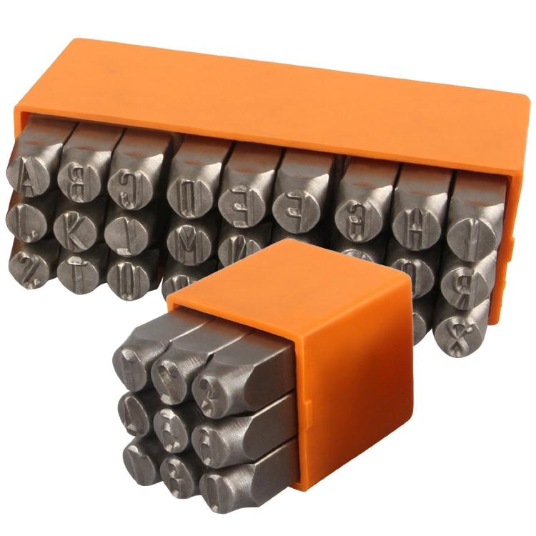

blackleafforge Posted September 3, 2016 Share Posted September 3, 2016 Hi, I bought a set of punches with letters on them for writing customers names on items I'm making. I am however having real problems keeping them all straight and my efforts often look very amateurish and spoil the work. Am I missing something? Is there a method or tool that would do a better job? Also what temperature would you punch at? I didn't want to ruin the crisp edges of the letters so I have been doing it at just under a dull orange, is that correct? thanks Quote Link to comment Share on other sites More sharing options...
John McPherson Posted September 3, 2016 Share Posted September 3, 2016 Unless they are specialty stamps ($$$$) made from heat resistant steel such as H13, they are made to be used on cold metal. Even quenching after every strike, they are probably going to lead a shortened life. Short stamps in a plastic box = cold work only. Hot work stamps would be longer, or come with a punch holder to keep from burning your hands. And would come in a fitted wooden or steel case. How did you learn to write when you were young? On a blank sheet of paper, or one with lines? Make a line on your work with a silver pencil or thin sharpie, scratches with a scribe being harder to fix or hide later. Lay out your work on a solid surface with no flex, such as the center of your anvil, or directly over the leg of a sturdy table. Using an old glove or other leather scrap as a cradle helps keep it from shifting, especially if it is not perfectly flat. Eyeball each punch as you put it in position for alignment with the baseline, and for squareness. (Did I forget to mention to mark each punch with which way is up? Of course, *I* have never done something silly, like punch a letter upside down or sideways.) Quote Link to comment Share on other sites More sharing options...

gote Posted September 3, 2016 Share Posted September 3, 2016 Since they are intended for cold use, the problem is slight. use suitable clamps to fix some kind of straight edge to support them vertically. Make some kind of lines on the straight edge to align them horizontally Quote Link to comment Share on other sites More sharing options...
yves Posted September 3, 2016 Share Posted September 3, 2016 Horizontal alignment : it cannot be systematic (i.e. one width) as letters do not have the same width ("I" "W"). Quote Link to comment Share on other sites More sharing options...
Al Stephens Posted September 3, 2016 Share Posted September 3, 2016 When stamping several names, words, in a given space I also "lay out" from the center letter or space. It has helped me from running out of room, with 2 letters to go! Quote Link to comment Share on other sites More sharing options...
Randy Bill Posted September 3, 2016 Share Posted September 3, 2016 I have seen the edge of masking tape applied to the work used as a guide. Quote Link to comment Share on other sites More sharing options...

aessinus Posted September 3, 2016 Share Posted September 3, 2016 Both of my sets have a ground notch to denote bottom (except 6/9) Quote Link to comment Share on other sites More sharing options...
SmoothBore Posted September 4, 2016 Share Posted September 4, 2016 On 9/3/2016 at 9:56 AM, aessinus said: Both of my sets have a ground notch to denote bottom (except 6/9) As do mine. And obviously, it's a simple thing to "nick" each die, in the same fashion. I use a magnet to hold letter stamps straight and square on a work piece. --------------------------------------------------------------- In the days when printing was done with hand-set individual "type", the type had a "nick" ( or 2 ) cast into the body of the type. The nick was located at a slightly different point on the body of each font of type, so that the "Compositor" could easily spot any irregularities in an assembled "line" of type. For a number of reasons, the individual type characters were assembled in a "Composing Stick". A GOOGLE search will yield ample images of "Composing Sticks", ... that might give an idea of how you could apply this simple technology to your problem. Quote Link to comment Share on other sites More sharing options...
John McPherson Posted September 5, 2016 Share Posted September 5, 2016 If you intend to do this sort of thing a lot, a brass or lead hammer strikes with authority, without the tendency to bounce and double strike like a steel hammer. It also will not mushroom the head of the struck tool. Great for using on punches, drifts and chisels as well. Quote Link to comment Share on other sites More sharing options...

Alan Evans Posted September 6, 2016 Share Posted September 6, 2016 My punches, some second hand sets, have a line or a cross ground on one face which you can feel under your fingers to make sure they are the right way up. Two things I have done to help get the legend looking good... Clamp a guide rail of 12mm (1/2") square or similar, and rest the bottom or top edge of the punches on it to give you horizontal and rotational alignment. It helps prevent the possible flinch and movement. Grip the punch in "mole" or "vice" grips or similar snap action pliers...or some tongs with a slip ring, which enables you to see the business end of the punch clearly without it being obscured by your hand. As above, I often use a copper mallet. One good clout is better than two light ones. I would try a "dead blow" shot filled hammer if I had one. Alan Quote Link to comment Share on other sites More sharing options...

Frosty Posted September 7, 2016 Share Posted September 7, 2016 wow, I cheat I lay a piece of angle iron over the edge of a table and lay the punches on it in order and even, clamp them down with a second piece of angle iron and I have it ready to lay out on the work piece. The angle iron "holder" marks both upper and lower margins of the stamps and supports them vertically. If necessary I can clam the "holder" to the work or hold it with tongs, channel locks, etc. and hit it with the appropriate size hammer, the more punches at a time the larger the hammer and a dead blow or soft hammer works best. Practice makes all the difference, Dad could eyeball punches and I swear he could've written a novel like it was typed. Frosty The Lucky. Quote Link to comment Share on other sites More sharing options...
Black Frog Posted September 7, 2016 Share Posted September 7, 2016 Practice helps a lot. You can't simply use the stamp stock size for spacing because there's a lot more empty space on each side of an "I" character than there is on something like a "H" character. Those holders where you can put a bunch of stamps together don't look right to me. I don't mind a bit of variation and non-perfectness. The things we forge are hand made items, and I like the stamping to reflect that too, it was hand stamped. A proper stamp holder can make a world of difference in ease and accuracy of stamping. Once you use a real holder, you'll never use a pliers or vise grips again! Here's a fancy brass-handled one I made: Quote Link to comment Share on other sites More sharing options...
