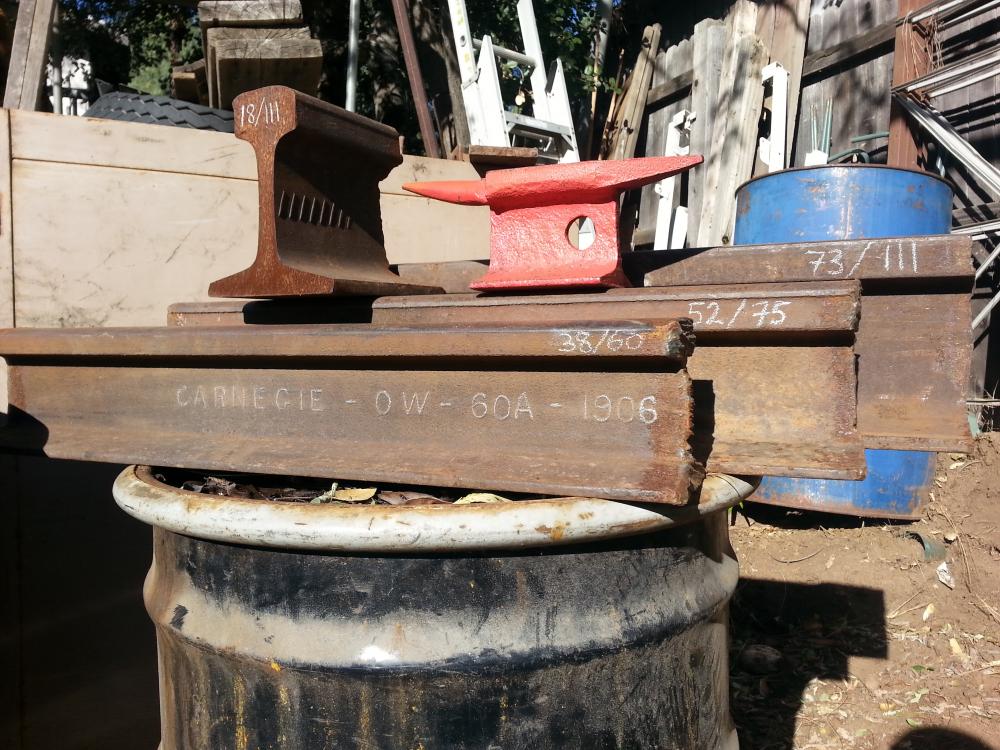

DavidTodtman Posted June 6, 2016 Share Posted June 6, 2016 On 2016-05-18 at 7:23 AM, j.morse said: I recently bought a RR tool at an estate sale. It is basically a cold cut-off hardy with a long handle. I had no idea what I had until a RR worker on another forum told me. It was used to score a line all around a rail. Then said rail was dropped on another rail right at the line scored. It would, according to the RR guy, snap the scored rail cleanly. I have not tried it. When I was young I worked on the Canadian Pacific Railway on a section gang in the Columbia River Valley in the British Columbia rockies. I saw it done that way. Actually, I do not recall the 'drop the rail thing.' I recall scoring the rail all around and then sledging the hardy hard on top of the rail to make the cut. By the way, a whole length of rail--of the older type--is 33' long. Rail was referred to by its weight; all the rail on our section was 125lb rail (125 lbs per foot). The old guys on the section gang really knew how to use jacks and lever arms to move that heavy rail around. All our work was out in the boonies and any sort of crane was absolutely unheard of. At the time I was fresh out of university and thought I knew everything. The guys on the section gang taught me I really didn't. I appreciated that. Quote Link to comment Share on other sites More sharing options...
swedefiddle Posted June 6, 2016 Share Posted June 6, 2016 Good Morning, Rail is 10 Yards long, 33 Ft. Rail is measured, by weight, per yard. 125 lbs. Rail is, 125 lbs. per Yard Yes, there are many sizes of Rail. Some say Rail is 1095, I am not sure though. Neil Quote Link to comment Share on other sites More sharing options...

Anachronist58 Posted June 6, 2016 Share Posted June 6, 2016 (edited) Yep pounds per yard, as verified for my own curiosity from these four "specimens" (although at times I have been accused of talking softly to them a petting them - absurd!). Robert Taylor Edited June 6, 2016 by Anachronist58 addendum, clarification Quote Link to comment Share on other sites More sharing options...
IRTim Posted June 17, 2016 Share Posted June 17, 2016 There's old rail like that all around me and I see people taking it all the time. I personally use a Milwaukee cordless bandsaw to cut all kinds of rail. I got it at Home Depot it's nothing special. If the rail is to big I dig under it or if I can I put a car jack under it and block it up. With old rail like that it's much easier to cut. In fact they cut it on spot with no tools a real long time ago. This is how they did it.. Take a cold chisel and mark a clean line around the track. Then take a good size sledge hammer and hit your mark. That's it, it will snap and much easier than you'd ever think! Back in the day they'd mark the rail with a chisel and drop it onto another piece of track and the rail would snap clean. That's how it was done with old track. They didn't have power tools out there on site back then. All you have to do is mark and snap it. New track you can't do that. New track is steel old track is iron. Steel track will not snap! I'm in Pa and there's tons of old Pa RR track around and that's even today how they remove it. So just snap it if you don't have a cordless bandsaw. People think way to much into cutting rail and it's really not that hard. Quote Link to comment Share on other sites More sharing options...
