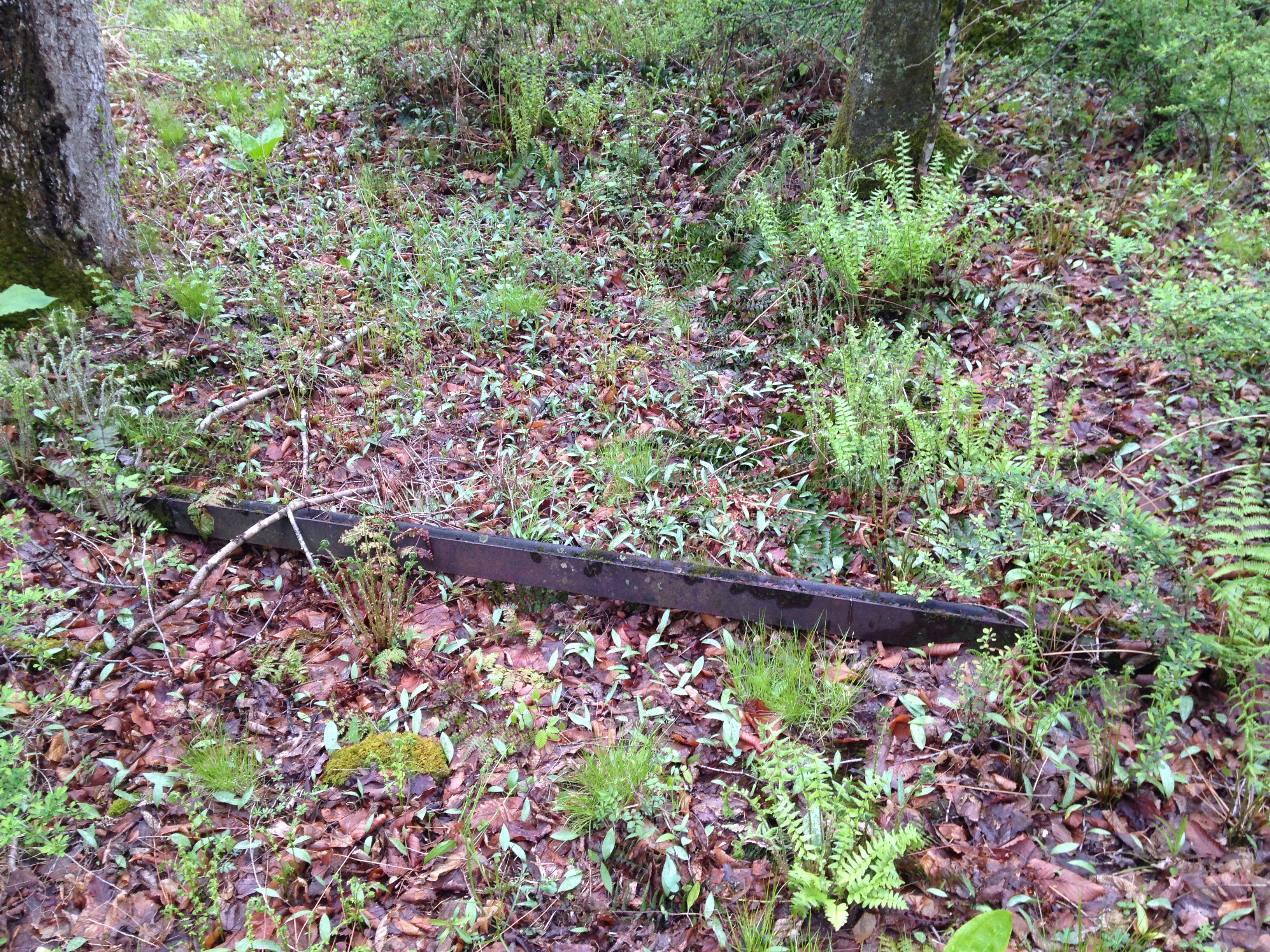

MrDarkNebulah Posted May 20, 2016 Author Share Posted May 20, 2016 Guys I am no where near good at blacksmithing to be considering a profit margin. This is mainly just I want to take it out because Im curious. You all bring up some very good points. Ill have to think about what Im going to do. Here is a picture of it. Some of it is cut off by the picture. It ends in the ground burred on both sides. Quote Link to comment Share on other sites More sharing options...
Charles R. Stevens Posted May 20, 2016 Share Posted May 20, 2016 If it's wraught it will cut with a hacksaw pretty easy, a picture of any writing on the sides would be good. It would allow us to ID it. Quote Link to comment Share on other sites More sharing options...
olfart Posted May 20, 2016 Share Posted May 20, 2016 That doesn't look like any railroad track I ever saw. No flange on the bottom, just what appears to be a rectangular cross-section. No spikes, no ties, no ballast. Could there have been a mine nearby that could have used that type tracks for the ore cars? Quote Link to comment Share on other sites More sharing options...
DSW Posted May 20, 2016 Share Posted May 20, 2016 2 minutes ago, olfart said: That doesn't look like any railroad track I ever saw. No flange on the bottom, just what appears to be a rectangular cross-section. No spikes, no ties, no ballast. Could there have been a mine nearby that could have used that type tracks for the ore cars? I don't think you are looking at it correctly. The rail is laying over on it's side. What I see is that the bottom flange is facing us in that pict and you can just see the underside of the top of the rail above it. Quote Link to comment Share on other sites More sharing options...
olfart Posted May 20, 2016 Share Posted May 20, 2016 1 minute ago, DSW said: I don't think you are looking at it correctly. The rail is laying over on it's side. What I see is that the bottom flange is facing us in that pict and you can just see the underside of the top of the rail above it. You may be right. I could be suffering from an optical delusion. I was expecting to see a rail in its normal configuration spiked down. Quote Link to comment Share on other sites More sharing options...
SmoothBore Posted May 20, 2016 Share Posted May 20, 2016 I think the tool you need, ... Is a shovel. And then, depending on the length of the rail, ... a tractor. Quote Link to comment Share on other sites More sharing options...
ThomasPowers Posted May 20, 2016 Share Posted May 20, 2016 Naw just a lot of friends with ropes and beer... Quote Link to comment Share on other sites More sharing options...
Anachronist58 Posted May 20, 2016 Share Posted May 20, 2016 A minimum six foot pry bar (or an eight foot 4 x 4) and some blocks - looks like it just might pop right out of the mulch. Quote Link to comment Share on other sites More sharing options...
Charles R. Stevens Posted May 20, 2016 Share Posted May 20, 2016 Oh, I'm hard headed, if I can't get a horse in there, I will find a way to drag it out, even if it's rails and rollers... gas and iduction forges not withstanding, blacksmithing is low tech, lol. Quote Link to comment Share on other sites More sharing options...
