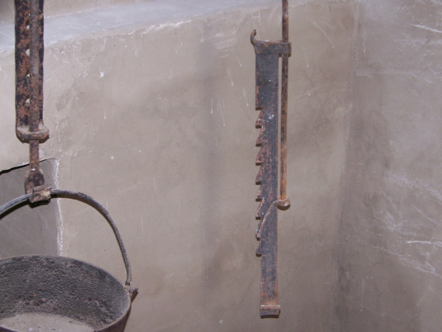

John B Posted May 16, 2016 Share Posted May 16, 2016 What springs to mind to hold hangers is similar to the traditional trammel hooks with ratchet like teeth on, instead of the punched hole type, (which would make manouvering your clothes hangers into position somewhat difficult) Quote Link to comment Share on other sites More sharing options...
SpankySmith Posted May 16, 2016 Author Share Posted May 16, 2016 Something like this, John? Horizontal instead of vertical obviously? Quote Link to comment Share on other sites More sharing options...
John B Posted May 16, 2016 Share Posted May 16, 2016 Yes, angled to suit for hangers to facilitate easy removal and air circulation when clothes hung on them. Quote Link to comment Share on other sites More sharing options...

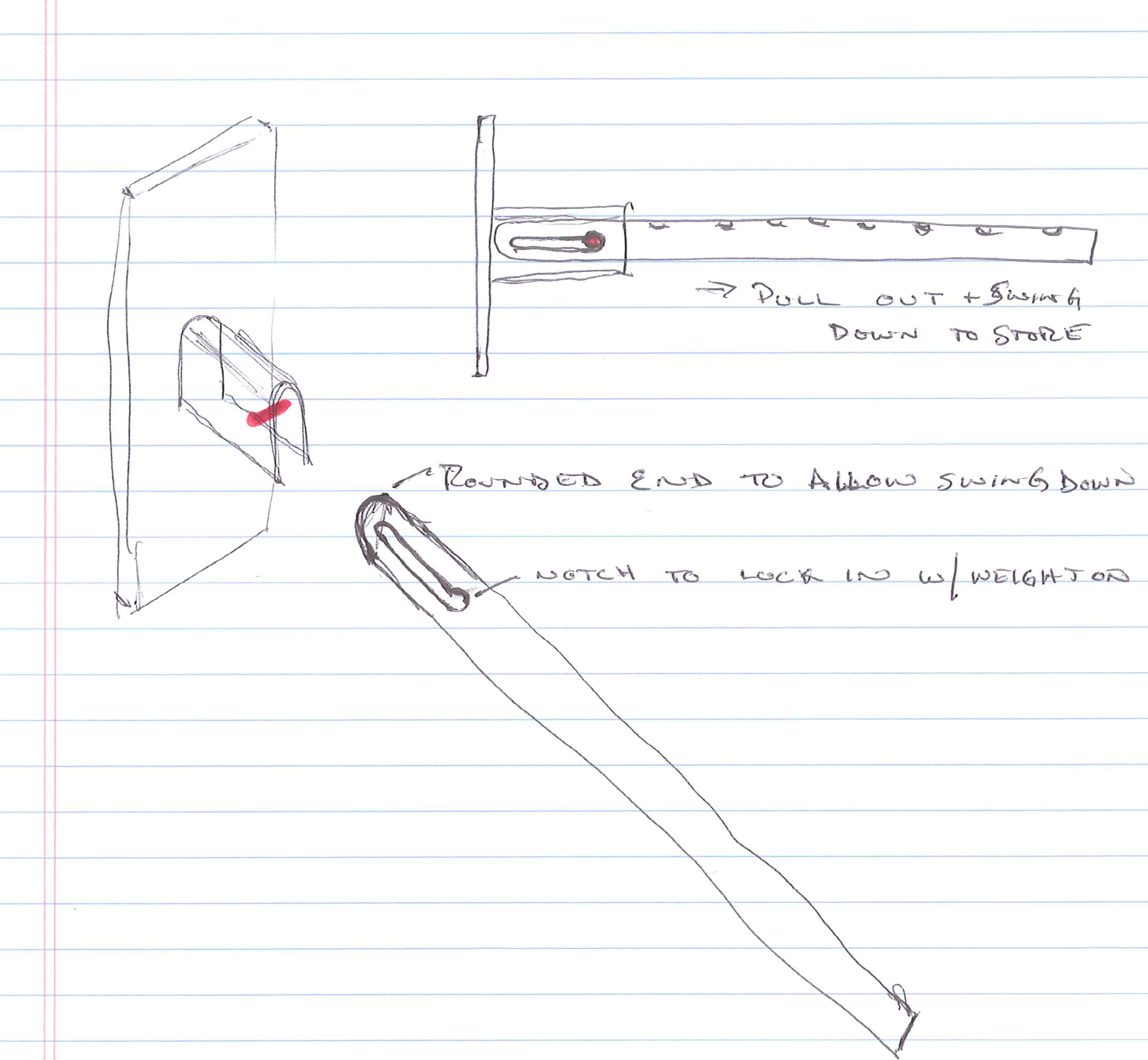

Al Stephens Posted May 17, 2016 Share Posted May 17, 2016 Simple "hinge" on the anchor end should get it out of the way. Spanky, rounded edge,end should help with impaling issue. Quote Link to comment Share on other sites More sharing options...

Culver Creek Hunt Club Posted May 17, 2016 Share Posted May 17, 2016 I did something similar for a buddy before I was doing any forging. it was fabricated and was welding lead and extension cord storage but would work as I sketched for a valet hook. Scaled and detailed as you see fit. Quote Link to comment Share on other sites More sharing options...
SpankySmith Posted May 17, 2016 Author Share Posted May 17, 2016 Culver, I LOVE you! Thanks, i was having a hard time "seeing" the mechanics of that type of hinge/folding mechanism. You ROCK!! Quote Link to comment Share on other sites More sharing options...
