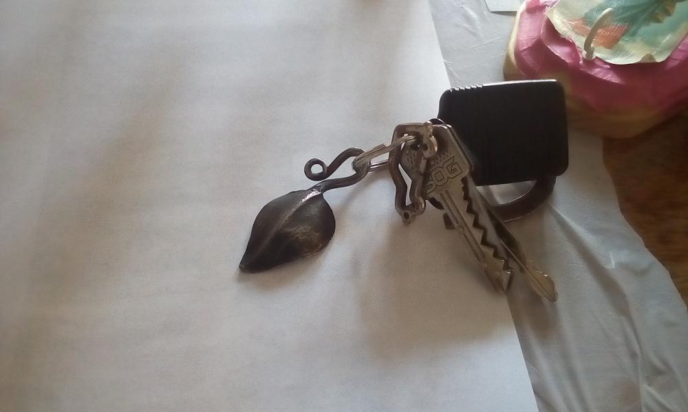

starts out as 1/2" H.R. round......ending up as 2" long x 1-3/4" wide Aspen leaf.....quantity, unknown, not for sale, just trying to make leaves as clean and unique as possible, not just hammered and veined with a chisel. The past few that i have done are "slightly" raised, more tapered from thick centers to thin edges. I would like assistance with giving the leaf a bit more character with an accented raised center vein. I have a 25lb Little Giant but only drawing die, few chisels and a few hammers. Here are the last ones i did, i would like a raised center vein for more "ommph".....after the 5th one coming out non picture worthy, i chimed in here.

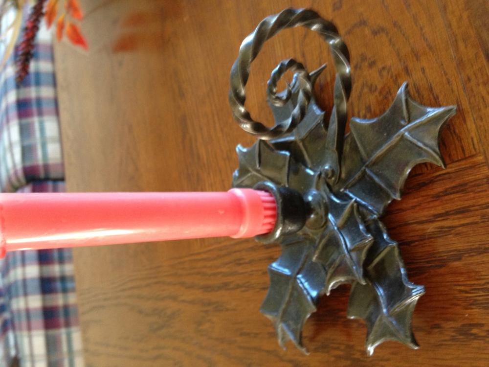

That top example was from Poor Boy Tools, and the lines were just a suggestion drawn with a Sharpie. The bottom was a rough commercial casting available from a blacksmith supply catalog. I tend to think of all kinds of tools as a kit, to be modified to suit the owner's needs.
