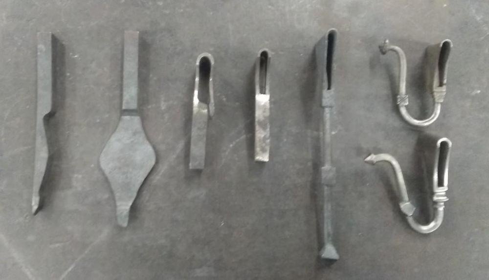

  3. Thanks Frosty, I needed to hear it that way. BillyO and everbody here on IFI, I apologize to all for letting my hackles stand up. The two lower ones are 'traditional' wrapped hawks with a high carbon bit forge-welded in. the two upper ones are actually small belt hand-axes forged like the one done by Gerald Boggs. They were made from, as Terry Sheridan put it, "wrought iron anchor chain from a shipwreck from 1810", again folded over with a high-carbon bit.

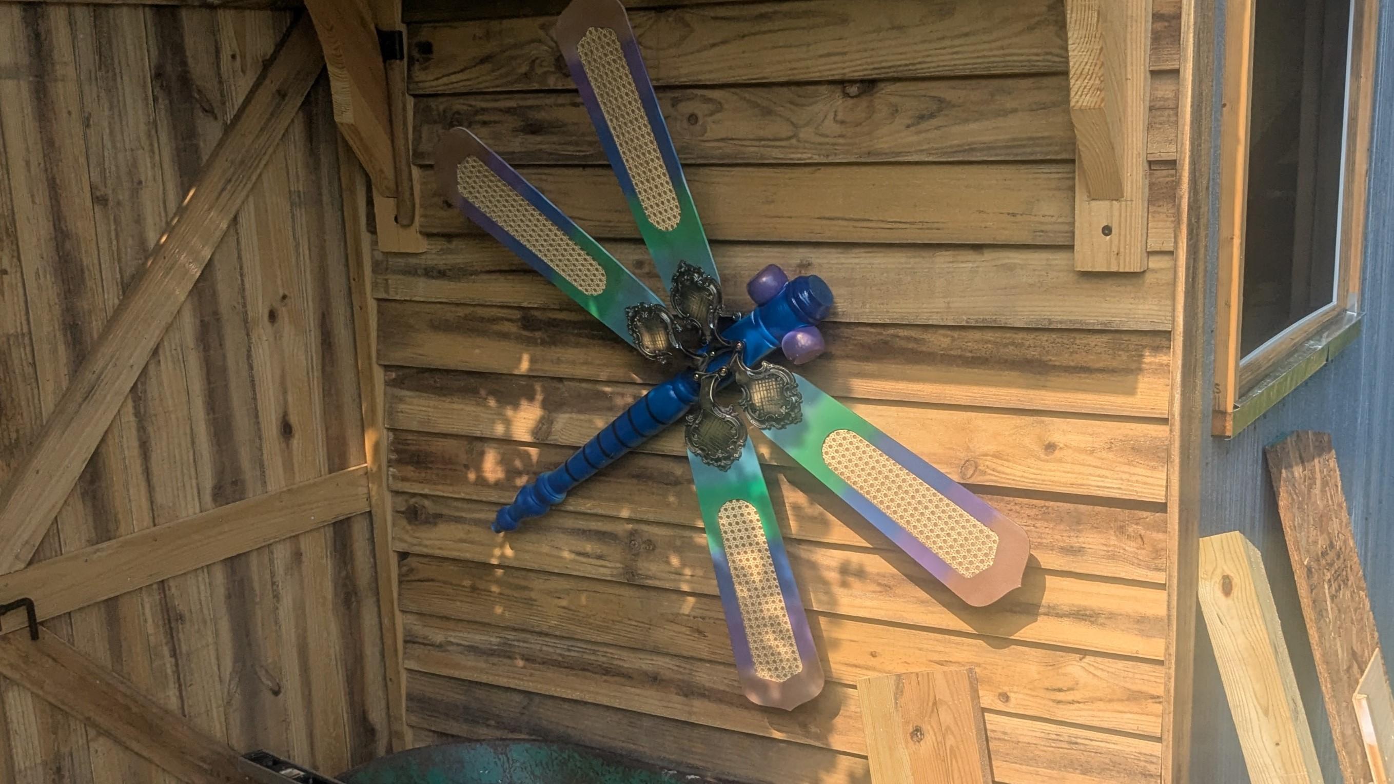

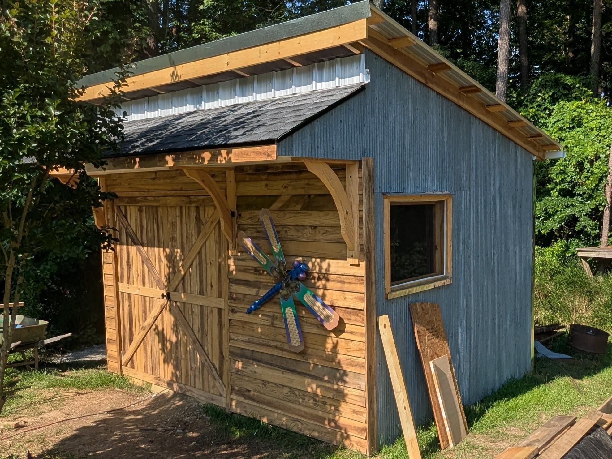

  7. Frosty, The strange art is a dragonfly fashioned from an old newel post, a couple of ceiling fan blades and some random pieces of wood. I made the dragonfly for my wife (a favorite of hers) and she said it was too big for inside the house. I had a large blank space on the front of the shop, so there it went. Here in east central NC, snowshoes are things magazines

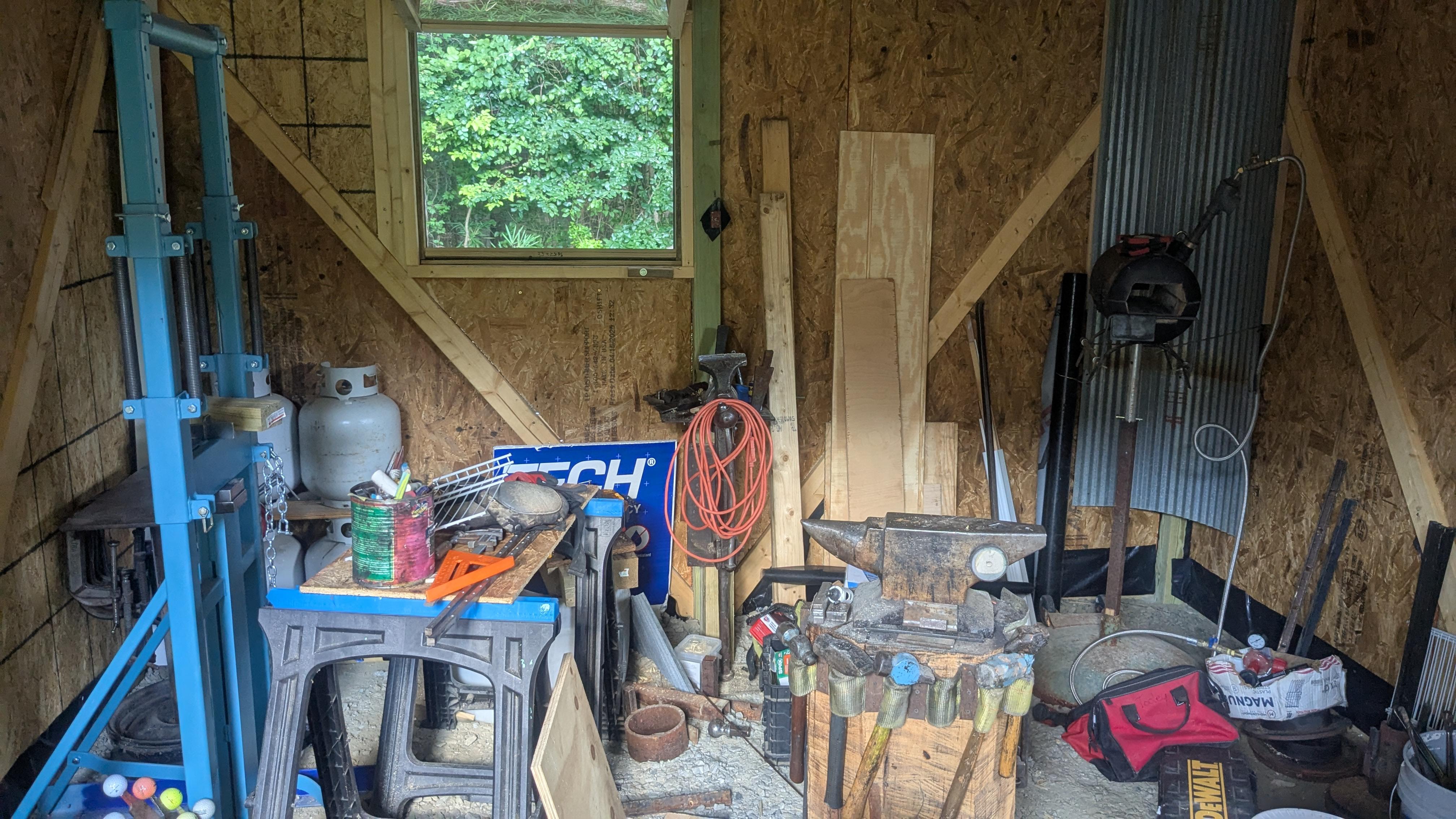

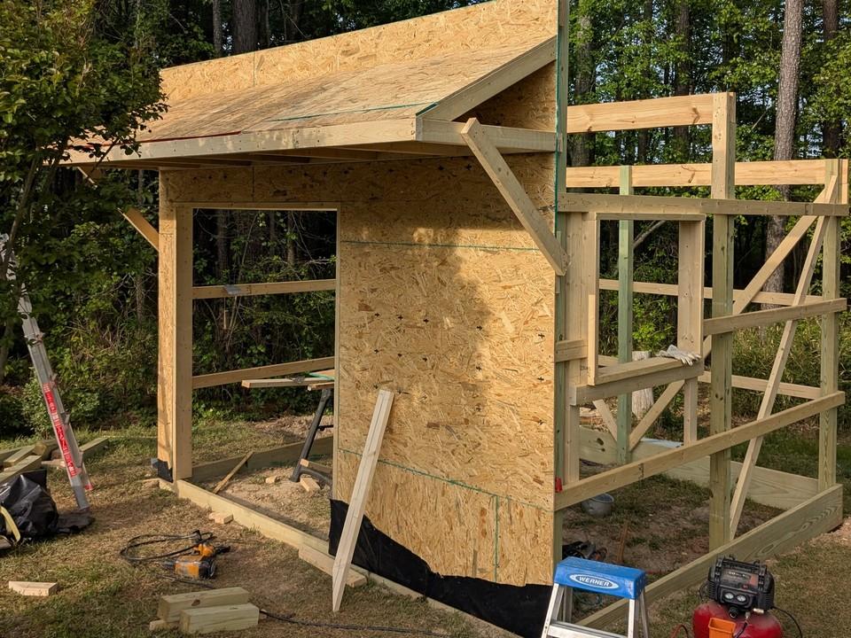

  9. Finally managed to cobble together a "dedicated" shed/shop for my hobby. it is a 12x12 shed-roof design, post and beam affair. The town inspector said that he thought it was "a little overbuilt", but that is my style. No power yet, but that is in the works. The inside is functional but crowded, mostly because I have been slowly trying to move everything out of the garage where I used to work. The walls have 1" or foam insulation covered in aluminized bubble-wrap. The interior is clad in 1/2 OSB. The ceiling is covered with the same bubble-wrap under metal roofing. Full soffit venting at front and rear with two large screened windows (we have mosquitos here).

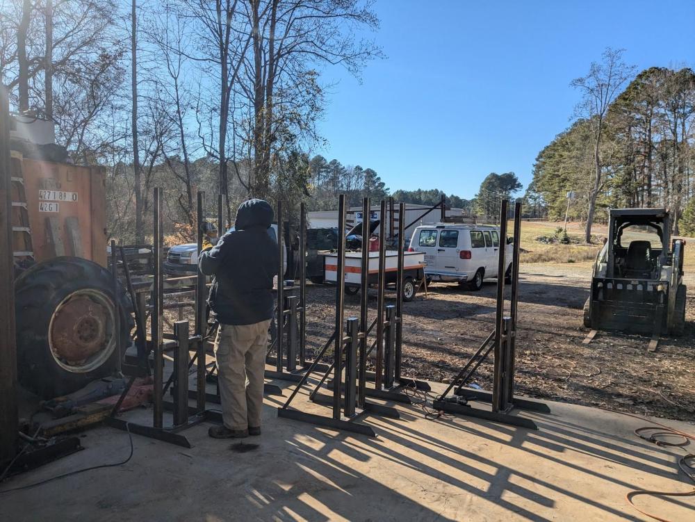

  10. A group of us here in NC just finished a "build" of a dozen of these. The head weight is something between 50 and 60 lbs. There is no 'mechanical advantage' of any compound mechanical linkages, but there is very little friction anywhere but the treadle pivots and the springs supporting the head. Noise is a relatively mild chain rattle. The inertia of a 60-lb head (which has up to 10-inches of vertical adjustment) helps with the chisel and punch work it is kind of intended for, I think. Not so much for forging candle sticks out of 3" round bar. I will try and get some pictures up in the near future. The total weight is something less than 350 lbs, so relocation is not as laborious. Also, the total size is like 20"x32" by 6' high, so the footprint is relatively tiny. Also, the base is easy enough to bolt or weigh down without affecting the treadle action. When scraping enough money together to buy fuel (coal or propane, or the wood to make charcoal) is tough, the idea of spending a couple of grand turns into 'life-time bucket list' material. Not including my volunteered labor, we were able to get these built for below $500. I will be trying it out on punching hammer eyes in the near (hopefully) future, and will let you know how it goes.

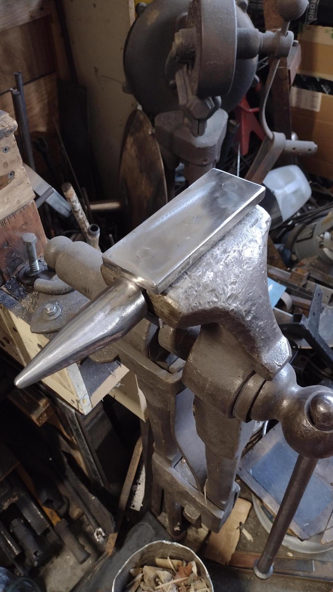

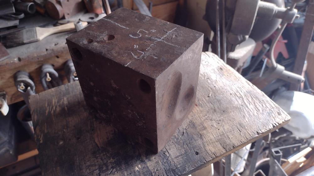

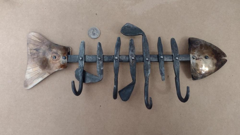

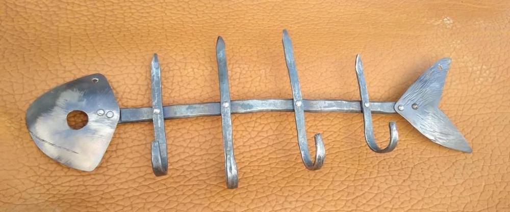

  14. Play on a fishing theme. The simple one was my first. The less simple was next, then, and then. The skeletons are mild scrap and the heads n tails are sheet stainless (scrap, again)

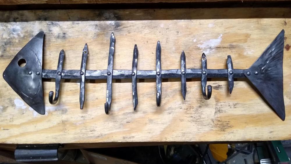

  15. I fabbed a quick stand from a bunch of 4x6 wood scrap. My youngest is modeling for me the stand survived a long day of beating by a bunch of 10-13 year-olds TommyVee, I sorta envy your cone mandrel. that is one thing I have a shortage of - cones of any sort
