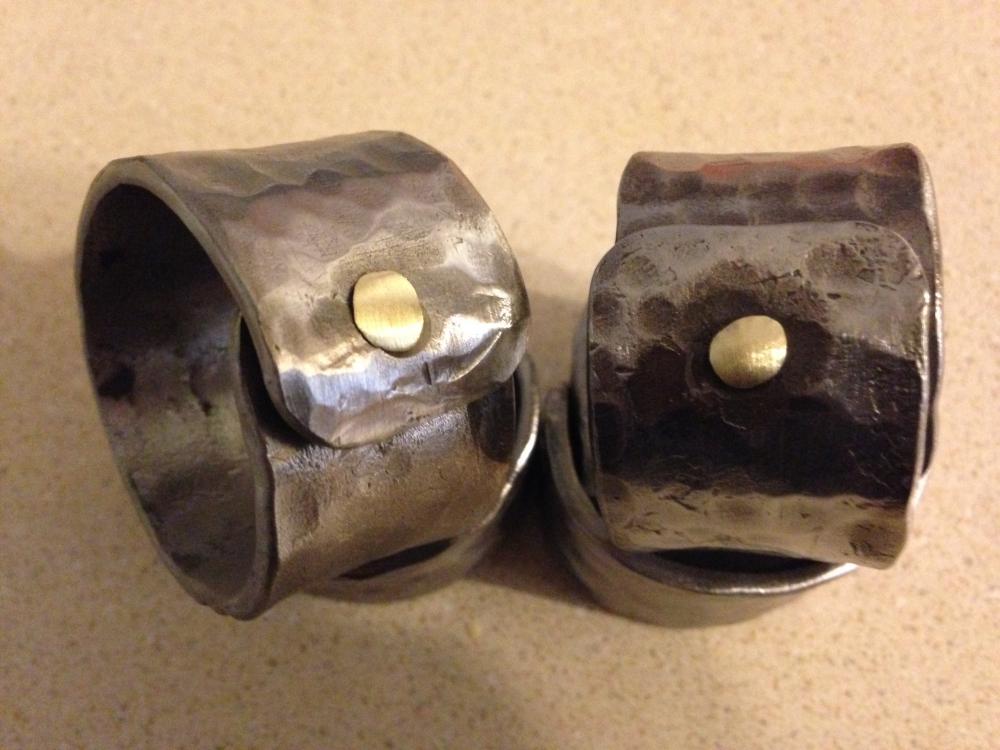

SpankySmith Posted October 31, 2015 Share Posted October 31, 2015 I second the Fredrichs Cross idea. I'm a few days away from a craft show, made a couple dozen very simple napkin rings that got some pre-show "oohs" from some friends...that seems like a good waitress related item? I'll try to scare up a photo to attach, pretty basic hammered with a brass rivet. Quote Link to comment Share on other sites More sharing options...

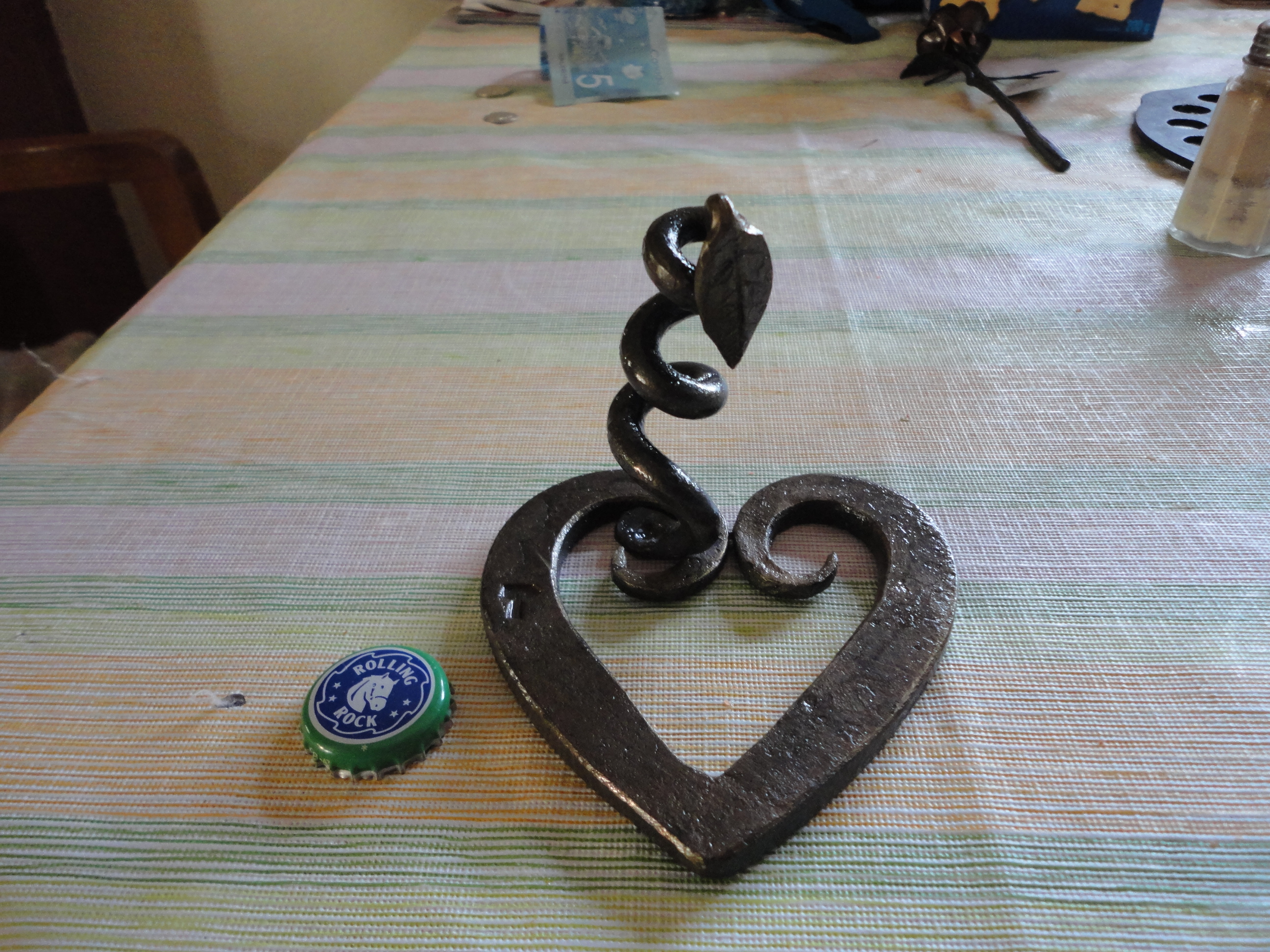

Dogsoldat Posted November 1, 2015 Share Posted November 1, 2015 Not sure whether it was on here or another place that had tiny roses made out of flattened heavy gauge copper wire and then coiled to make the flower. may make for fairly simple accents on a picture frame. I attached a picture of a horse shoe heart that I had made as a rose holder, but would work well for a pen holder on her desk or counter at home or work. a leaf bottle opener key fob may be nice as well my wife stole one of my nicer ones and uses it regularily in the kitchen for her canning jars. Roses aren't all that hard though break it down into lots of small steps and they just take a fair bit of time. Quote Link to comment Share on other sites More sharing options...

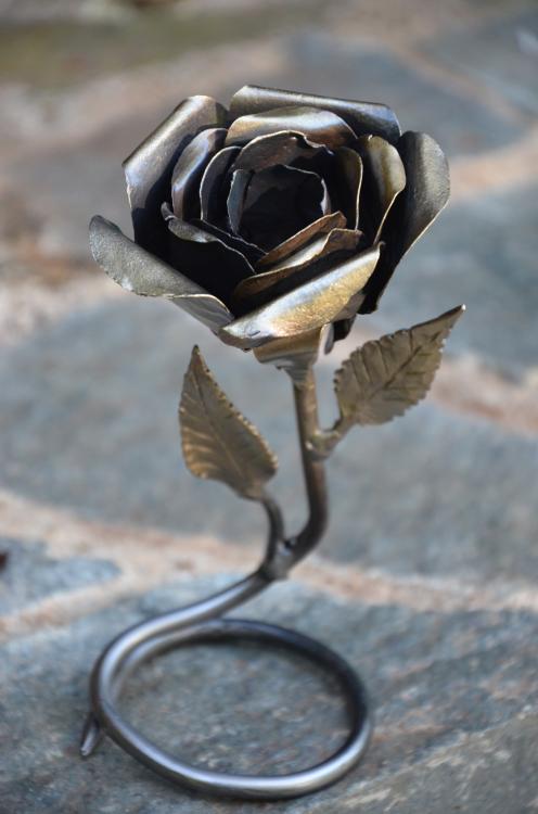

ausfire Posted November 4, 2015 Share Posted November 4, 2015 OK. here's another try. I had to uninstall Chrome and reinstall to get a reply box. What a pain. In my original reply to dps999 I was suggesting a simple rose he could make and gave him the detailed method of doing so, along with a picture. Roses might sound complicated but it's really not that hard. Don't overthink it. I'm assuming you have the basic tools required. I will try again: You need to cut three (or four if you like) circles from some light sheet metal. They don't have to be perfect circles. They should be about 100mm down to 50 mm for the smallest. Drill a 6mm hole in the centre of each one. Grab your angle grinder (or chisel in the forge if you like) and make five cuts towards the centre of each disc, leaving about 10mm before you get to the hole. (72 degree angles if you like to be precise). I use a cardboard template. Round of the angular edges of each 'petal'. Now, get a length of 6mm round bar and rough it up a bit to look like a stem. About 12mm or so down from the top weld on a slightly oversize nut (rounded) as a stop. Slip on the discs (large one first), heat and pein over the end of the stem to hold the discs firmly. Now, in the forge to red heat (don't burn the thin metal), start with the smallest disc and bend up each petal and overlap it with its neighbour. Do the same for the others. Then bend the edges of the petals outward. Another heat and pein the centre again to be sure. Forge a couple of leaves and weld them on. Forge a loop in the bottom of the stem if you want it to stand up or leave it as a long stem rose if you like. A bit of a brush with a brass brush to burnish the leaves and Voila! One happy lady. Here's a picture: (I hope!) Quote Link to comment Share on other sites More sharing options...
Michael Cochran Posted November 4, 2015 Share Posted November 4, 2015 Thanks, ausfire, that is a great explanation and picture to go along with it. I might try a few myself. One question though and please forgive me if I missed it. How do you hide the nut you put on the stem? Quote Link to comment Share on other sites More sharing options...
