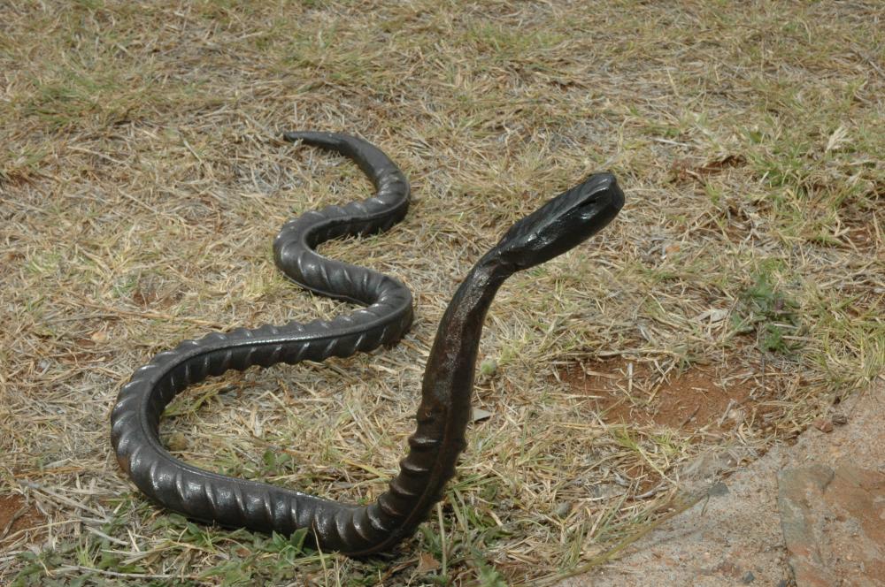

DSW Posted September 19, 2015 Share Posted September 19, 2015 Large diameter rebar also makes for some interesting items where you'd like to allow the original stock to show. I've seen some nice door handles done from 1" rebar where the hand garb section is left as knurled bar and the rest is heated and bent to form the door mounts. I've also been working on a small chunk of 1" bar to make a bottle opener out of, where the handle of the opener is the original 1" bar. Snakes are another thing that can be made of bar as the original surface texture often can be used to make scales of the snake. Keep in mind a lot of rebar is remelt scrap and it often can be made of mixed lots of steel that can be quite hard. It can harden if quenched in water and I've seen stuff suddenly snap off when being worked at low temps like when planishing near the end of a project. Link to comment Share on other sites More sharing options...

ausfire Posted September 19, 2015 Share Posted September 19, 2015 I make these out of it. 25mm rebar takes some hammering though: Link to comment Share on other sites More sharing options...
Maine hammer Posted September 19, 2015 Author Share Posted September 19, 2015 I was thinking I would make some nail hooks and such out of it the stuff made above is cool very creative. Link to comment Share on other sites More sharing options...
