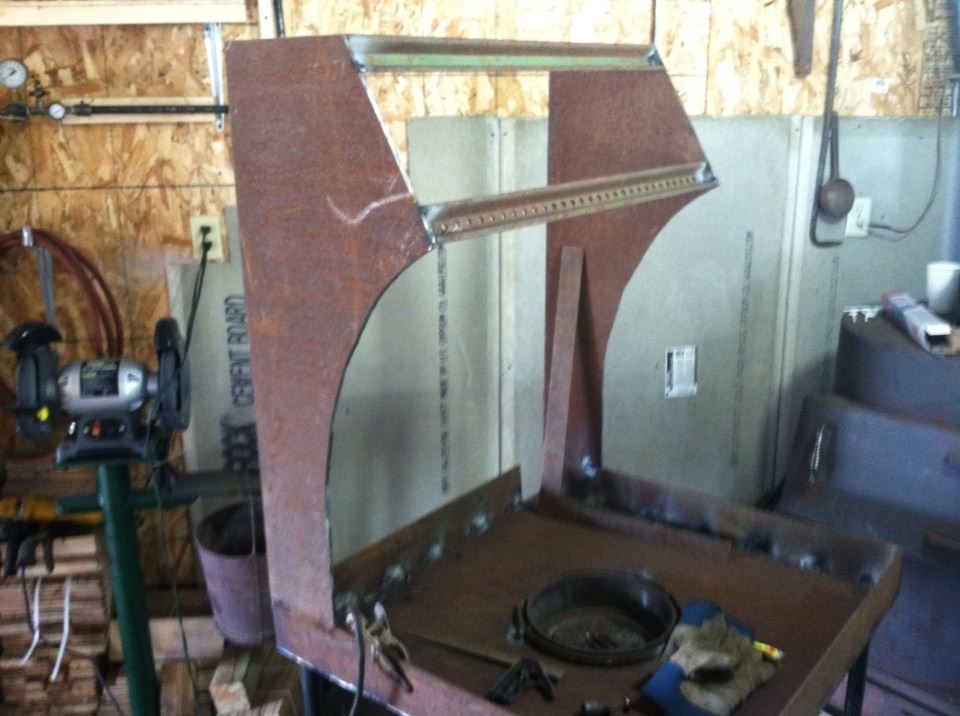

  6. Thanks guys.. I will take all into consideration. The side draft is interesting. I'm limited in chimney size for the time, I feel power drafting is a must with my small flues. I was planning on a cone vent over the whole deal, but failed to find material or a big enough cone. A shop will roll one for me if I can find some good Ga. material. I may have to break down a buy that light metal I quess, I'd like to go straight up thru the roof with 12" at some point. It is what i would prefer, and will devolop as I can.

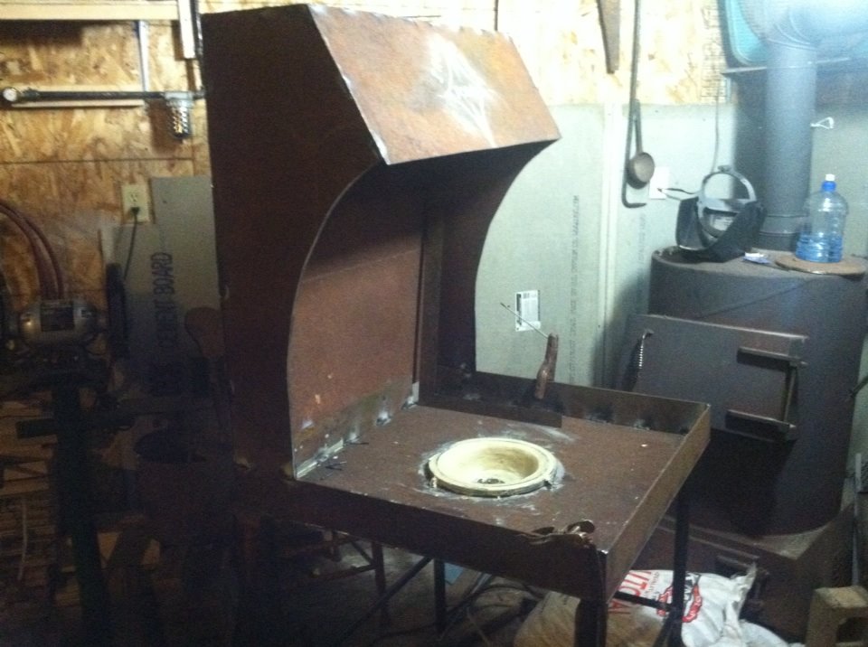

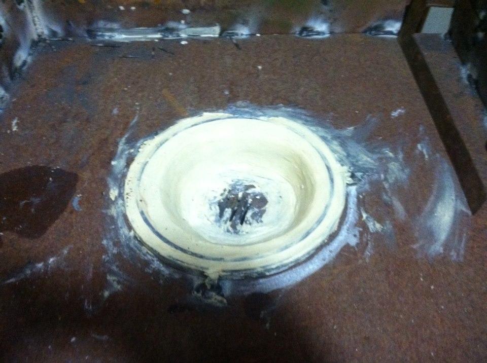

  7. I'd like to hear what make electric blowers are the quietest. I might scrounge one off a junk pile for now, but eventually I'd like to buy a good one. Quiet is good. My retirement years are just beginning and I found a hobby that has deep roots in my past work. My access to many a Buddy's scrap piles and my own have led to this forge project. I'm going to send air from my blower into the exhaust pipe on the hood to make a good draw to the chimney. I'll use a gate valve for my firepot air, and always power exhaust when fire is lit. I'll have adquent fresh air ventilation beside the hood, and installed a co2 monitor. With the blower running 80 to a 100% of the time, I'm hoping to buy a quiet one, but one with a good 'breath'. So whats the quiet line of Blowers? Here is were I ended today. Hood parts all on and tacked in, and the brake drum firepot got refractory cement. I have to scrouge up some pipe parts for the blower, get a gate valve, get a blower, and also run a blower line up into the stack on the hood for a power vent.
