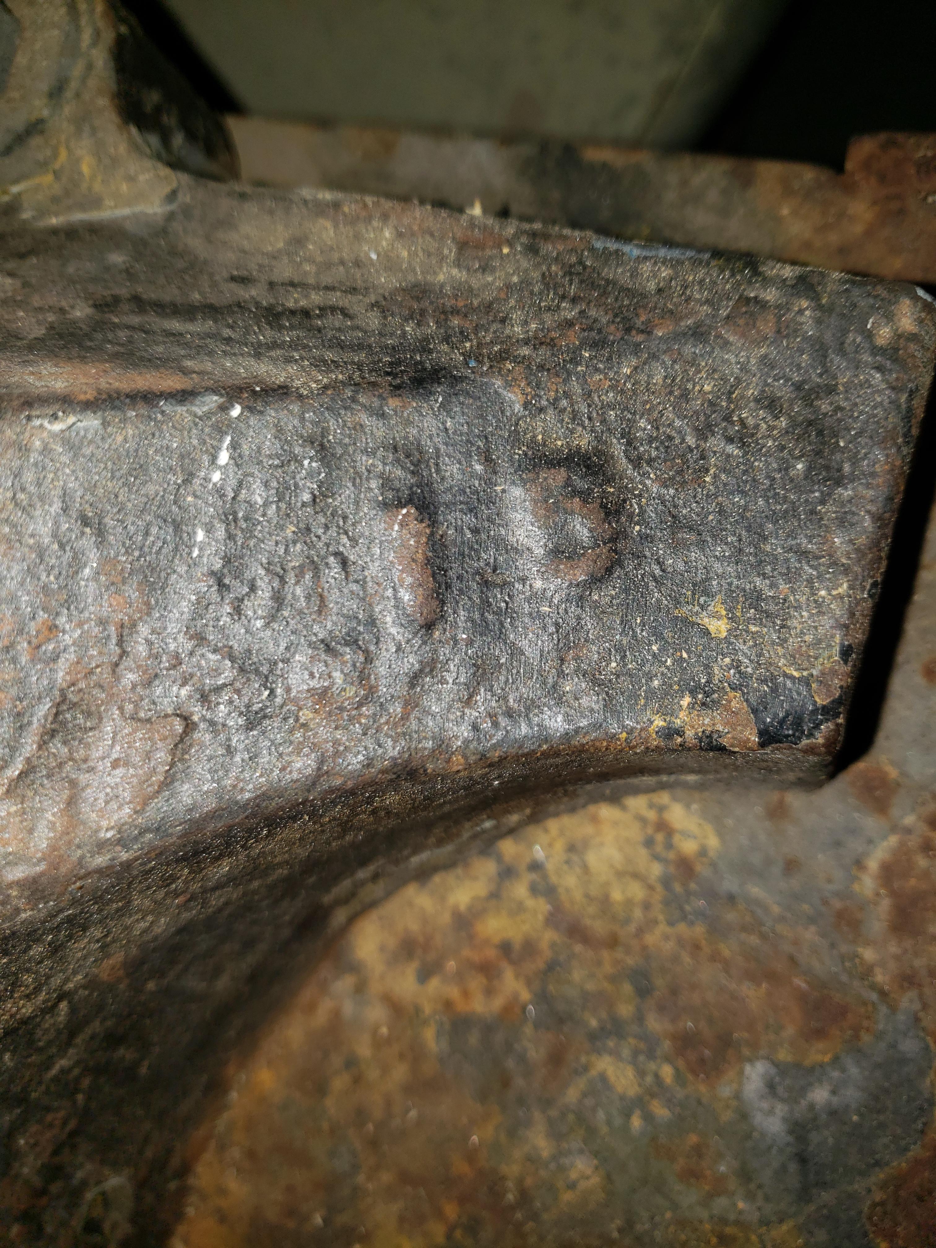

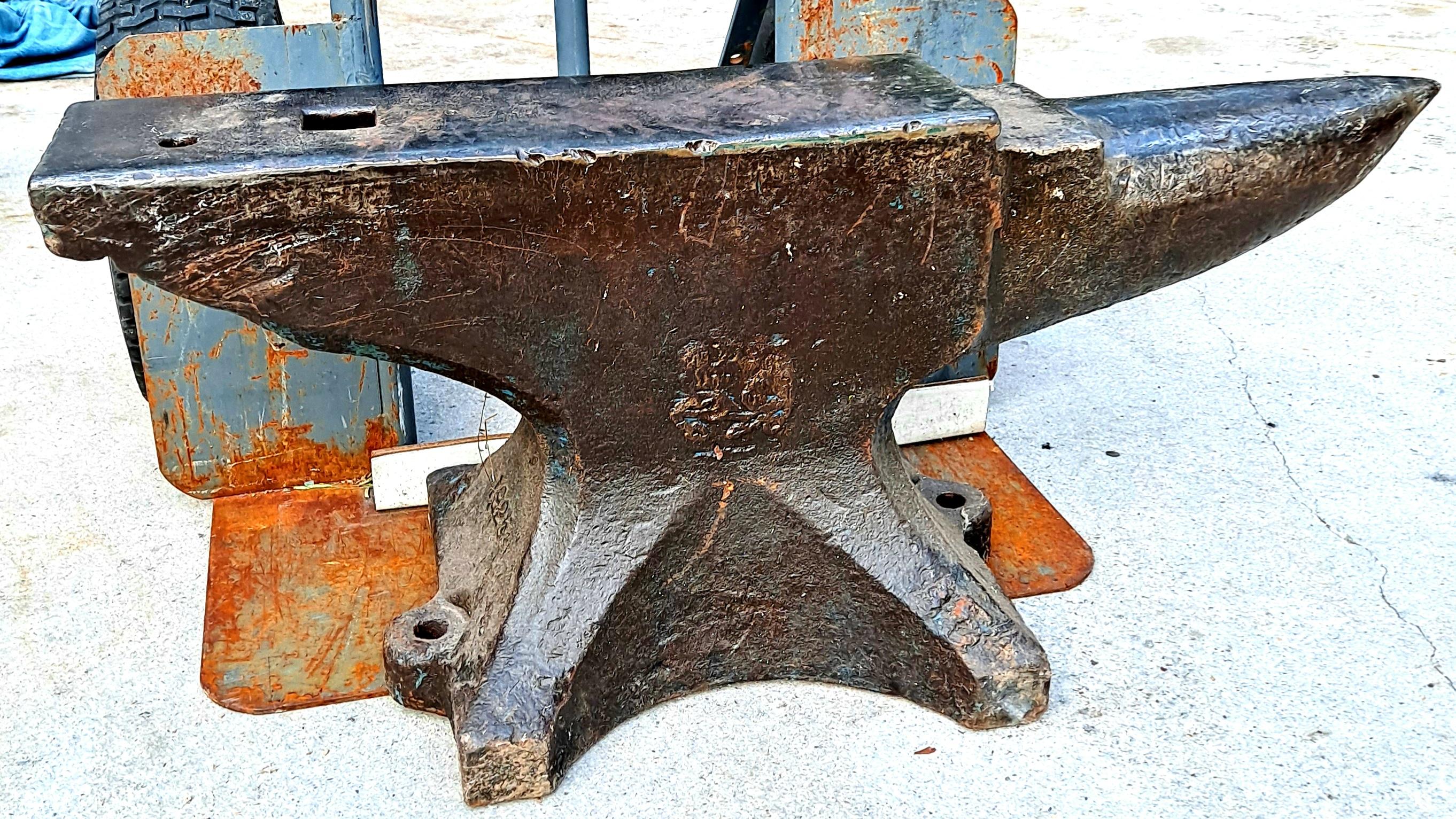

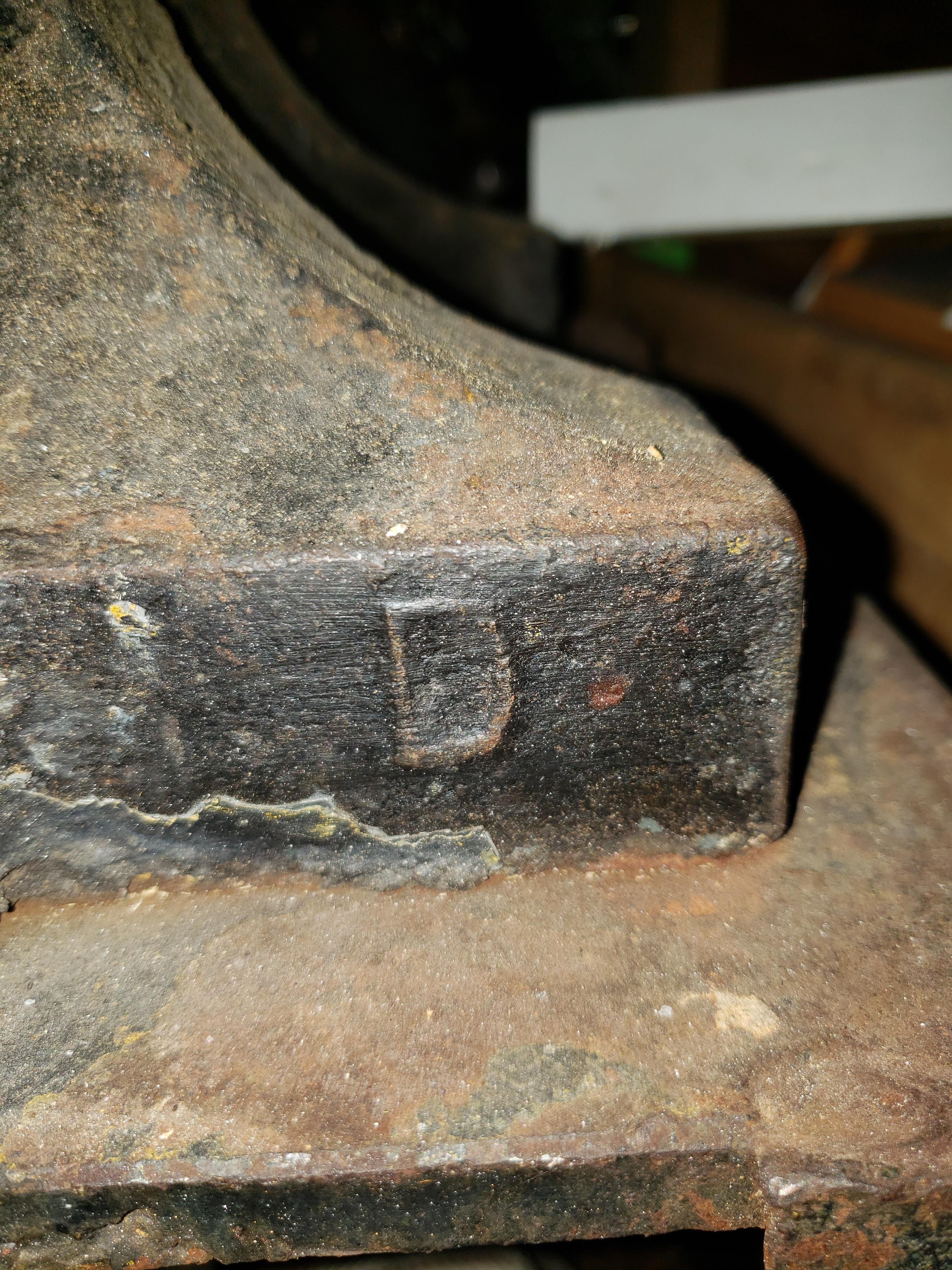

NE Florida Phil Posted October 15, 2021 Share Posted October 15, 2021 Hey there from Florida, Been interested in blacksmithing since the turn of the century and I'm now in a position to do something about it. I acquired a Fisher when I was stationed at Kaneohe MCBH in 2004. I got really lucky and got it for the price of hauling it away. Anyway, I was trying to find out some info about my anvil. I believe it probably was made in 1939, that's as far as I can go. Any info would be appreciated. Quote Link to comment Share on other sites More sharing options...
NE Florida Phil Posted October 15, 2021 Share Posted October 15, 2021 (edited) Overall it looks pretty good. It looks like there may have been some some welding done on the face and the tip of the horn is flattened due to being used as a doorstop. At the end of the day they would tip it over and let it drop on the horn. I'll pull it out of the garage and see if I can get a full profile of it tomorrow. Phil Edited October 16, 2021 by Mod30 Remove duplicate photos. Quote Link to comment Share on other sites More sharing options...
JHCC Posted October 15, 2021 Share Posted October 15, 2021 Welcome to IFI! I'm no Fisher specialist, but I can say with certainty that you've got a good looking anvil there! Quote Link to comment Share on other sites More sharing options...
NE Florida Phil Posted October 15, 2021 Share Posted October 15, 2021 Crazy story... I was in the Navy and had to go check out a hoist to load weapons on the aircraft and saw the anvil propping a door open. I asked the shop supervisor what the deal with the anvil was and he said he'd been trying to get rid of it for a while. I told him I'd be willing to take it, but since i was on my motorcycle I'd have to go get my car... I was back in 15 min... Quote Link to comment Share on other sites More sharing options...
Frosty Posted October 16, 2021 Share Posted October 16, 2021 Welcome aboard Phil, glad to have you. This is where I usually suggest a person put their general location in the header but using it as part of your login aught to do. Nice anvil, great score and a good story! She's in outstanding condition unless she's been through fire and the face has had the temper run out of it. A rebound test will determine that easily enough, just drop a bearing ball on it and estimate how far it rebounds as a %. If you want to be more accurate drop it from 10" on a scale and eyeball how far it bounces back. Fishers don't "ring" so that's not going to tell you much regarding the hardness of the face. I'm guessing but I THINK the 15 on the foot signifies it weighs 150lbs.+/-. A blunted horn was often done intentionally after a smith walked into a sharp horn a couple times. She's a beautiful old lady with a couple few generations of good hard work in her yet. Frosty The Lucky. Quote Link to comment Share on other sites More sharing options...
njanvilman Posted October 18, 2021 Author Share Posted October 18, 2021 Your anvil was made in 1939. The markings are consistent with how Fisher was doing everything at that time. The 15 does mean the anvil was made as a 150 lb anvil at the time. The actual weight might be slightly different; they were rarely exact. The anvil was made in Trenton, NJ. If you want to learn more about the company, and the technology behind your anvil, go to my profile to see the link to my book I wrote about the company. Thanks. Quote Link to comment Share on other sites More sharing options...
