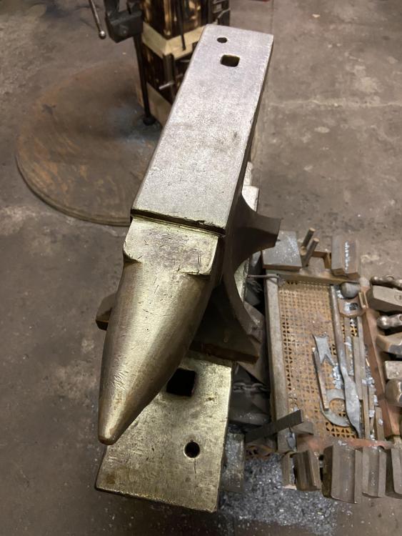

Steven NY Posted January 16, 2020 Share Posted January 16, 2020 Hello all, I picked up this beauty a few weeks ago. The gentleman I purchased it from said he could remember it in his grandfather's garage when he was 6 or 7 years old. So he has know of it for over 75 year. It has been passed down through his family, and has now come to me; along with all of the details he could remember of its history. He has no idea how or why his grandfather had it. It was not used until he did some blacksmith work with it several years ago. It is in great shape, and I am now its custodian. Any light you fisher experts out there may be able to shed on its pedigree would be greatly appreciated. Have a great night, W Quote Link to comment Share on other sites More sharing options...
jlpservicesinc Posted January 16, 2020 Share Posted January 16, 2020 That is cool.. Nice job, I didn't see any weight? My only suggestion is to be gentle with it and try not to hit the face with the hammer. A welcomed treasure for sure. Quote Link to comment Share on other sites More sharing options...
Steven NY Posted January 16, 2020 Share Posted January 16, 2020 Hello JLP, Sorry about that 119 pounds of fun in this little guy. As of right now I will be sticking to using my Trenton anvil. This one will be stored until it is needed. As I was taking pictures of the anvil tonight I noticed the reinforcement under the heel, that seems like a great design feature I have never noticed before. Then again this is my first Fisher. Have a great night, W Quote Link to comment Share on other sites More sharing options...
jlpservicesinc Posted January 16, 2020 Share Posted January 16, 2020 Thanks I had seen the 119 but usually the Fishers are marked on the foot so wasn't sure.. This is the first one i have seen with the inscription just below the face.. I wonder if that was a show room model or something.. Fisher anvil man should be by to help you with info. Thanks You too. Quote Link to comment Share on other sites More sharing options...
Rojo Pedro Posted January 16, 2020 Share Posted January 16, 2020 Nice anvil Steven. Amazing condition! I wonder if the stamping was done by a previous owner who added the weight. Plus the “cast steel” is questionable to me. ?? Quote Link to comment Share on other sites More sharing options...
njanvilman Posted January 16, 2020 Author Share Posted January 16, 2020 You have an 1880's era Fisher anvil. Look under the anvil on the base....there "might" be a date there. Either way, your anvil was made 1879 or 1880. They did not start marking the date under the heel with this model until some time in 1880. The Cast Steel refers to the horn plate, they were cast steel. Just a marketing thing by F&N. The 119 weight stamp might have been added later. The rest of the stampings are original. The anvil was made in Trenton, NJ. Welcome to the Fisher Family....stay tuned here or on my FB page: Fisher & Norris Factory Museum, for the announcement of my book coming soon on the complete history of this company. Guaranteed it will be in interesting read. Quote Link to comment Share on other sites More sharing options...
Steven NY Posted January 16, 2020 Share Posted January 16, 2020 Thank you all! njanvilman : Thanks for the information, from it's condition it is hard to believe it is 140 years old, clearly it was well cared for. I will continue that tradition. I do plan to use it a little just to see how it works, but it will not be my main shop anvil. I will check the base and let everyone know if it is stamped with a date. I will also put it on a scale to check the 119 stamped on the side, maybe that is not a weight marking. Again thank you all for the kind words and information. Have a good one, W Quote Link to comment Share on other sites More sharing options...

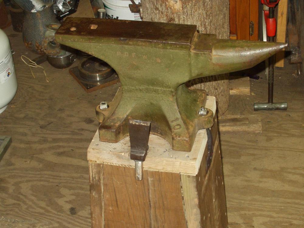

D Ravizza Posted January 18, 2020 Share Posted January 18, 2020 njanvilman, I enjoyed your post regarding Fisher anvil that was made for the military. I believe I have an almost identical one. It also has olive drab paint, I have often wondered if it was for the military. Other than the 10 on the foot mine has no other markings than P D F W stamped into the side (no idea what it means). Do you think this anvil was made for the military too? Thanks, Dan Quote Link to comment Share on other sites More sharing options...
njanvilman Posted January 18, 2020 Author Share Posted January 18, 2020 On 1/18/2020 at 8:24 AM, D Ravizza said: enjoyed your post regarding Fisher anvil that was made for the military. I believe I have an almost identical one. It also has olive drab paint, I have often wondered if it was for the military. Other than the 10 on the foot mine has no other markings than P D F W stamped into the side (no idea what it means). Do you think this anvil was made for the military too? Probably military spec FISHER. The stamped in letters were added sometime during its life. 100 lb Fishers were very commonly made for the military. Your's is probably 1951 vintage. It looks almost unused. Quote Link to comment Share on other sites More sharing options...
