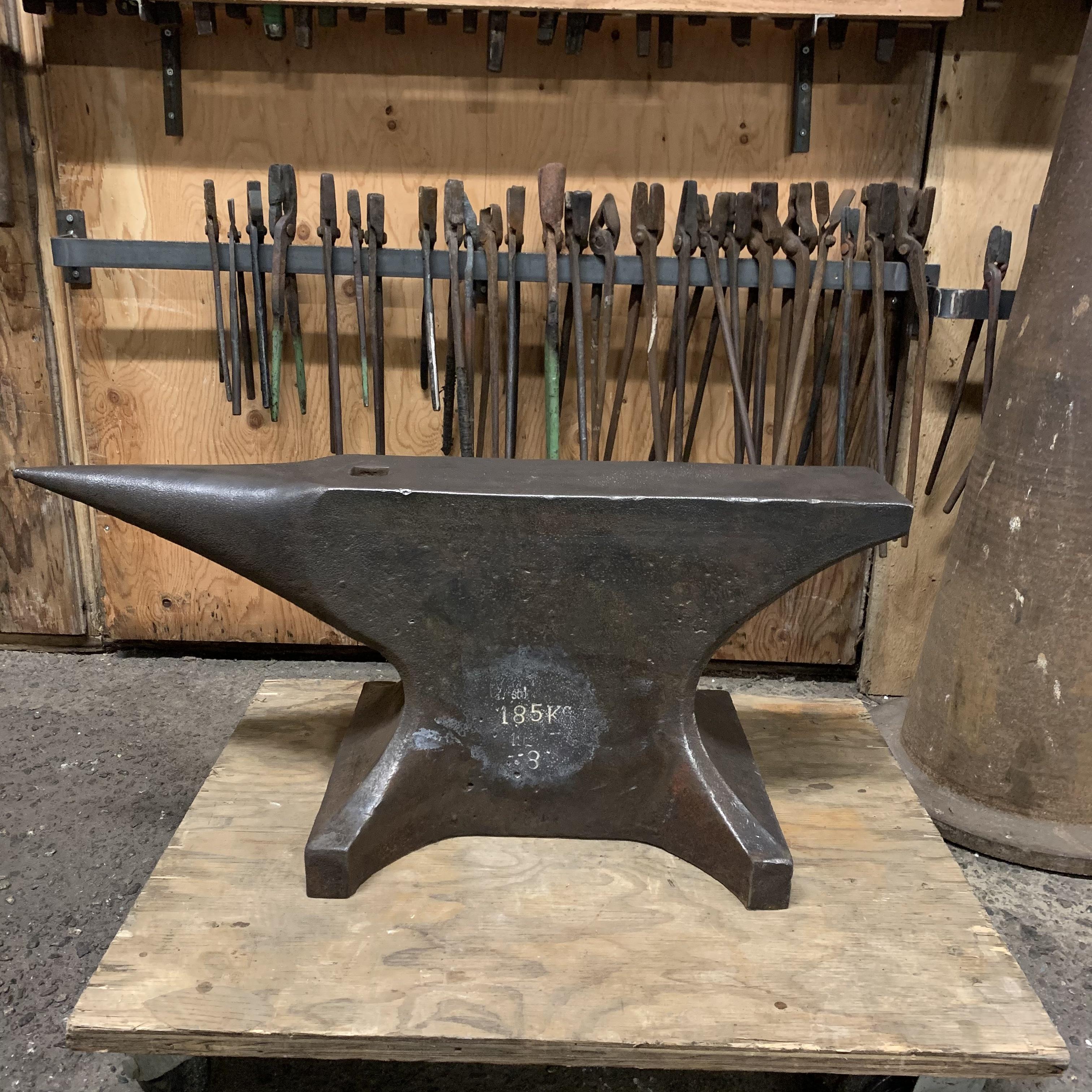

Frf Posted April 13, 2022 Share Posted April 13, 2022 This is my 185kg 1927 Söderfors South German Pattern single horned anvil with a brust or chest. Quote Link to comment Share on other sites More sharing options...
FlatLiner Posted April 13, 2022 Share Posted April 13, 2022 Both anvils are beautiful and a couple of my favorite looking anvils. Quote Link to comment Share on other sites More sharing options...

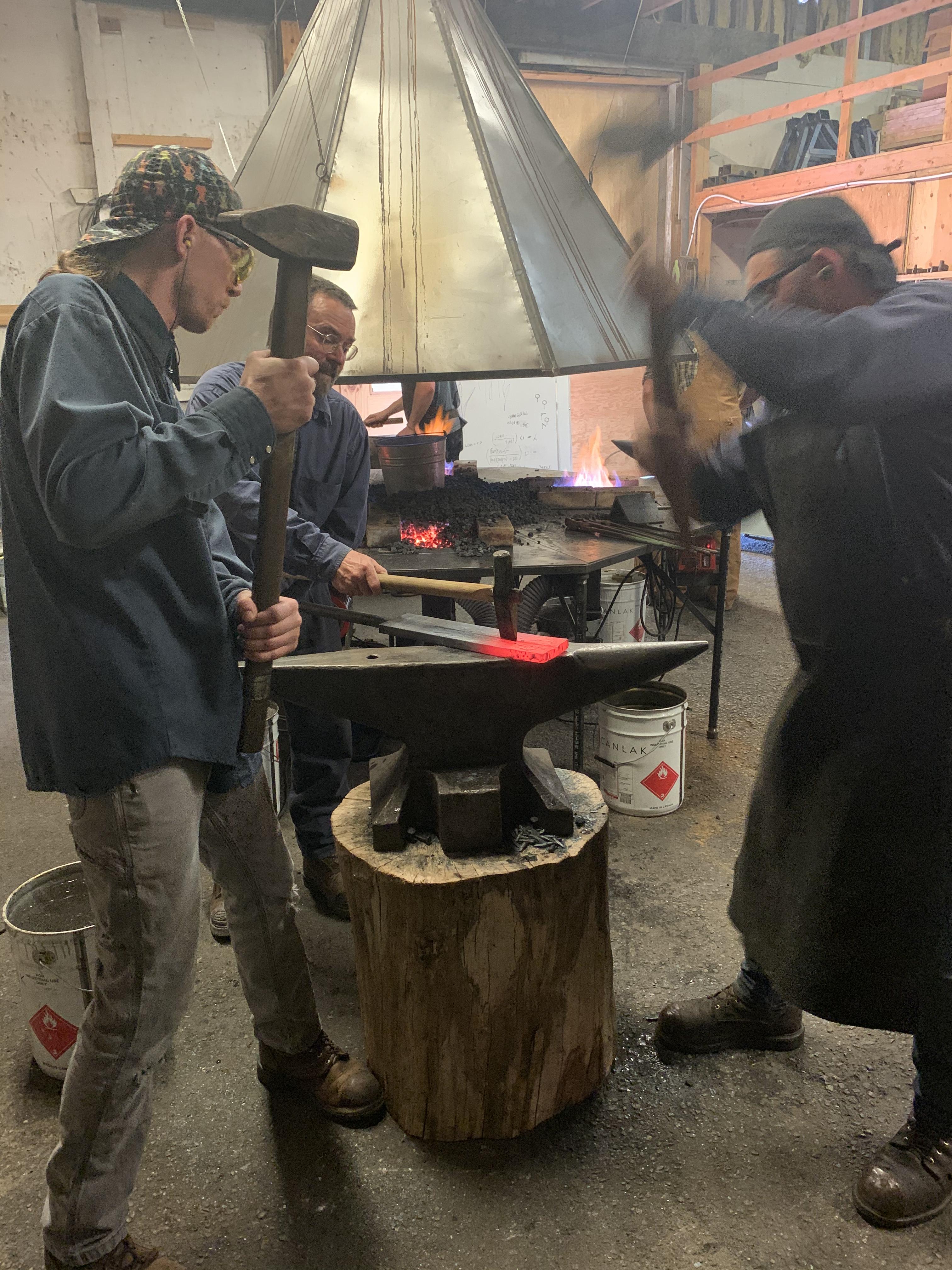

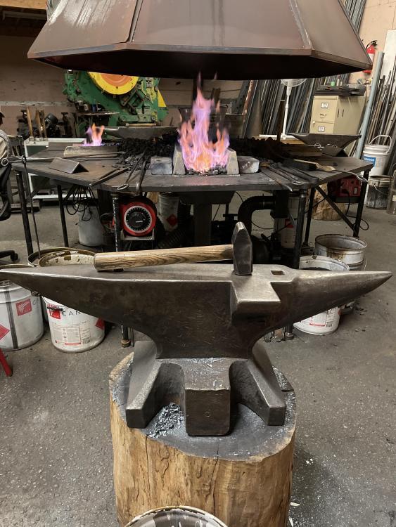

Frf Posted April 13, 2022 Share Posted April 13, 2022 This is my 162kg/357lb Holthaus South German Pattern double horned anvil with the upset block, but no sideshelf. 95% rebound, forged construction from 7 pieces. This is my 274kg/604lb Holthaus North German pattern with upset block. This is our favourite anvil for working with striker. The large mass makes a huge difference in moving metal and it is set at a lower height to offset the height of the upper swage tools. 85% rebound, forged construction from 7 pieces. Quote Link to comment Share on other sites More sharing options...

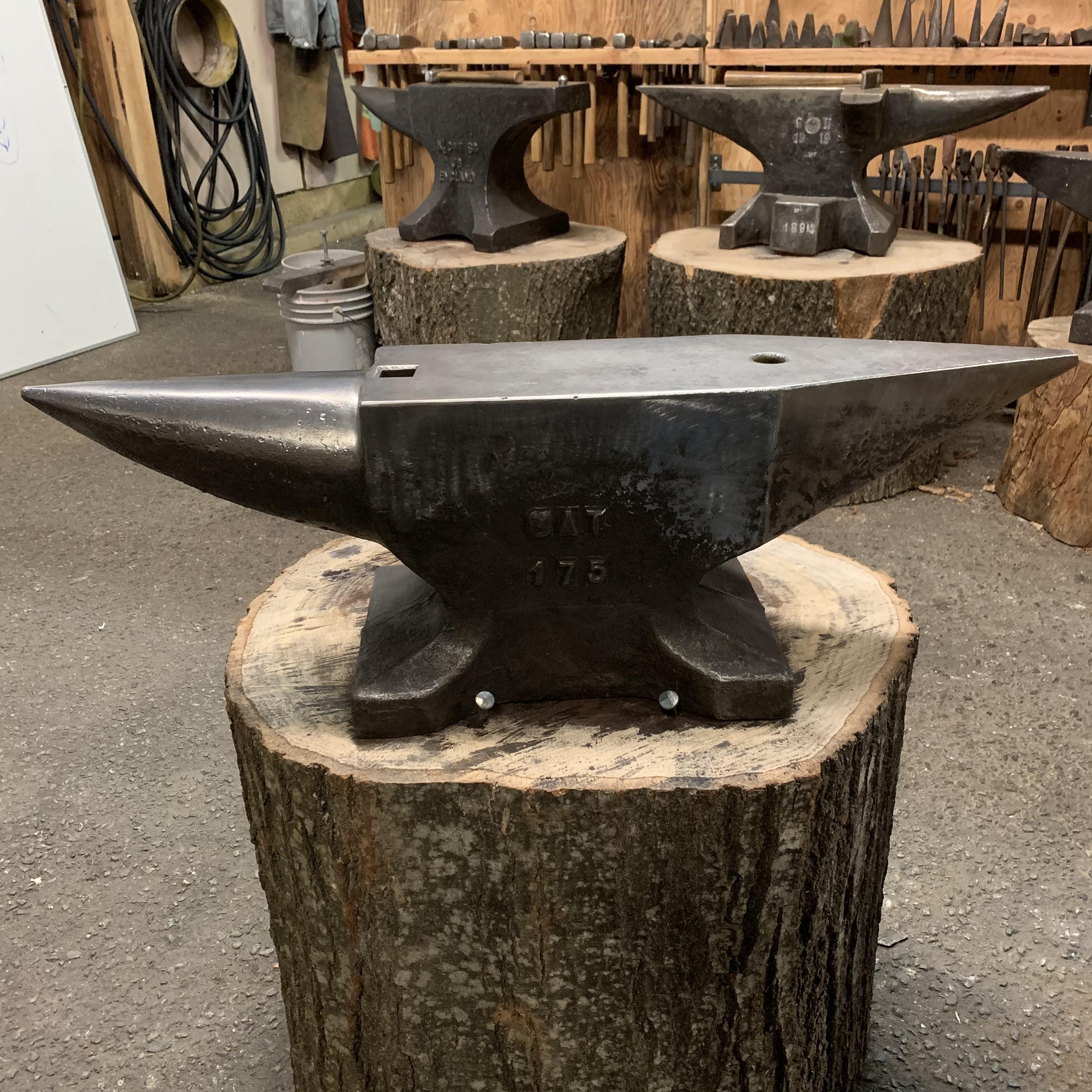

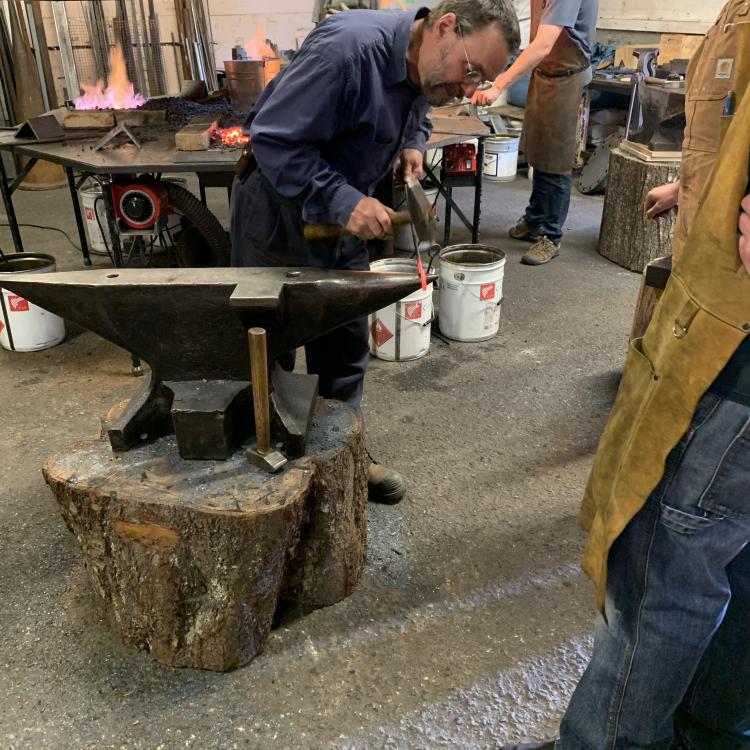

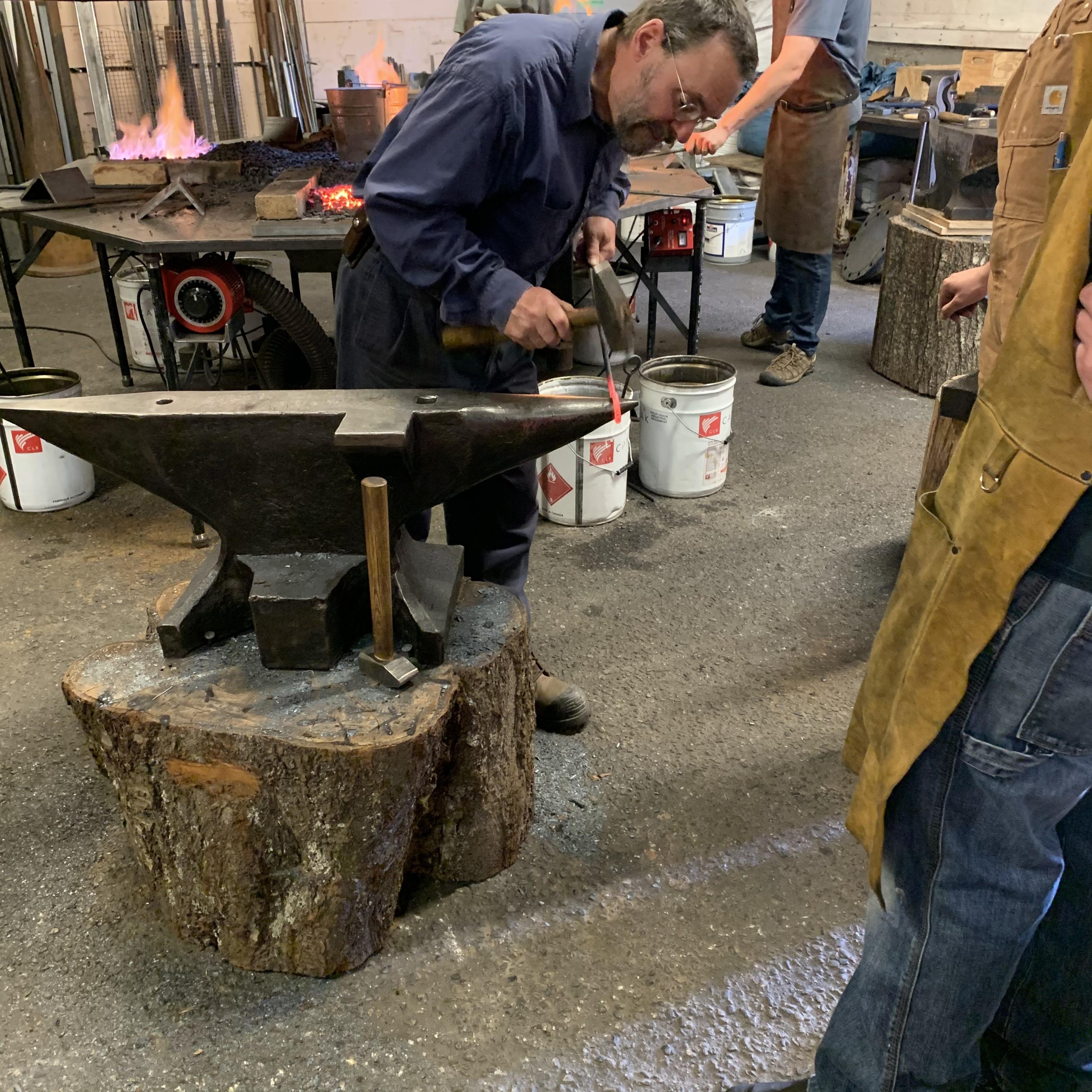

Frf Posted April 13, 2022 Share Posted April 13, 2022 This is my 175kg/386lb UAT Belgian pattern anvil. Very similar to the North German pattern with the abrupt face to round horn transition, but the horn has a belly, the square horn is not notched where it joins the body, and it is low and wide similar to a french pattern anvil. 98% rebound, cast construction. This would have been for tool making. This is our senior blacksmith’s anvil. It is a 204kg/450lb South German pattern with side shelf and upset block. This was forged from 8 pieces in the latter half of the 1800’s. 90% rebound. Quote Link to comment Share on other sites More sharing options...

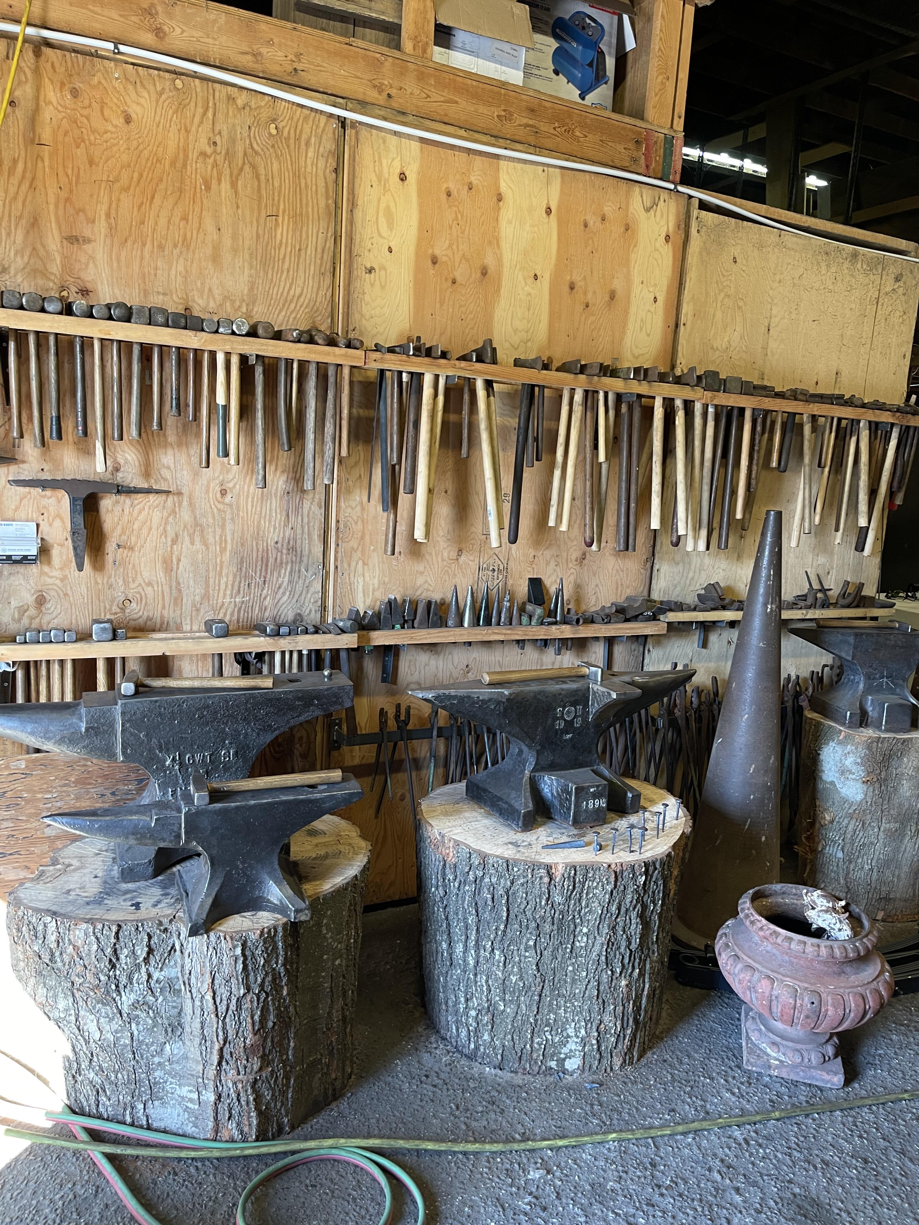

Frf Posted April 13, 2022 Share Posted April 13, 2022 From left to right, a 4.5CWT/504lb John Brooks London pattern 95% rebound, cast construction, in front of that a 145lb Peter Wright with a broken back 45% rebound forged construction, next a 189kg/416lb Söding und Halbach South German pattern with side shelf and upset, forged construction from 8 pieces, and far right is a pre-Rigid Peddinghaus 125kg/275lb North German pattern with upset block, 99% rebound, drop forged construction welded at the waist. Quote Link to comment Share on other sites More sharing options...
Rojo Pedro Posted April 15, 2022 Share Posted April 15, 2022 Nice to see those beauties being used. I can't say which one I like best but that '27 Soderfors is really sweet. Thanks for sharing. Quote Link to comment Share on other sites More sharing options...
