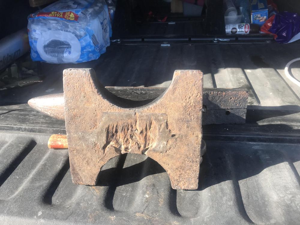

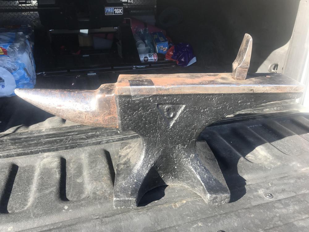

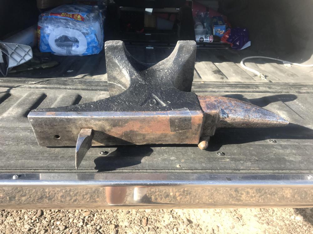

I purchased this 110# Colombian a month ago in Yuma AZ.  I have read nothing but good about these anvils as being cast steel. This anvil was made between 1905 and 1925. The face measures 14 3/4 x 3 5/8. Total 23 1/4. 10” high. Base is 9 1/2 x 9. I will be using it in the spring for mild smithing and knife making when return home. All comments welcome
A good brand and a convenient size; read up how to mute it!  Be cautious with it's edges as cast anvils tend to erode there a tad easier. If your work and working style allows; you may want to round the edges a bit more---doing it to differing radii along the anvil sides can make it into a tooling feature. (I would put the largest radius along the sweet spot.)  Take a piece of chalk and mark the sweet spot  boundaries on the sides and train yourself to do your heaviest hammering within the sweet spot.
I wouldn't mind having that one in my shop to use with my other travel anvils when I go teach.  (When I was younger I always wanted larger anvils; now that I'm within a week of 62 I'm quite happy to have my travel anvils be around 100 pounds +/- 10 pounds...The big ones stay nicely in the shop...)
Thanks Thomas for the valuable info. Will take good care of this anvil. How does one determine the “sweet spot”?
On an anvil the sweet spot is the section of the face where there is metal all the way down to the base. It is the strongest section of the face and also the one that give you the most efficiency in your hammering.   When I teach I sometimes take chalk and mark from the narrowest part of the waist up to the face on both sides to show students where they should be working in the most part.
You will note that old English anvils tend to have larger sweet spots and some of the later American anvils tend to have smaller ones and some like the Nimba pretty much all the face is sweet spot!
