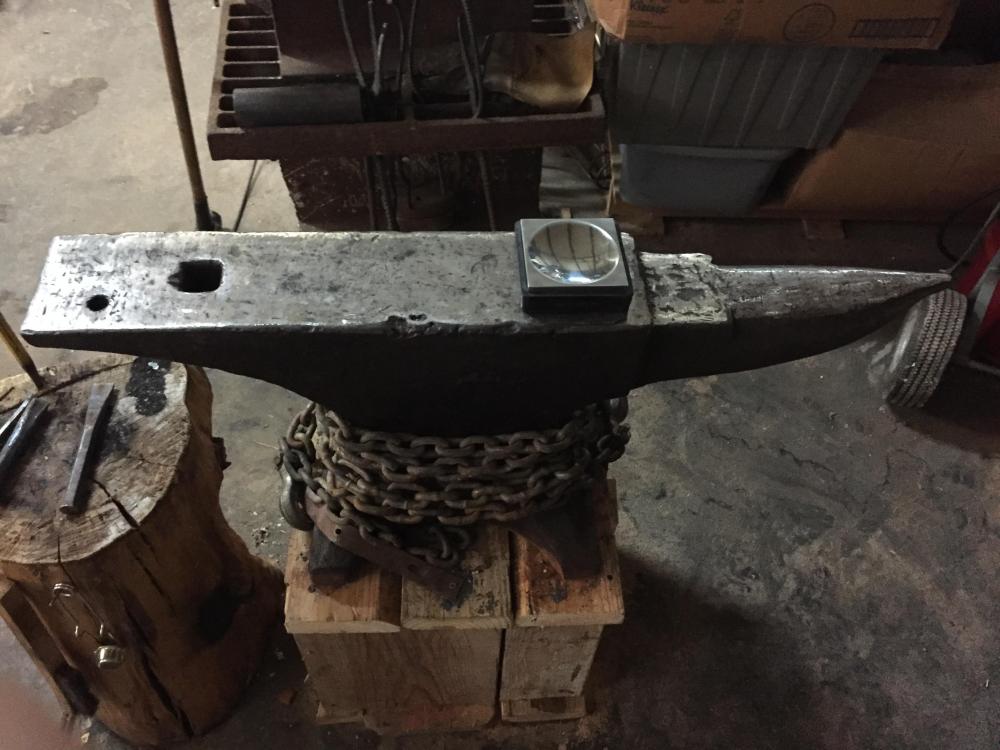

Gods Metal Works Posted August 5, 2018 Share Posted August 5, 2018 I AM blessed for my anvil. I found it from a friend of a friends and it was her great grandpas anvil. It is a 400 pound wrought with steel face. It has no manufacture name. It has a 70 or better rebound and is 37 inches Long and 5 1/2 inch wide. It is a London pattern anvil. I am super happy to have found and this is the best part. I got it for 300 dollars! That is 75 cents a pound! I tell you if you pray and look around and keep asking, good things happen. I didn't even find it my brother found it and it was sitting in their front yard. What turned us on about the big anvil was on their porch there was a smaller anvil but in the backyard was a big shop anvil. Btw the rounding swage was not with it, I bought that. Also I am making a 400 pound hydraulic press with what you see behind the anvil. Quote Link to comment Share on other sites More sharing options...

ThomasPowers Posted August 6, 2018 Share Posted August 6, 2018 Can you show us a clear picture of the feet and the bottom? The skinny heel is often an American design. Any number stampings on the front of the feet that is under the horn? Quote Link to comment Share on other sites More sharing options...
Gods Metal Works Posted August 6, 2018 Share Posted August 6, 2018 I am sorry I cannot show you the bottom of my anvil because it is to big to move without an engine hoist. There are no number standings just stamped on the side I can barely make out tony writing of what says wrought and that is all. Though I do know the anvil is very old. Quote Link to comment Share on other sites More sharing options...
ThomasPowers Posted August 6, 2018 Share Posted August 6, 2018 Sorry but that design is not "very old"; very old for anvils is over 200 years old and they tend to be squat in shape with small heels and horns. That design is under 150 years old. And has at least 100+ years of use left in it. How did you determine the weight? Quote Link to comment Share on other sites More sharing options...

ThomasPowers Posted August 6, 2018 Share Posted August 6, 2018 Well like with people "It's not the years; it's the mileage!" I've seen a lot of bridge anvils used to reforge cable tool drilling bits back before the rotary drill bit for oil well drilling was developed. They are almost *always* beat to words not allowed on this site; much worse condition than many anvils I have seen twice their age. Getting into a craft that has around 3000 years of history to it; you may need to recalibrate your oldometer . You have also demonstrated that you don't need a cherry picker; but I'd suggest you refrain from lifting anvils that size without one anyway. I took my forge up to my church's summer camp again this year and spent several days teaching campers how to forge simple items: s-hooks, chili peppers and marshmallow roasters; we also had a pastor forge a cross from 3 large landscaping timber nails. Quote Link to comment Share on other sites More sharing options...
