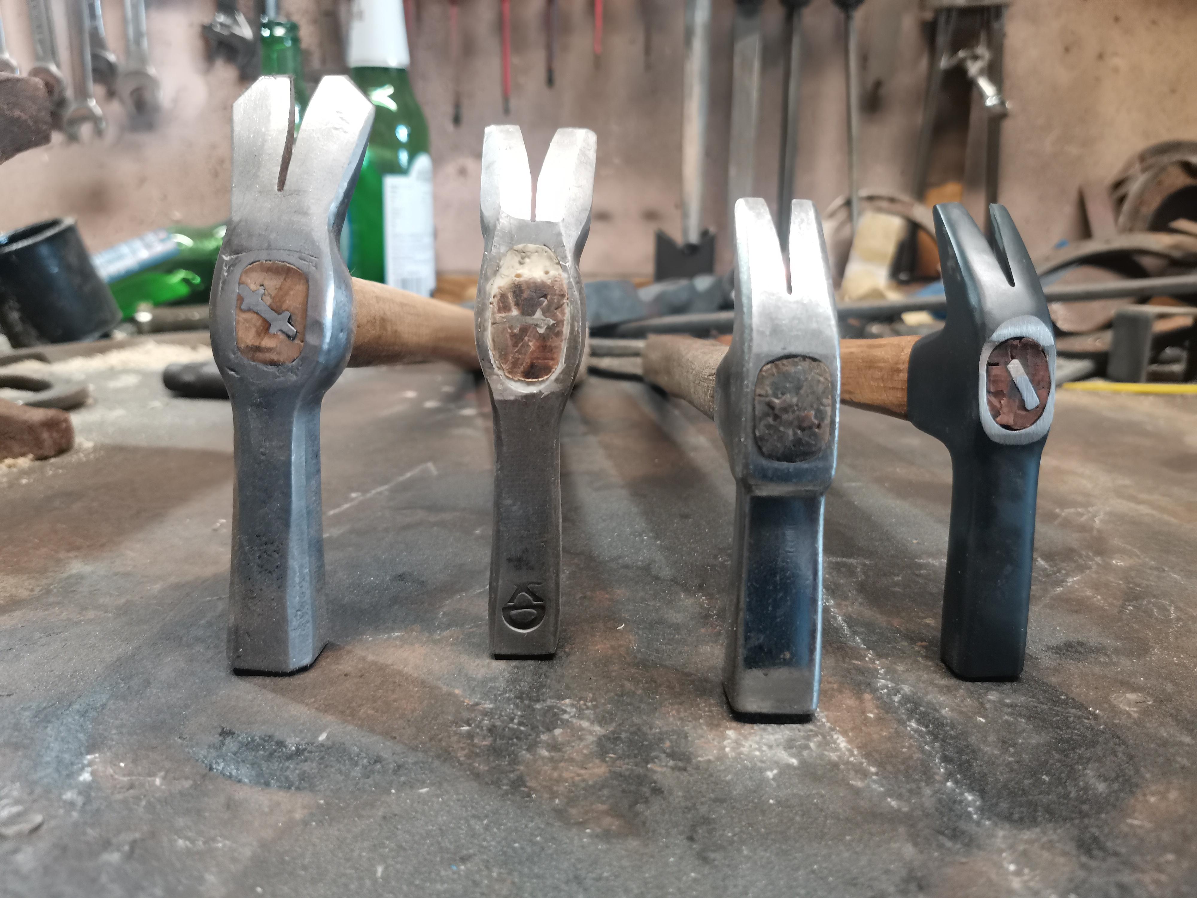

  5. I've used a few different driving hammers over the years, including the Tom Hall and Horsehead hammers you show above. I think the Horsehead was possibly the best commercially produced hammer I have used, or at least best suited to me but nowadays I prefer my own handmade hammers. The two on the left are forged from 4340 alloy and the two on the right were ground and shaped from blocks of D2 steel.

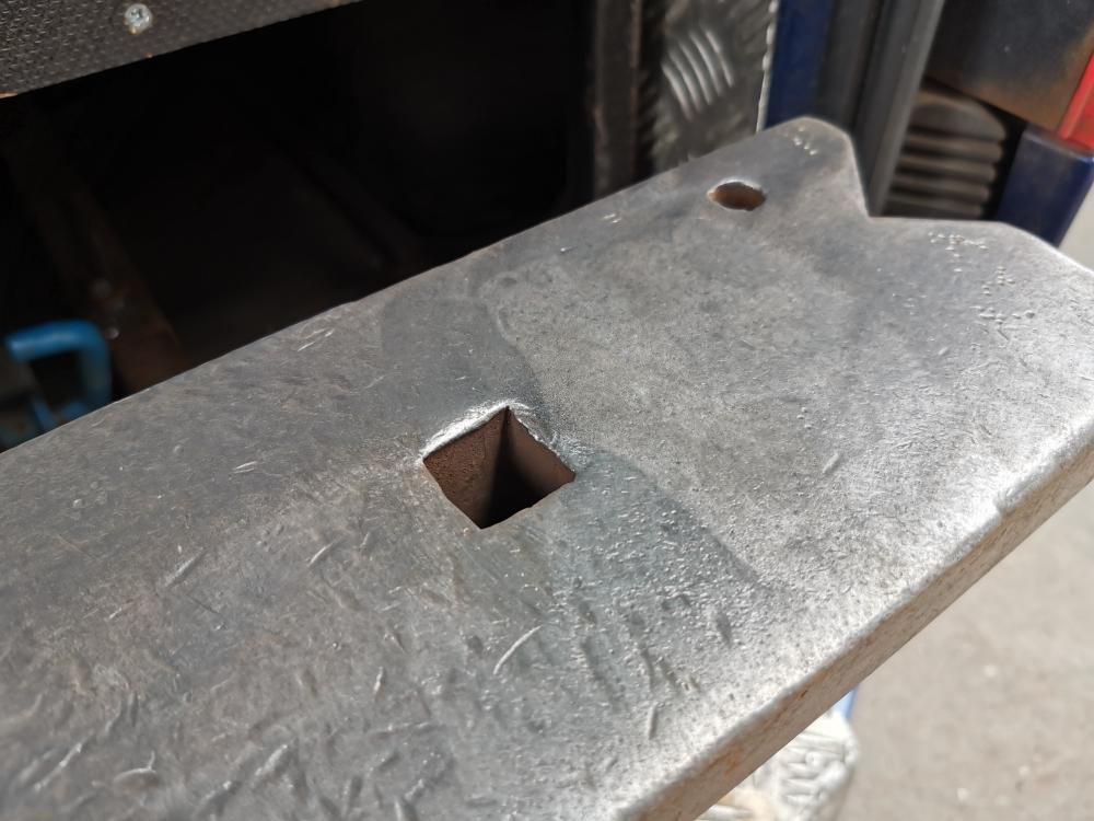

  8. Here's a better image that goes some way to indicating where the hard region is. As I said, my colleagues anvil has an apparent 'difference in properties' in the same locality.The difference being that his anvil has a 'soft line' just behind the hardie hole and hard either side of that, whereas my anvil has this hard 'patch'.

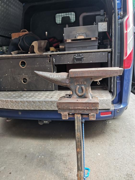

  9. Bakers American pattern Farrier’s anvil, made by Vaughans, Stourbridge, UK. Used on the back of my van, predominantly for shaping and occasionally making horseshoes. Weight 80lbs (approx.) Overall length 21 ½” Width 5” Length of bick 9 ½” Height 9” Rebound area 1: 65%, area 2: 90% Price New £650 (paid £175 with stand) Bought from South Wales – 500 mile round trip. Had a great weekend away with my son, fetching this. We slept in the van, ate takeaways and soaked up the sun. A proper bonding weekend, with great memories, so at that point, the anvil had already paid for itself! I’d used a couple of these, over the years, when helping other farriers. It is by far the best suited ‘mobile’ anvil for me. This was a welcome replacement for the Alu-Anvil, which I just didn’t get on with. The only two downsides are the variability in hardness, across the table (second image). The large expanse of table behind the hardie hole gave approx. 90% on the rebound test, whereas the main working area of the table only returned 65% on the rebound; this area also marks up very easily. My colleagues Baker anvil also has a clear line, at the same position, where the mechanical properties differ (but hard either side of the line). It’s not clear what causes this, it appears to be either a weld line (two part construction?), or the effects of different temperature regimes (manufacture, or heat treatment). The second downside is the clipping horn; this addition to the bick, sits right in the way of my tongs should be, when drawing clips on the edge of the table. I understand the clipping horn is there, so that `I don’t use the edge of the table but it’s not the right shape. The previous owner made a couple of modifications, the main one is the V-shaped cut out at the heal. I thought I could work around this but to be honest I’ve found myself making use of the mod on many occasions.

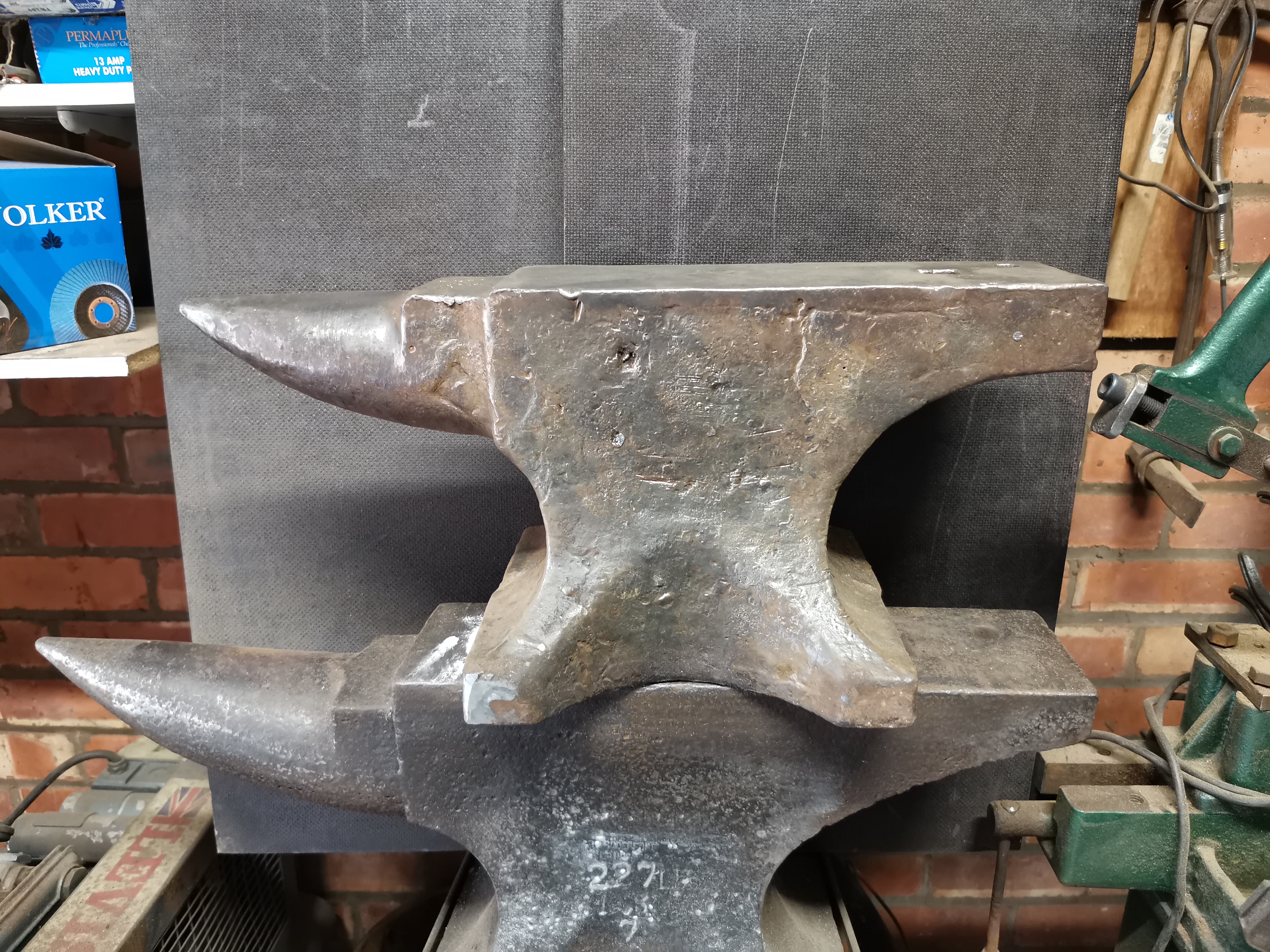

  10. Soderfors 227lbs A brief review of a recently acquired Soderfors anvil. Weight 227lbs Overall length 28” Width 5” Length of bick + cutting table 10 ¾ “ Height 12” Rebound (12” drop) 90% Year of production 19?3 (illegible) There is a large number ‘7’ on the markings, not sure of the significance. This is up there with the best anvils I’ve had the pleasure of using. Although relatively new to me, the dimensions, weight and condition are perfect for my requirements. Primarily this is used for making horseshoes but is also used for tool making and small forging projects. The working face is in great condition, nice and wide with no dips or chips. The edges are in good condition, they have a small radius but are sharp enough for drawing clips. It’s hard, hence the 90% (approx.) rebound, so hammer blows have to be accurate. This is now my go-to anvil. George Blair anvil (Gateshead, UK). Weight 150lbs Overall length 22” Width 4 ½” Length of bick + cutting table 8” Height 9 ½” 90% rebound Bought (rescued) for £20, from a garage using it as a welding bench, approx. 30 years back. Used for shoe making until a few months ago. Superb anvil, no real wear and tear, no dips, or chips but not quite as wide, or long as I’d like. It’s given me great service over the years, now safely stored away.

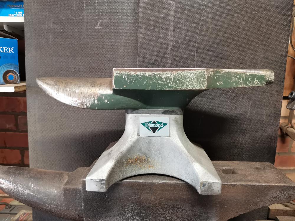

  11. Diamond Large Face Alu-Anvil The following is a brief review of a Diamond half steel, half aluminium, Farrier’s anvil. Designed to minimise weight, while providing a ‘large’ working face, for use in the vans of mobile farriers. Weight 55lbs Overall length 19” Width 5 ¼” Length of bick 7” Height 9” 1” hardie hole Rebound approx. 75% (12” drop) Price New £630 I love the weight and mobility of this anvil. The wide face makes it easy to keep shoes flat when forging. Never used the turning cams on the heal, that’s what the bick is for. However, there lies the problem with this anvil, the shape of the bick… Given all of its positive attributes, I have been unable to get on with the bick, hence the purchase of the Bakers American pattern anvil.
  12. The Sodefors, so far, has been a pleasure to use. The George Blair has been a great servant but it doesn’t have as wide a face as I’d like when making draught horse shoes. The Blair is sat on the Sodefors anvil in the image but perspective doesn’t show the true difference in size. In terms of ‘performance’, they have a similar feel, both have hard working surfaces but my gut feeling is that the Sodefors face is harder – to the point I have concerns over potential for chipping, when using the edges to draw clips; no mishaps yet though. Where the Blair wins, is manoeuvrability. I know it’s not a prerequisite for an anvil but at one time I used to lift the Blair in and out of the shoeing rig, at each call, I’d never shoe another horse if I had to lift the Sodefors. I’ve since bought a couple of mobile anvils, one was a half/half anvil (aluminium base, steel top half) with a lovely wide face but a weird shaped bick; this was quickly replaced with a Bakers American pattern Farriers wide table anvil, once produced by Vaughans, Stourbridge, UK. This was my dream mobile anvil, after using one belonging to a colleague, hence when one became available… I have a further large anvil, in a forge at my Dad’s place. It’s a little worn in places, mainly on the edges but really nice to use. Not sure what make it is as I don’t see any markings. I’ll take some images next time I visit and ask for help on here with identification. I’ll also run some rebound tests for comparison.
  13. I've been making horseshoes on this anvil for 3 decades but know very little about it. It came out of a vehicle mechanics shop, where it was being used as a welding table. Never bothered with identification but recently bought a larger Soderfors, which spiked my curiosity. The raised area plack has George Blair, Gateshead, 1945? Stamped but I can find very little information on the Internet.
