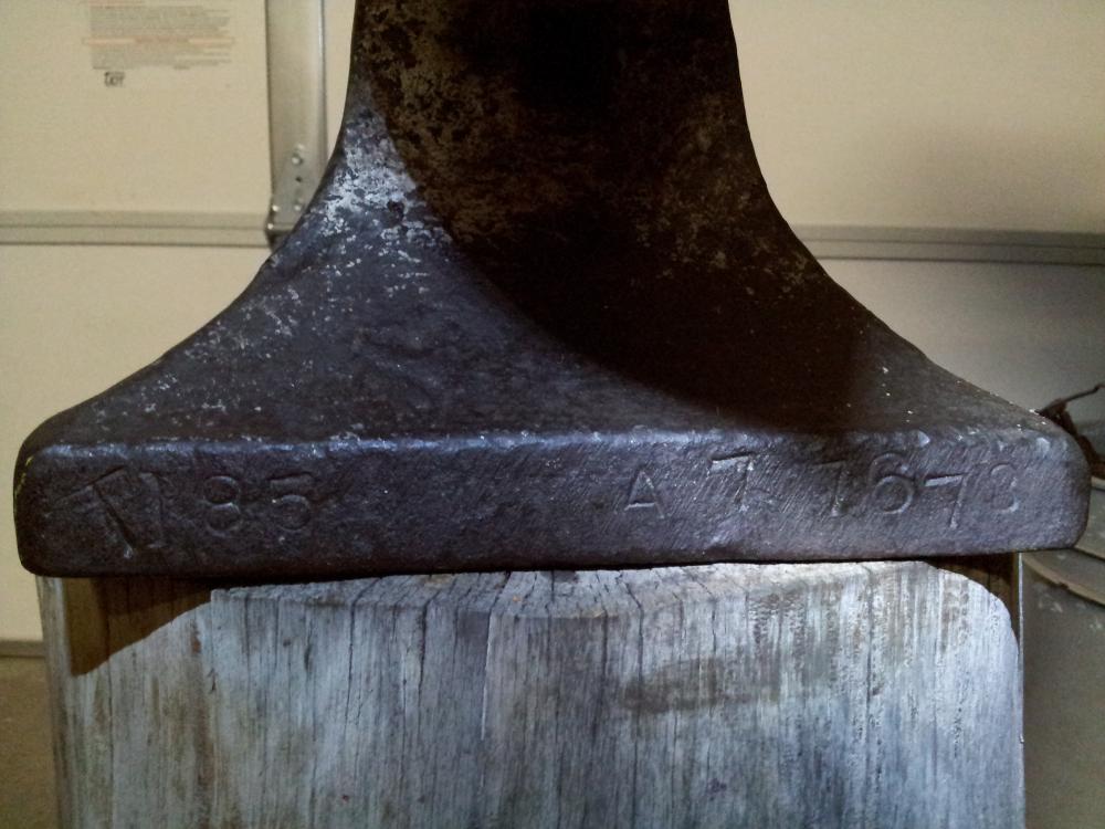

Where do you guys find the age on the anvil? Is there a book I should buy, or is there a formula for figuring from the serial number. I have a Trenton that has 175 on the left front and 18674 on the right, could someone tell me how old it is?
The book 'Anvils In America' by Richard Postman is the most commonly used book for determining the age of some brands of anvils. It is a fascinating book that has oodles of information.
For your Trenton, the '175' would be the weight in pounds and the serial number 18674 would indicate your anvil was manufactured in approximately 1900.

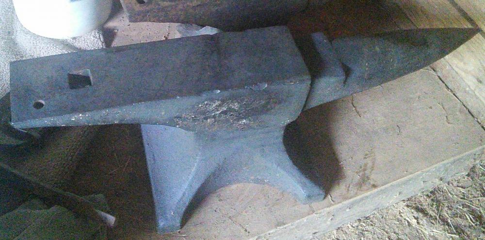

Here is my Trenton. It looks to me like an import from what AIA says as there is no number or USA on it anywhere. Plus the bottom is just weird, it is not cast, no Trenton hourglass, it is all wavy and not flat at all. I have spent some time looking other Trentons and I cannot seem to find one with a bottom like mine. The others are all flat with the hourglass shape in them or they resemble a Peter Wright with the four handling holes. I do not know who made mine as the face matches the specs of a PW 4 x 14 ½ and the bottom is well weird. Anyway here it is. There are some markings under the horn but who know when those were made as there are two sets. Paid $125, it is big enough to do what I want to do but small enough to want another one :)
If anybody has any idea why the bottom is shaped like that I would love to know.
My theories are that it was the last one made at the end of shift on Friday and everybody wanted to go home or it was the first one made on Monday morning when they were too hungover to care. Either way they did not have enough metal to finish the base properly and it was classified as a second, then it was stamped with Trenton and sold to Boker.

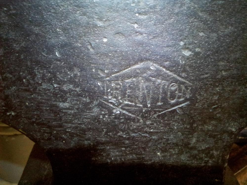

Chris, according to AIA that would be 1908.
To others, it seems that IFI has lost all the pics in this Trenton List thread unfortunately.  The past few years I've been creating a Trenton logo database, the firm used many different logos through their history.  I've been cataloging the different logos and creating serial number ranges for each style of logo.  I'd love to see closeup pictures of your Trenton logo stamp, and a picture of the serial number so I can add it to the list!  Each sample helps fill in the gaps of the database.
