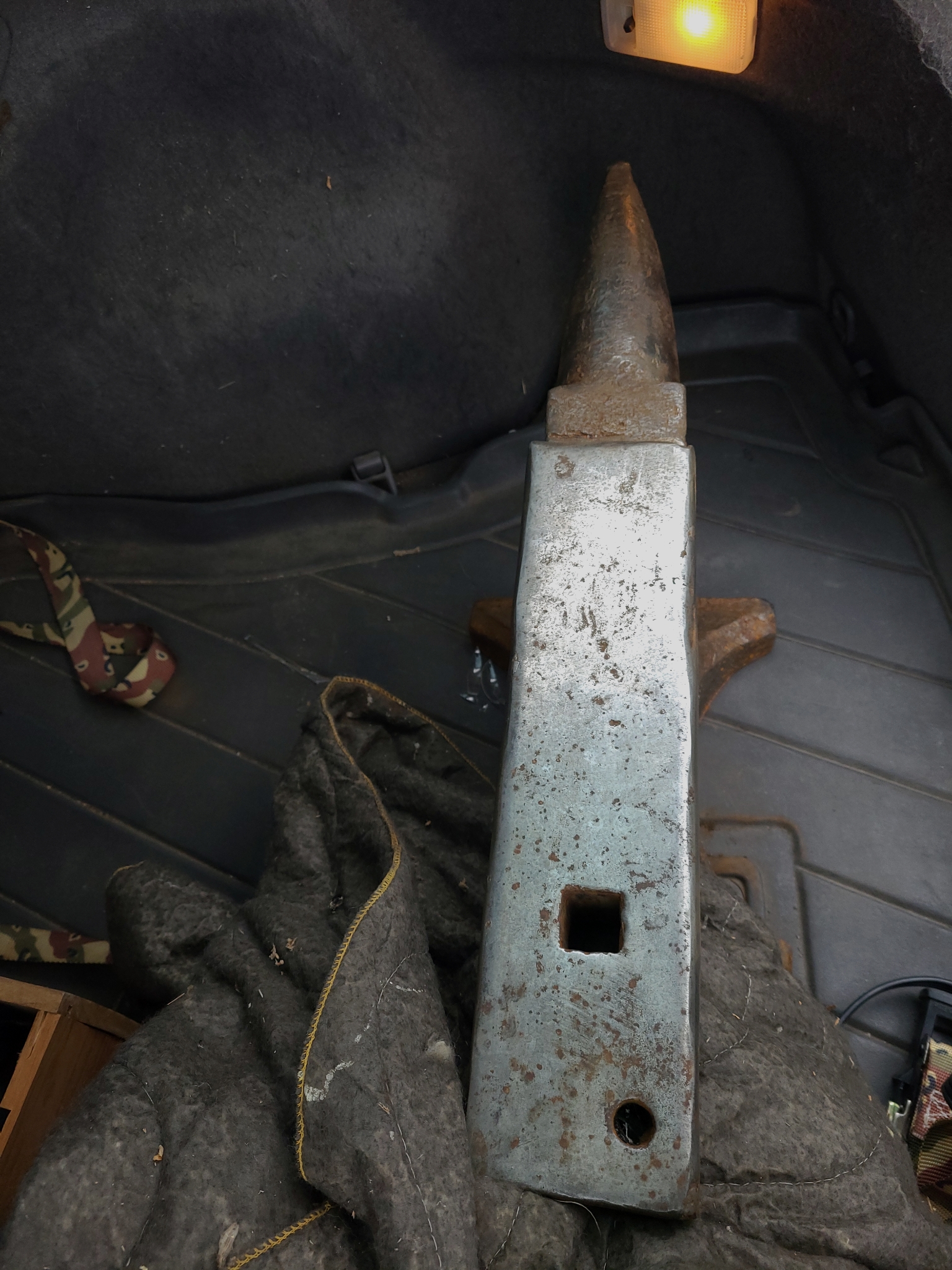

Yanni Rockitz Posted July 16, 2021 Share Posted July 16, 2021 Here's my 'new' Trenton. Any thoughts on its birth date? No serial numbers or stampings of any kind on either side of the base, where the serial number should be, so I'm looking for help dating this baby. There's a fairly clear "Trenton" diamond logo with a properly shaped N in the center (not the one that looks like an X) and a partially obscured "SOLID WROUGHT" round stamp below it, with what I think is the word "PATENT" in between them and a "159" below that, near the base. Nothing on the feet... rough concave in the base, underneath. I haven't had a chance to get 'er on the scale yet, but I'm guessing she's 159 lbs or thereabouts -- looks and hefts about twice the size and weight of my little 80 lb anvil. Also looking for advice on the face -- there's a fair amount of cupping in the center and around the hardie (hardy?) hole, showing very clearly that a TON of work has been done on this old beauty over many years -- clearly by people who knew enough not to damage it, as there are very few dings or chips out of the edges. They're in remarkably good condition, given that amount of work that could put that amount of work-pounded curvature into the face. The front, by the step, is like a little ski jump and the hardie hole is quite dished out around it. I really wish I could have it ground or milled perfectly flat again, but I'm pretty sure that's a really bad idea with this particular specimen. I doubt there's enough steel plate (maybe 1/4" to 3/8"?) to sustain that and it would have to be water-bath milling or grinding to avoid ruining the temper. Even then... I'm thinking the main section over the waist is wide enough (~6-7") and flat enough that it'll work fine for hammering stuff flat -- and top tools in the hardie should be fine. I'll make a custom set for this old girl that will nestle into her welcoming bosom. ;-) There's a very dished out depression next to the pritchel hole, which almost looks like it was ground out as a rounding spot, though I don't see any grinder marks. Literally could've been deformed that way over thousands of strikes with a ball peen... and it's kind of a neat little rounding "swage". The face, despite it's curvaceous undulations, is remarkably smooth. Curious to hear thoughts from folks who've used old curvy anvils on whether these curvy areas will be an issue or can they easily be lived with. My little 80 lb travel anvil is perfectly flat, if I really need something to sit 100% flat, I guess. Gotta figure out a spot to put it as a second anvil in my little 12'x12' smithy... Quote Link to comment Share on other sites More sharing options...
