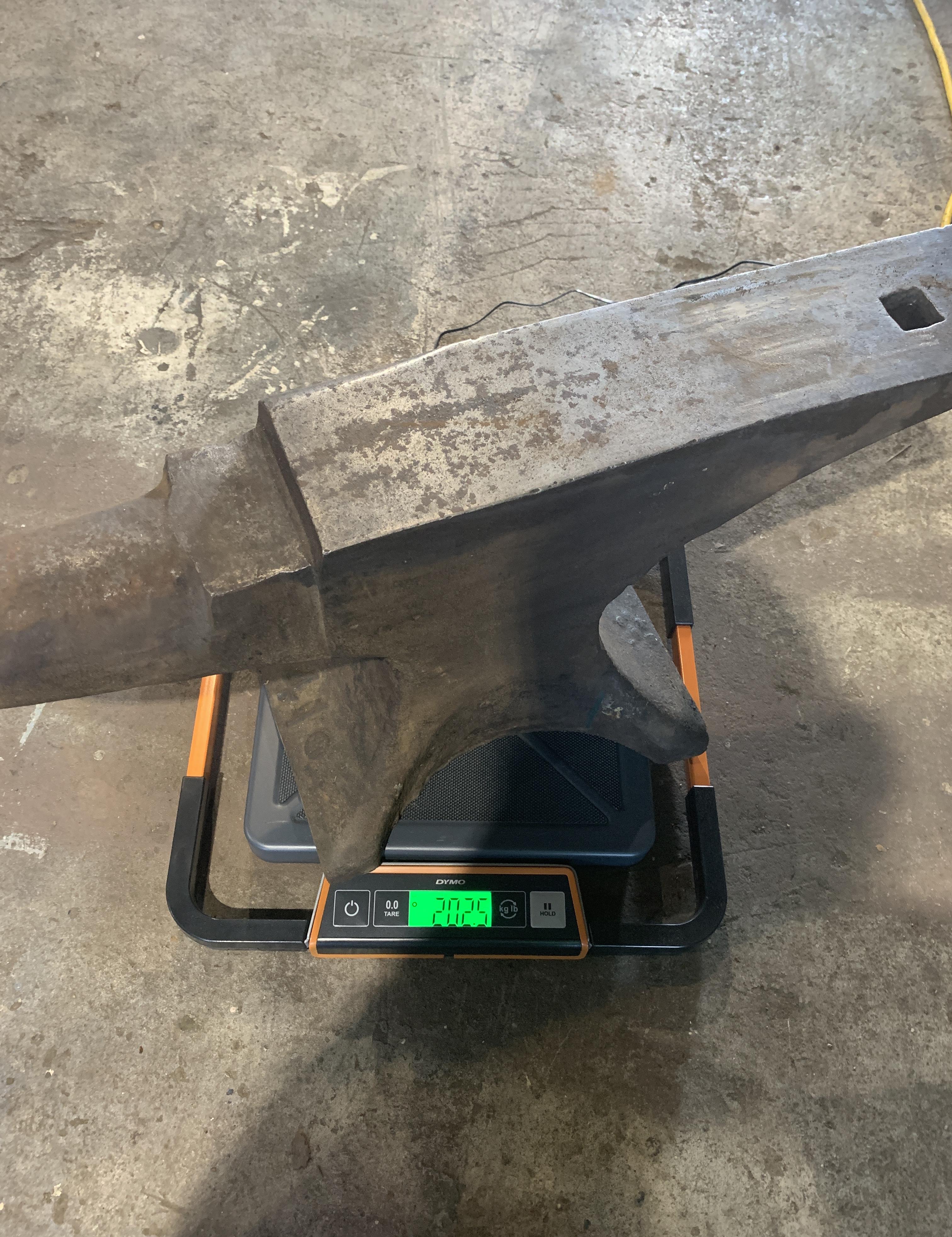

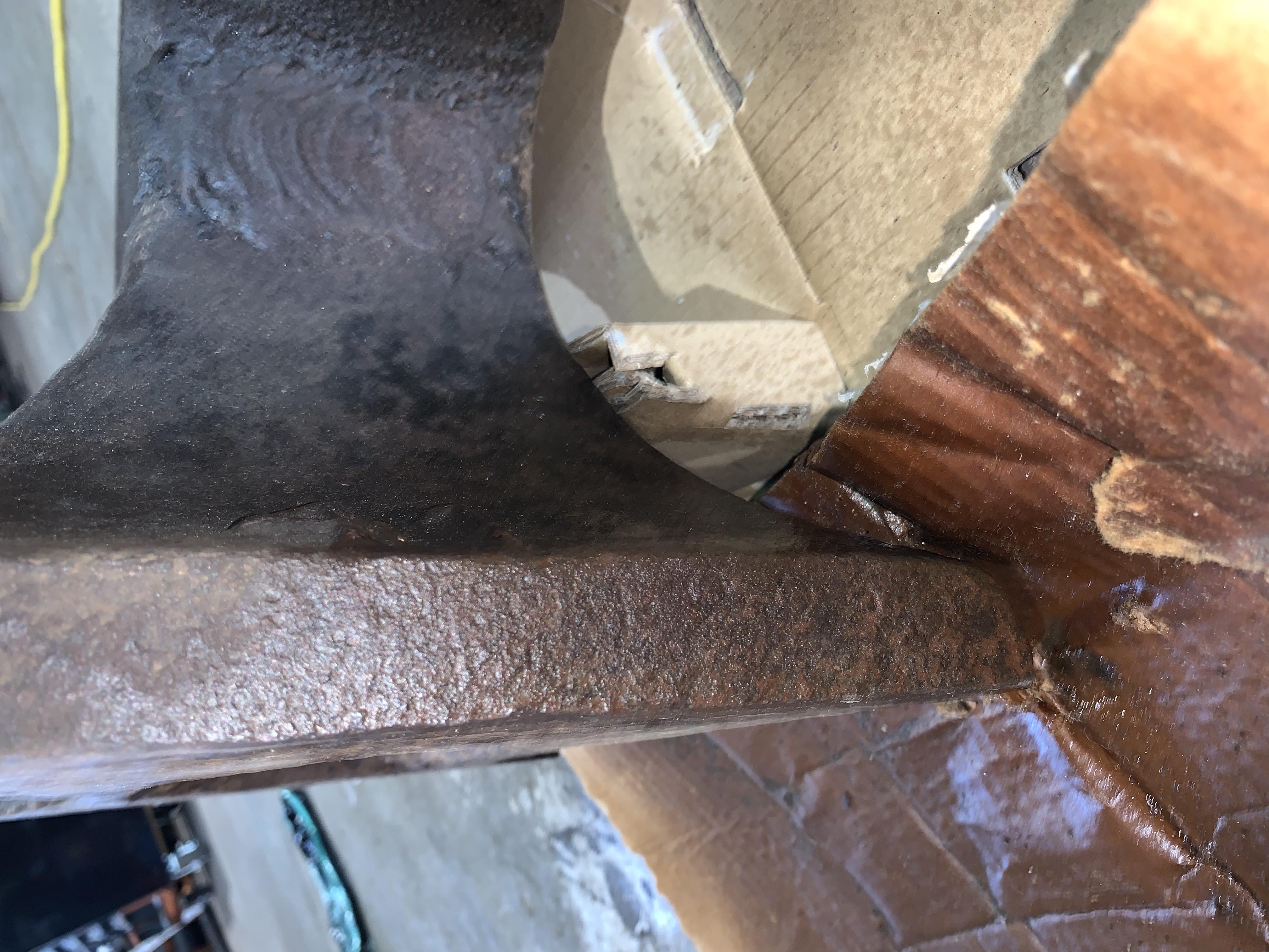

Good morning everyone! I figured this would be a good spot to make my first post. This is my first anvil and she looks to be a great user! I'm not sure what the previous owner did to the hardy hole but will check that out and make sure it's useable as I have a good bit of hardy tools too

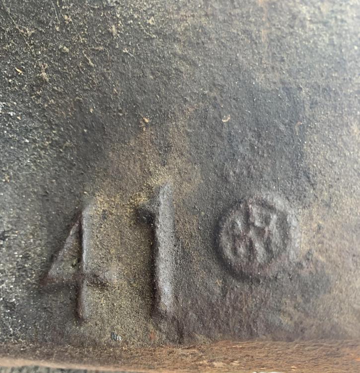

I wouldn't mind cleaning her up a bit more, I saw mention of a vinegar soak and that sounds tempting. I'm not sure I want to buy enough evaporust to soak it in. You can see the number 41 raised on the base under the horn and a symbol next to it. Weight is 202.5 on my scale. Across the front edge of the base I can make out the tops of some numbers- I thought briefly about trying some sandpaper to flatten that with hopes of being able to read it but decided against it for now at least.
I'd appreciate any information and/or advice for cleanup. I'm looking forward to setting her on a suitable stand and moving some steel!
Even though your serial is rather unreadable, I can tell you that your logo stamp style is the last one used in U.S. Production.
That stamp was used from 1939 to the end of CF&I's run in the 1950's.
Try the flour trick on the numbers first.  Also it  looks like they tried to sleeve the hardy to make it fit smaller shank tooling.  You may be able to remove the sleeve with a little work.  I have drop in sleeves I use to make my 1.5" hardy holes fit 1" shank tools---pretty much the most common size here in the USA; though Vulcans tend to run smaller IIRC.

Nice anvil...the top plate looks fantastic.
To clean some of the grime off, try a wire wheel. It will remove junk on the anvil without taking metal off. Wear good PPE, as wire stuck in your face and arms sucks, and breathing rust dust is bad.
You can use Boiled Linseed Oil to slow future rust.
I got the sleeve (I'm using that word very loosely) out and the hardy is 1-1/4" so I'll make some drop-in reducers. Maybe later this evening I'll be able to work on a stand
I like to use square tubing and cut down an inch or so on the diagonals and fold the tabs out  so the hardy tooling actually rests on the tabs rather than the fave of the anvil.
For my 1.5" hardy holes I have a double sleeved insert, cut off two of the tabs opposing on each one so it still rests even on the anvil face.
