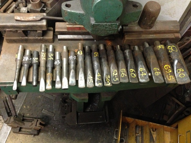

Forgot to say that of course the above punches are for the hydraulic press which has a Ø1.5" chuck. So they do not go straight through like the ones you used. I have made some like that, but if I need a longer slot I tend to do it with two tools, a dedicated slot punch and separate drift. I also refer to these as slot punches as opposed to slit, these punch out a slug whereas my slitting chisels are sharp edged and do not remove any metal, just cut through it. Alan -

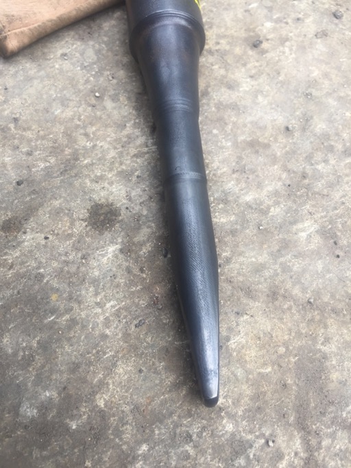

Hi Andrew sorry it took so long, went away for a few days over Easter. Herewith the punch profile I use. The important thing about the punch and drift combination is that the tip width/slot length is the same as the final diameter...you can see the sides of the the punch are parallel top to bottom. Otherwise you cannot get it out! The form of the punch is fairly simple you could make it just by stock removal...I always forge them because it quicker, and then I have the heat for an oil hardening. The tip is radiused in both directions. I normally just make them flat and relieve the corners. The heat/wear of use takes the corners off and radiuses the punch and they become more and more efficient. Having reached the optimum heat conducting profile they do not deform any further. I have explored a number of different transition profiles over the years. Rectangles with rounded ends through ovals and ellipses but the common rule for all of them has been to ensure there are no sharp edges or corners, everything is radiused. In the photo below you can see some of the variations. There are a couple of facetted ones that drifted out to an octagonal hole. The wedge facets have been both flat, convex and concave and soft facetted but makes little difference. So the more recent ones are simple flats. The concave surface does help release the punch on the big punches going through 60mm (2.5") square and up. Alan -

I use a combination slot punch and drift. The long axis length of the slot punch is the same as the final diameter (or long axis if left oval for a handle) of the hole. The width of the punch is a narrow as you can get away with. With Ø3/8" parent bar you really need to to be less than 1/8". I profile the punch end with a tight radius so that it acts as a fuller and spreads the metal to either side without elongating the bar. Thus keeping as much metal either side of the hole as possible and obviating the need to upset. If you wish to pass a larger diameter bar than the parent through the hole you must use a longer punch and allow for the bar to reduce in length. You would make life a lot easier for yourself if you used 3/8" square and then octaganise or round the head and pein after punching the hole. With round bar you need to start off with the bar in a swage, and I quite often create a flat spot with a full faced hammer or punch in order to create a facet for locating/starting the punch. This was a Ø21mm clearance hole through Ø20mm (Ø3/4") 316 SS made with the same proportion of slot punch. Any larger diameter hole and there would be a noticeable wasting of the metal where the hole meets the parent bar. Alan -

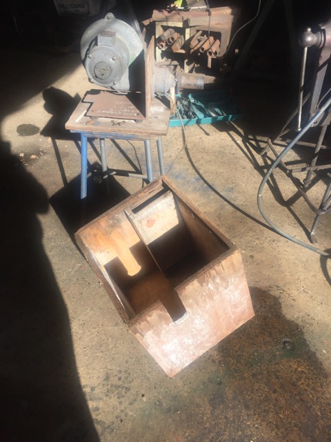

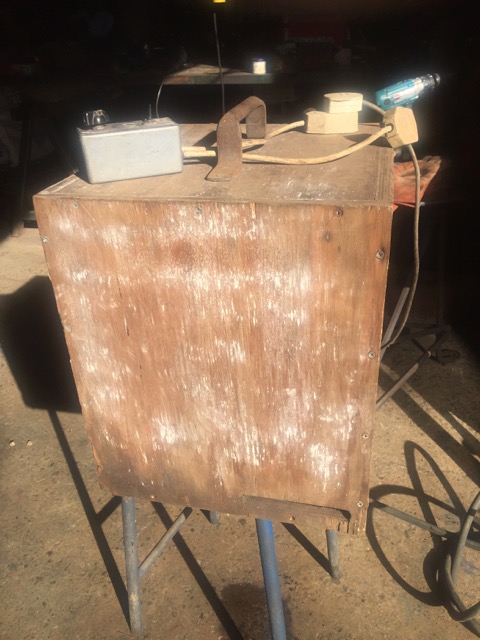

All my fans are in boxes to hush them up a bit. The big one has a 1hp motor and a 24" fan (at a guess) and is quieter than the cooling fan on the MIG welder...mind you that is an old 500 amp beast. I replaced the brushes on the little fan a couple of weeks ago and took some photos of the box with its internal baffle/flue...may be useful for someone... Alan
