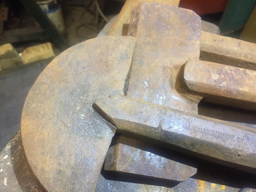

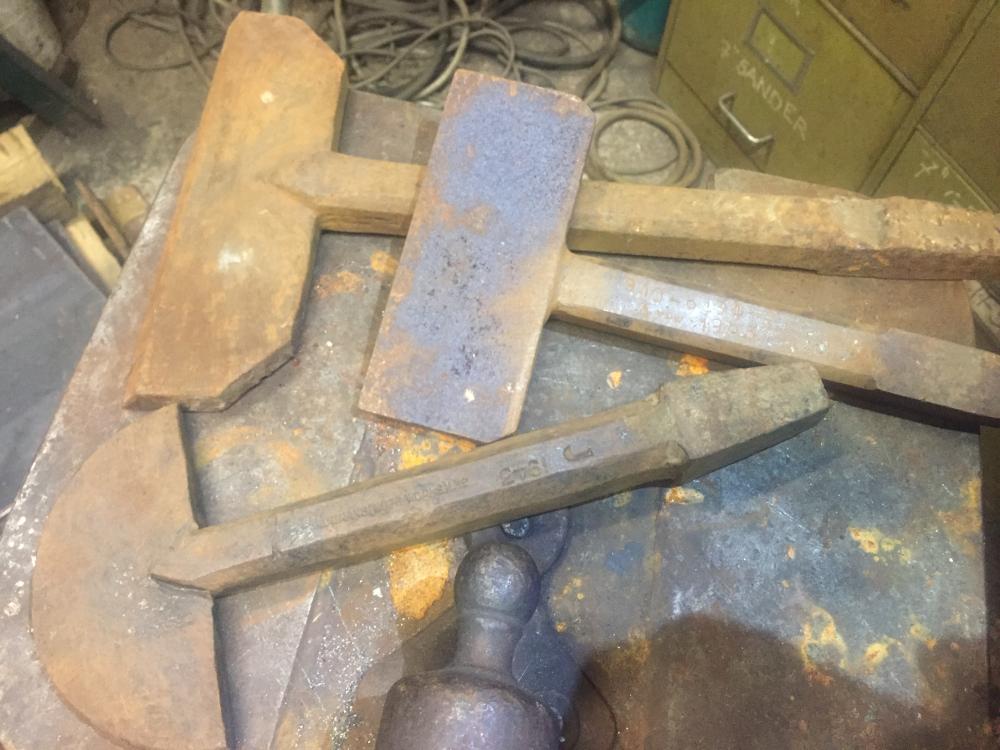

Help identifying what this is??
Alan Evans replied to Little Turtle Forge's topic in Tools, general discussion
Herewith the hatchet stake photos. Dug these out of the pile... Interesting example of living history...showing development of metal production processes. The middle one is stamped 1963 and has been arc welded like Little Turtle Forge's. 20 years before in 1943 (stamped on the half moon stake) the same company Vaughans (Hope Works) were making them by dab welding the post to the blade. The glitches in the surface indicate the posts on the two earlier ones are wrought iron. If you look carefully at the detail photo of the half moon stake you can see the flattened out dab weld on the back of the blade. The two with the stamps are ex Ministery and have the broad arrow. I haven't cleaned the other one up enough but I suspect it was also made by Vaughans for the War Department. It has a very similar dab weld detail as the half moon. The other photo shows the shelf with half a dozen of my father's lathe rests, you can see one of the straight blade ones on the top. Sorry for the photo quality...the lathe and indeed most of dad's workshop is cluttered up with bits of my old Discovery interior trim at the moment. Can't get at anything. Alan -
I will dig out and photograph the hatchet stakes I have when I am next at the forge, I have an idea they were either forged from one piece or fire welded... And a wood lathe tool rest I made for my Dad which I seem to remember was fairly similar in construction...just a curved rest for bowl turning and a round pin instead of square for swivelling and height adjustment in the clamp. Alan -
Looks like a fairly modern one given the arc welded construction. Looks in great shape. https://www.anvils.co.uk/tinsmiths-tools/product/1658-hatchet-stake.html Alan -
