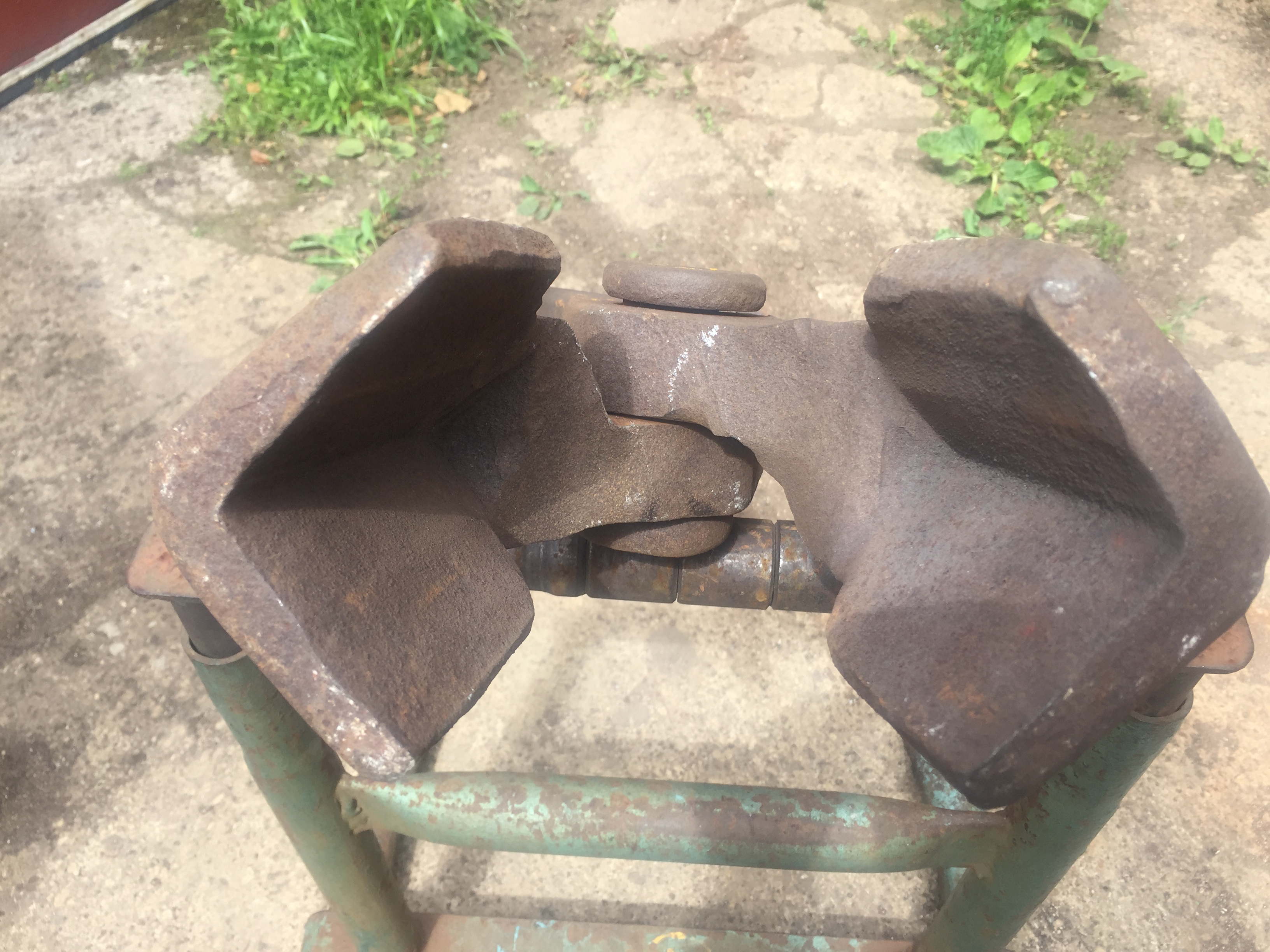

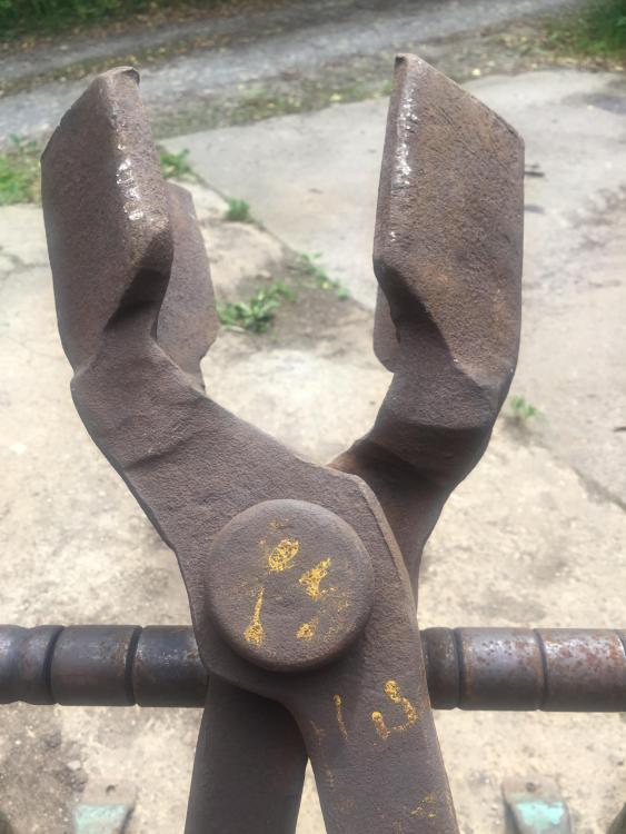

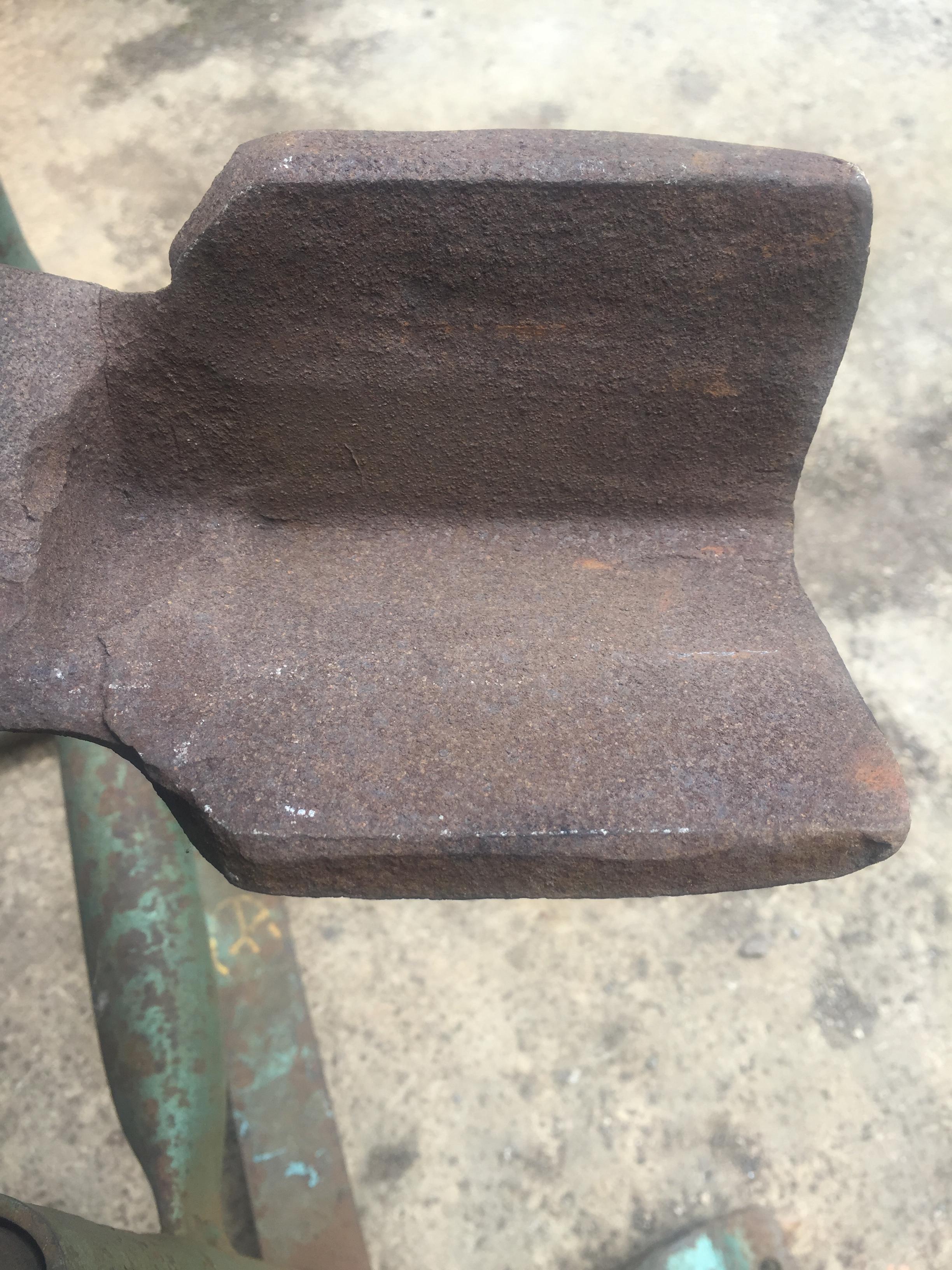

  1. Alan Evans replied to Mberghorn's topic in Tongs

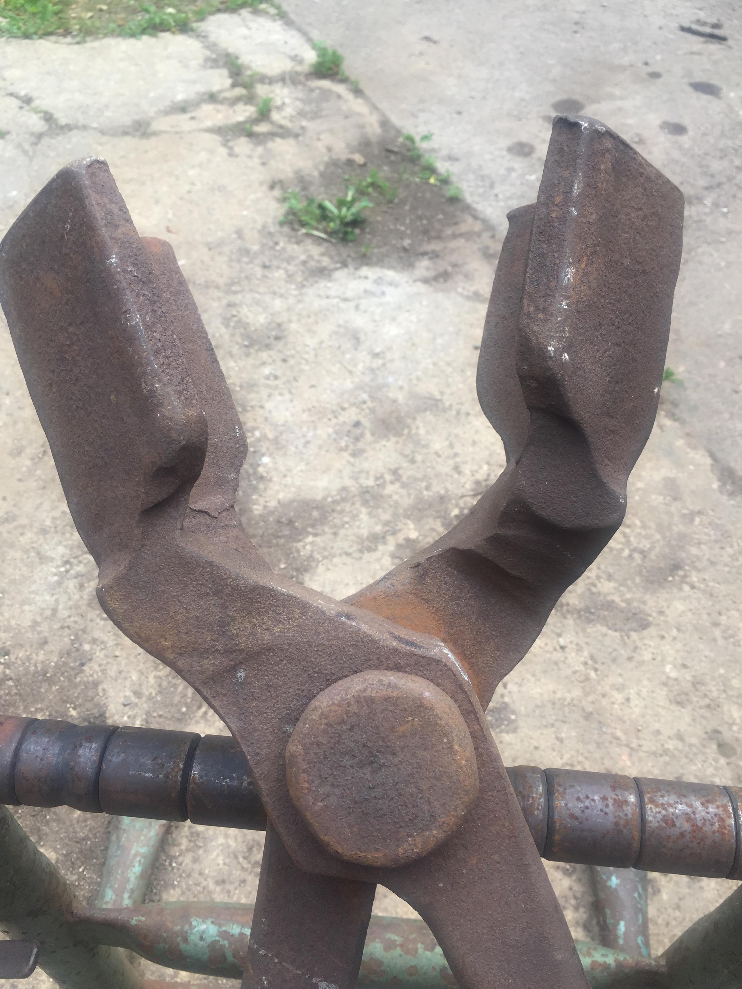

    I did dig them out and measured them up...they are a lot bigger than I remembered! The joint flat measures 1.5" x 3.5" the rectangular section at the base of the Vee jaw is 1.75 x 3.125" Reverse engineering forging going by the tell tales (largely that curved shadow line on the edge between the jaw and joint) it looks like they started out from square section. Forged the joint area down first and then knocked the jaw lump on the end down; dressing back the taper and cleaning up the joint offset. Then tapped the radiused edges of the end lump back to rectangular (forming that curve/shadow line); fullered it out sideways; then used Vee top tool on the anvil to chop the Vee centre in and then put it in between top and bottom Vee tools to form the shape. So allowing for the gain from the punched hole the cross sectional area of the rectangular bits after forging is around 5.25" so I would think it must have been between 2.5" and 2.75" square to start with. Interesting. Anybody analyse it differently? Alan

    @ Wayne My dad always told me that's what sons are for! He gave me the impression his dad had told him. You can tell your son that at least he won't have to push them into the ground as hard as the store bought wooden handled post diggers. Of course lifting them out plus soil will be slightly more problematic, so I would let him find that for himself. I will measure them tomorrow and see if I can figure out what section they started from. You are right, it was certainly around 1.5" Alan

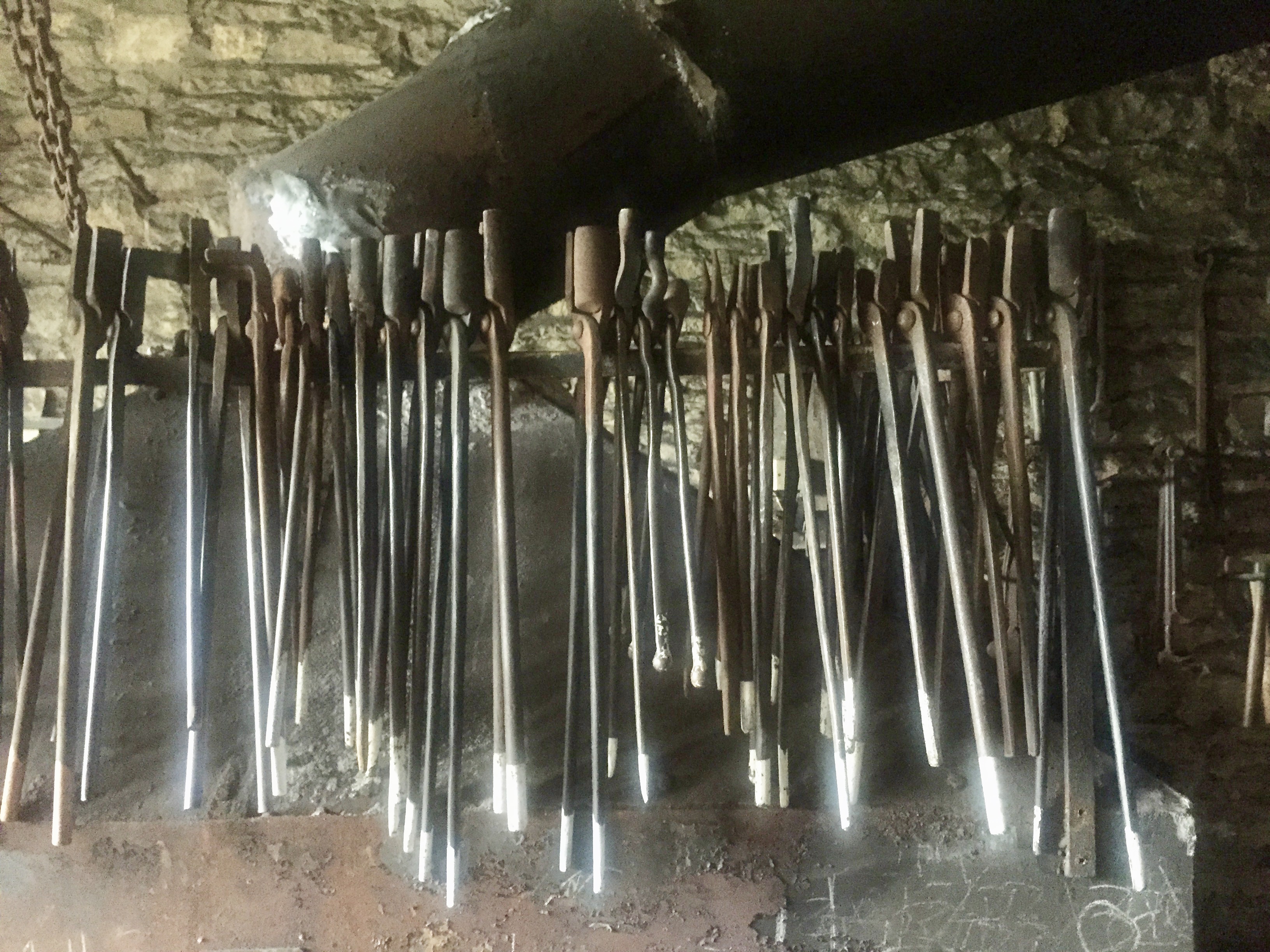

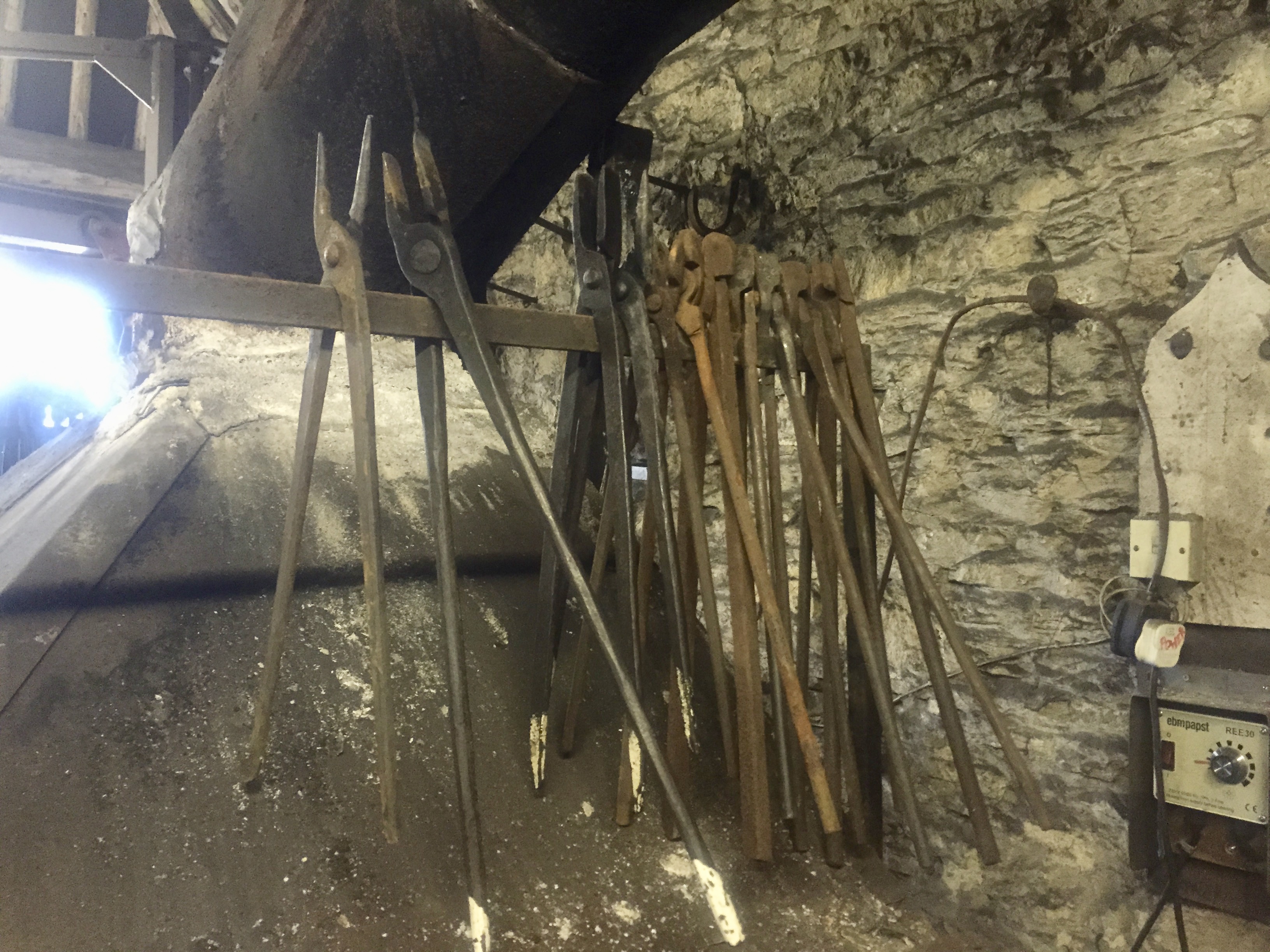

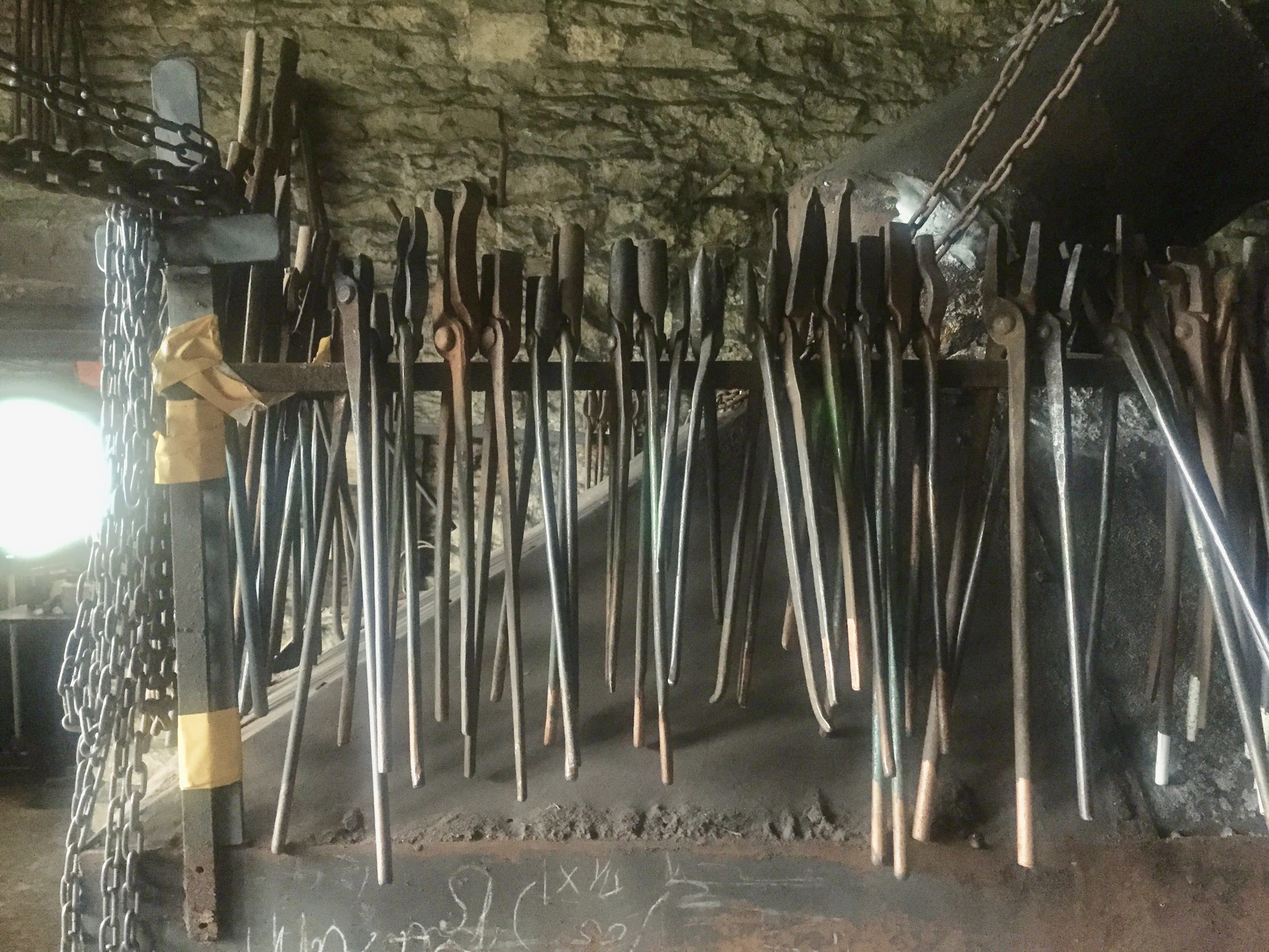

    I beg to differ. When you say "most people" you need to qualify it, unless of course you have evidence to support? Maybe most people on this forum, or most beginner blacksmiths, or most part-time blacksmiths, or most hand-forging blacksmiths. Most of the blacksmiths that I know around the world are full time professionals using power hammers, and tongs that size are definitely everyday. For example, here is my everyday tong rack...on the post on the right foreground are a 3/8" to 3/4" set of Off Centre Forge tongs and some Hofi tongs for size comparison. I presume those are the size you consider normal people use. As I said earlier, I generally hold larger pieces by other means, but these tongs are certainly not just "for decoration". The photos below are of a friend's everyday tong rack...he had a 1cwt hammer and worked smaller section than I. But many are in the same league or larger than the OP. Alan

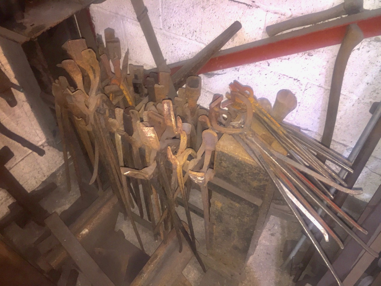

  20. Alan Evans replied to Mberghorn's topic in Tongs

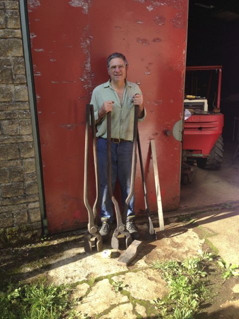

    I use larger tongs than that on a regular basis. I have shown this photograph on here before of some even larger ones than the ones I have made and use, which came from a drop forging factory...beautifully made, worthy of a gallery wall anywhere. The forging on the ground in front of me is from a lump of 80mm (3.125") square and I have tongs for up to 100mm (4") square. But as Thomas has said I often weld a handle on, or forge two or three bits out of one length before cutting in order to use the other pieces as a handle. My larger mouthed tongs are much lighter than the big boys in the photo. I use a hook or porter bar to take the weight between heat source and anvil...the anvil takes the weight thereafter...the tongs and porter bars are then just for manipulation. Clifton Ralph has this nice phrase about tongs just needing to be strong enough to keep you on the end of the workpiece. I do 80% of my forging under a 3CWT hammer, 15% (mainly punching) with hydraulic presses, 4% under either the 1CWT or the 50kG hammer and maybe 1% with a hand hammer, in case you had not realised. Alan
