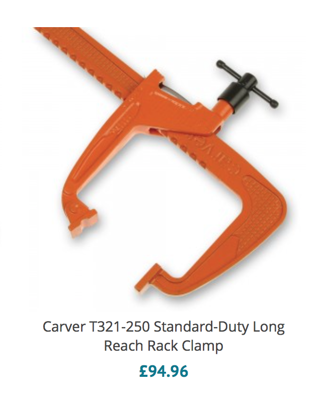

It is a good investment, you will not regret. But I choose my words carefully...investment equals serious money! I have 6 of the slightly longer reach ones than Iron Dwarf posted and couple of the big boys with a straight bar to use for spreading. Alan The Carver Standard-Duty Long Reach Rack Clamps have many uses. The most common include welding, metal fabrication, moulding box and die holding, plate fabrication, plastic and fibreglass moulding and maintenance work. The Carver T321-250 Standard-Duty Long Reach Rack Clamp has the following specifications: Capacity: 250mm (10in). Reach: 120mm (4.3/4in). Overall Length: 360mm (14.1/8in). Clamping Force: 5,650N. Weight: 2.0kg. The standard reach ones like Iron Dwarf's have double the clamping force:- The Carver T186-300 Standard-Duty Rack Clamp has the following specifications: Capacity: 150mm or 294mm Reach: 60mm Overall Length: 245mm or 395mm Clamping Force: 11,300N
Not the table no...they are the orange two piece clamps with the shrouded screw and the notched coarse adjustment. Alan

I tend to use Vise-grips for light stuff, G cramps (C clamps to you!) just for wood work but I invested in a few Carver clamps for serious metal work. Most fabricators use them over here, are they available on your side of the Atlantic? I suggested the straightening beads in case the OP did not have Oxy-Acetylene to hand...but its true...more fun playing with fire! Alan
