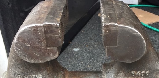

100% agree with trailing edges, but I still find it easier to keep the surface flat with a fresh (trailed) disc! The paint has a more subtle hammer effect that the ones I have seen or used before...must see if it is available over here. We have the Rustoleum brand but not been aware of their hammer finish paints. Be better for smaller objects than the Hammerite brand ones I have had. Alan -

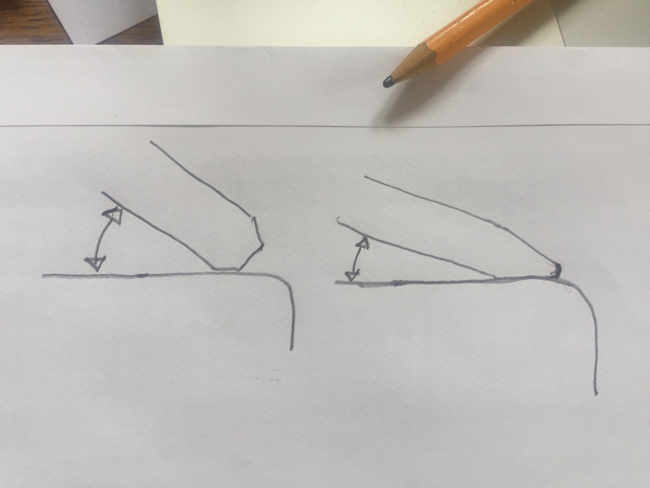

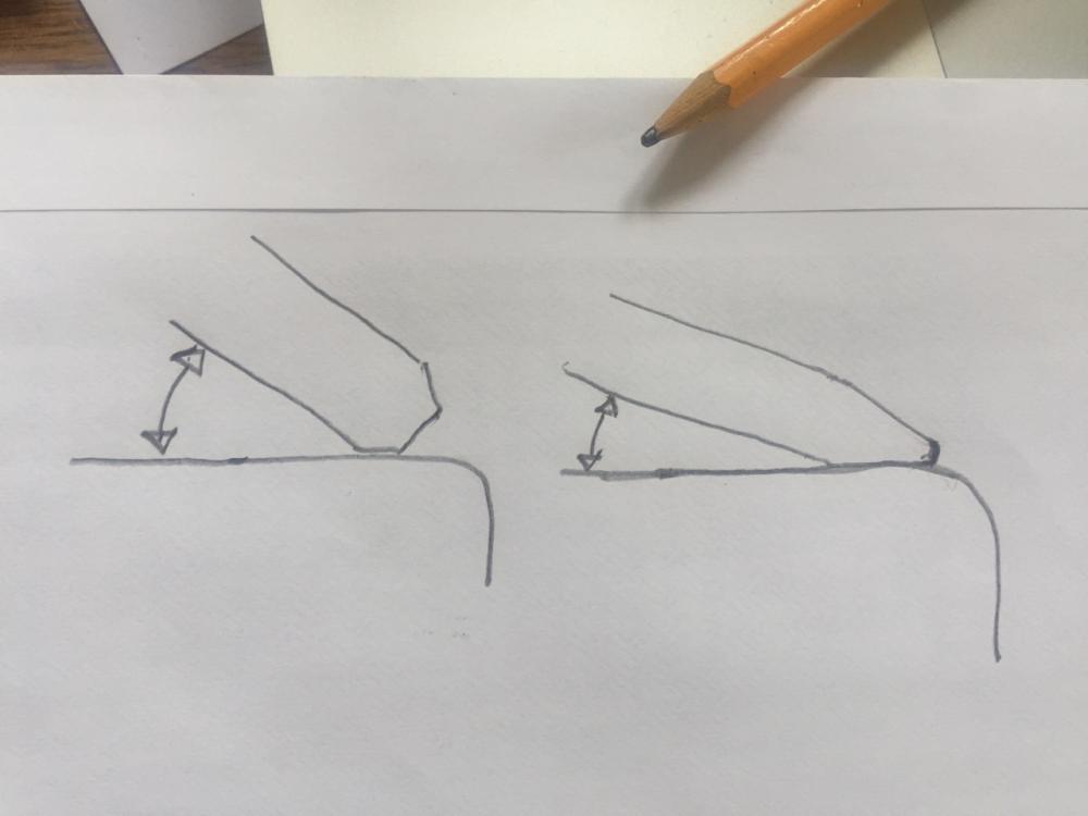

Nice looking vice. What paint did you use? I don't mean this in any negative way because you obviously know exactly what you are doing and what you are aiming for...but your sanding process does illustrate very well what I was trying to say about the difference between the control and the effect of the fresh cut of a new disc and a worn disc under pressure. The "pillowing" or softness around the edges of the frame jaw ends, as indicated by the light reflections on the top edges and shadows below, is typical of the effect of a scotchbrite wheel or a worn sanding disc applied with pressure. The dull disc does not leave a flat surface but "crowns" it because of the pressure which makes it wrap around the job and cut at points of highest pressure...the edges. With a dull disc it is almost impossible to cut evenly and leave flat, the disc (and the physics of pressure with a flexible disc) is in control rather than you. If I was wanting to maintain the flat plane surface of the original jaw end and the crisp joint line with the jaw insert I would have used various grits to remove the marks and a fresh 120 or finer sanding disc (not a flap wheel) as my final process. I would have done this with the inserts in place and the jaws together. If I wanted to lose the resulting arced disc marks, then wet-and-dry wrapped around a baton to leave straight lines. However I would likely use the 120 grit arcs as decoration to mirror or contrast with the curve of the vice frame. Alan -

I 100% agree with the note of caution about tidying up an anvil...and yes it took me many years to get to know some of the uses for the blemishes on mine. And hopefully I will find more in the future. What I 100% disagree with is the premise of using worn cutting tools as some form of safety measure. Especially for beginners. Old hands can make allowances and get away with it but it is not something I would ever advise beginners to do. If your flap disc is too aggressive...use one with a finer grit. A soft edge / broken in flap disc can help blend the ends of the ground area but an overly worn/bevelled/rounded one is very difficult to sense where it is contacting and cutting, again especially for a beginner. I think you have far less control with a worn or dull tool and much more control if you are using a sharp tool/fresh disc because you are not having to push hard to make it work. You can concentrate fully on what effect the tool is doing rather than putting energy into the process. The tool is not under stress nor is the wielder. You are far more likely to make a mistake through over pressure with a worn disc, than a fresh disc used lightly. Alan -

It looks in great shape. If its anything like the one in my brother in law's garage, the mechanics only use it for clonking cold metal and rounding/flaring exhaust pipes by pushing them onto the end of the bick and tapping around. Great work for mushrooming and bruising. Ranchmanben and Marc1, I don't understand your "worn" flap disk description. Unless you mean "broken in"? Either way I don't see the advantage over a new one, they are designed to have a consistent cutting rate until worn out... please explain. Alan -

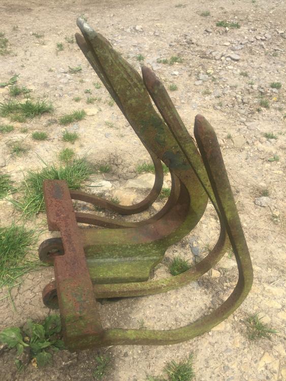

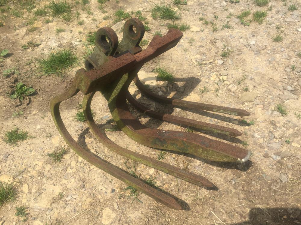

I have just dug this out from the long term storage nettle patch as I happened to be passing by with a strimmer. The main piece is forged from 50mm (2") square mild steel welded to 12mm (1/2") plate. You can see the 312 on the tip has survived unscathed. The little Bobcat X320 is a 1.5 tonne machine with a 3,408lbs bucket crowd and it could not bend the 50mm. As far as I can see your Kubota model has the same size motor but double the kW and has 50% more digging power...but I would still have every confidence in the 50mm square. You could always make a sharks fin shaped blade...In fact I might just put in a hard edged gusset plate in mine for tree roots...and it could double as a mobile log splitter. I already attach my log splitter ram to the dipper auxiliary pipes for firewooding. After use as a trench bottom ripper tooth I added the cross bar and some 20mm (3/4") square mild steel fork tines so I could weed an overgrown chippings heap. At one stage I added some bits of 6mm(1/4") stainless flats to link all the tips together for stone sorting and digging out clay for a pond. Cut them off to revert to weeding again. Every now and then the 20mm tines get snagged and bend but I just use the hydraulics to bend them back. The time consuming part is making the pin plates. Once that is done you can weld any configuration of implement to it and keep modifying it to suit the project... Alan -
