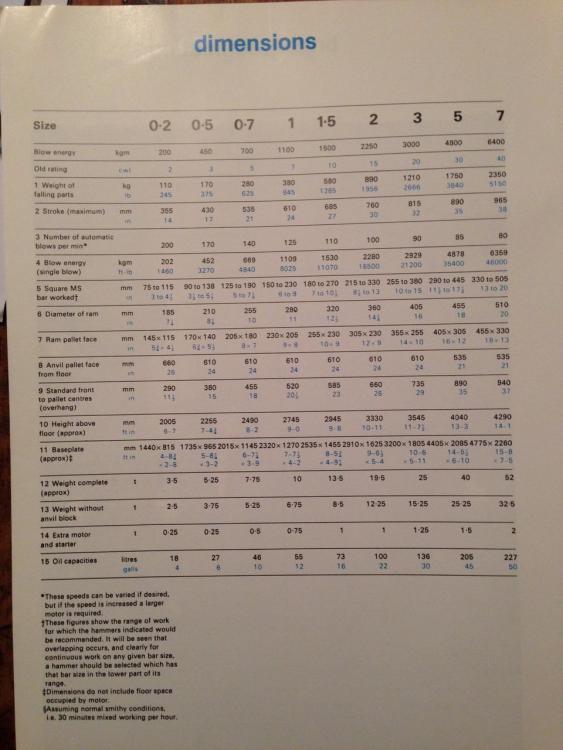

Alan Evans replied to lebenfitz's topic in Power Hammers, Treadle Hammers, Olivers
Grand looking machines, are they running on steam or converted to air? There does not appear to be any lagging on the delivery pipes... Best bet would be to ask John Nicholson of Massey in UK. http://www.masseyforging.com/home.htm The pressure of steam or air acting on the diameter of the piston are the starting point, but only give you the same result as for a hydraulic press. Crucially the length of stroke it accelerates through will have the greatest effect on the effectiveness of the hammer. Perhaps next best bet is to look at the Massey hammer brochure which shows that the 40CWT Clear Space Air Hammer generates a blow energy of 6,400kgm Hope that helps, Alan -

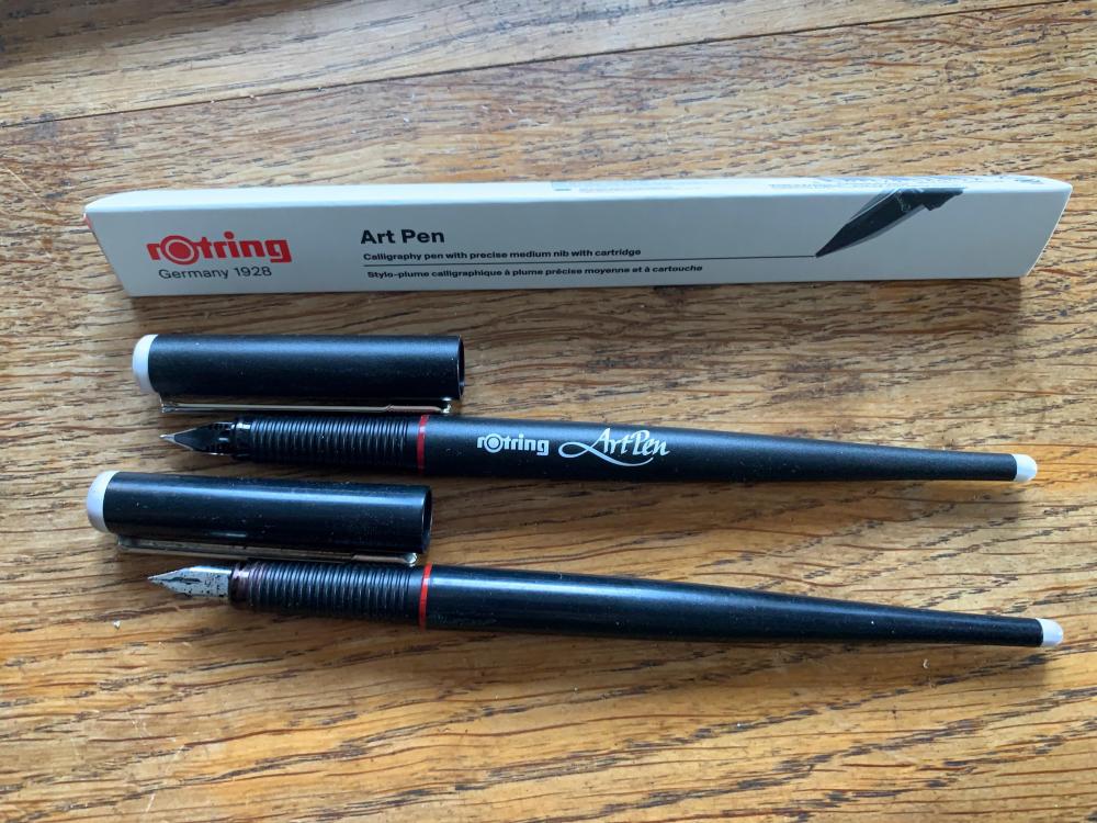

I do most of my drawing (and writing) with a Rotring Fine nib Art Pen...lovely tool. Rotring made the Rapidograph fixed width technical drawing pens I used to use on Permatrace film and paper on the drawing board. Coincidently, I have just this day taken delivery of a new Art Pen from Amazon. My old favourite has logged up over 30 odd years of daily use and is still going strong...I remember having it in 1988 when Buck Rogers set off...I remember that year because I called Snap! to David Petersen's identical Art Pen when he and I attended one of our preliminary meetings with the Welsh Arts Council preparing for the 1989 FIFI conference! Sadly it has developed a split in the cap which means it is not so safe to chuck into my carry bag any more...it is not a dipping system like yours but can use either cartridges, or as I do, a little plunger refillable reservoir. I thoroughly recommend them if you like drawing with ink. Alan -
