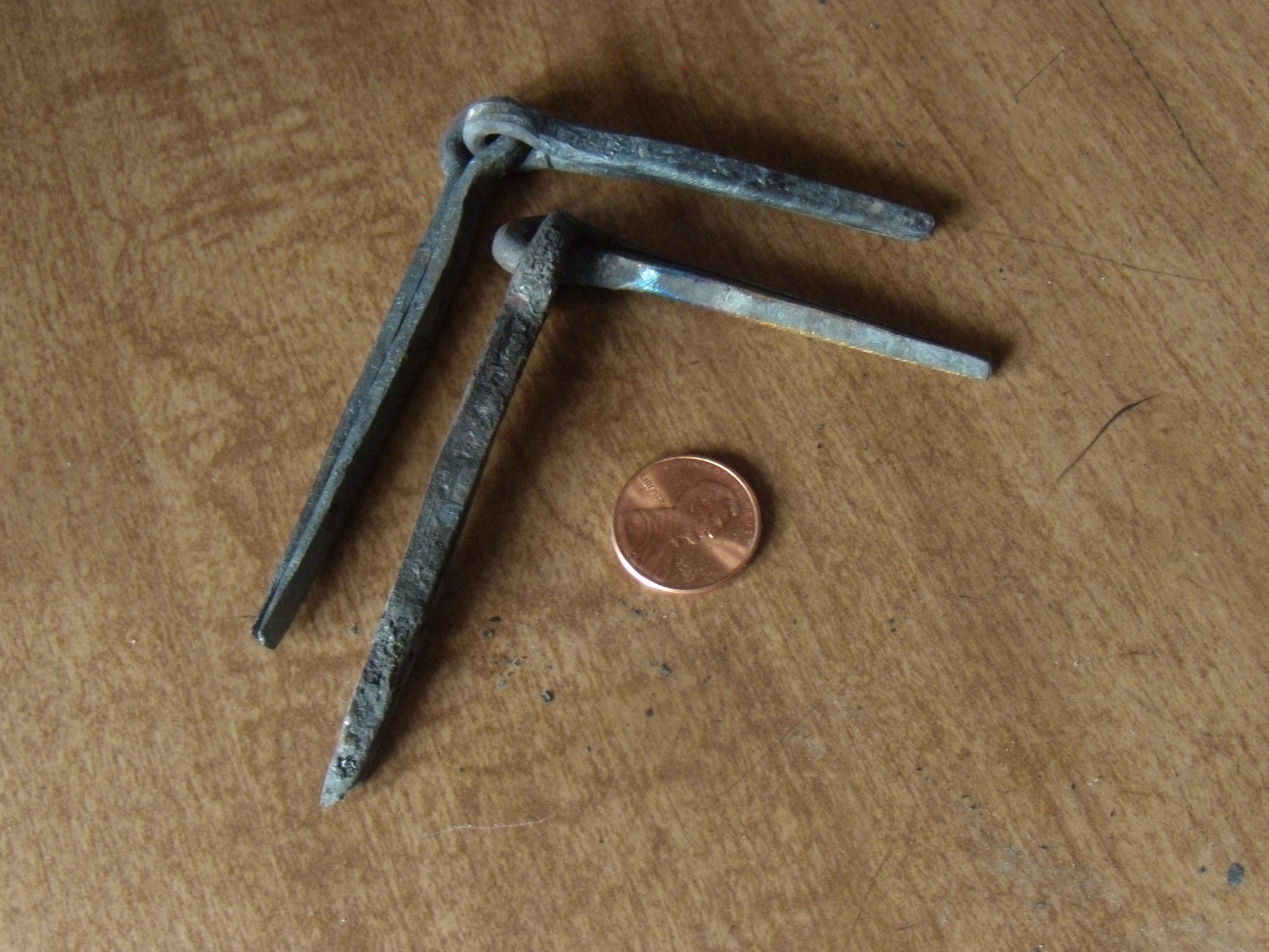

  15. Made a couple of snipe hinges which will go to a chest lid.
