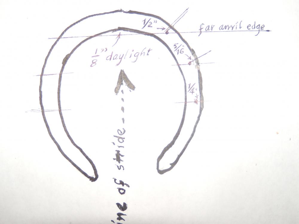

The drawings are a little sloppy. Forgive me. I attended a shoeing school in Oregon in 1964, no longer there. Charles "Dick" Dickenson was the instructor, and his method of laying out six nail holes for a single shoe I share with you. First, you should know that the hoof wall as viewed from the bottom varies in thickness, being thicker at the toe and thinner as it approaches the heel. Immediately inside the hoof wall is some connective tissue called the white line, about 1/8" thick or so. The white line isn't always white; sometimes, it has a yellowish color; sometimes a little red or orange can be noticed. In any event, the nail goes into the white line which is insensitive where the nail enters. As viewed from the bottom, the white line separates the hoof wall from the sole. Dick had us space the nails as shown, because these were usually specimen shoes which were not to be nailed on a live animal. He figured the "average" wall thickness including the white line was 1/2" somewhat near the toe and 1/4" just below the bend of the quarter, the widest part of the foot. The riding horse shoe was normally made of 5/16" x 3/4" stock.
The shoe, when blanked out, could be placed on the anvil with the line of stride parallel to the anvil step. The toe will overhang the far anvil edge leaving 1/8" daylight between the inner aspect of the toe-center and the anvil. When done, the anvil edge will indicate the toe nail layout. Then, coming in 1/2" from the outer border of the shoe somewhat toward the shoe center, you intersect the envisioned anvil line. That's where the toe nail is placed. The heel nail is !/4" in from the outer border of the shoe just a tad toward the heel from the widest part of the shoe. For the middle nail placement, split the difference between toe and heel nail and make it 5/16" in from the outer edge of the shoe.
The hoof has some expansion and contraction, especially in the heel area. It has to do with weight bearing. The expansion occurs with the weight load and the contraction takes place when the hoof is lifted from the ground. A newly pulled used shoe will show small shiny wear patterns near the heel extremities where the hoof wall has been widening and narrowing. This natural occurrence is good for the horse, and the shoer doesn't want to constrict it, so no nails are driven back in the heel area.
I've drawn a shoe blank to show the difference between a front and hind shape. The blank is the hind shape, a little more "pointed" than the front shoe. The front shoe is more full and rounding than the hind shoe.
