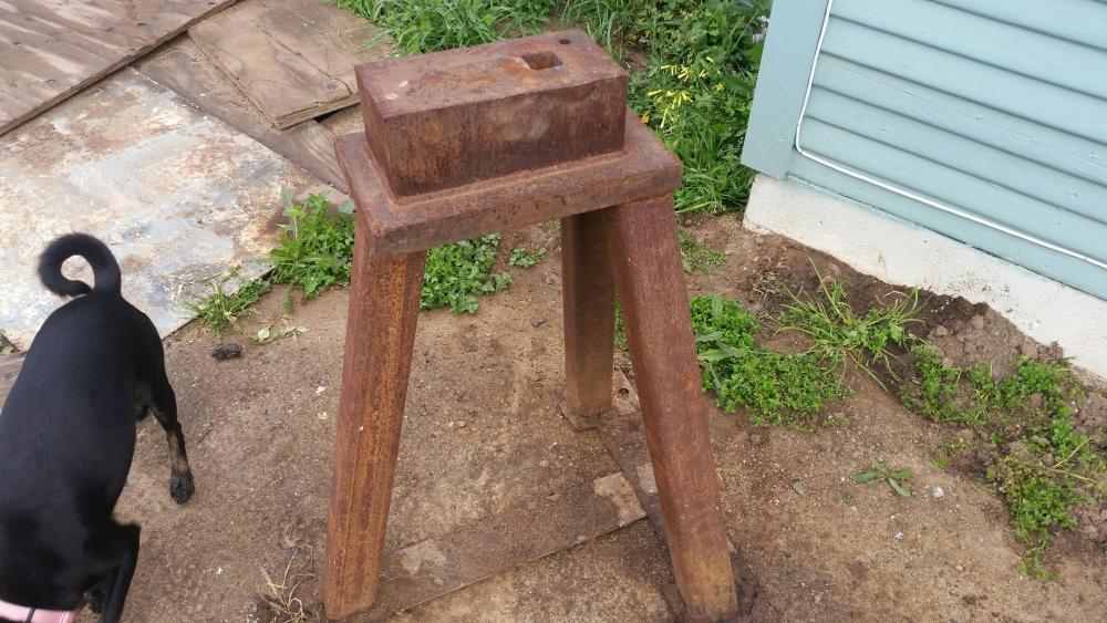

  5. My "Striking anvil" is 9 1/4 inches long by 4 5/8 inches wide and 3 1/2 inches tall. The legs are 2 1/2 by 2 1/2 inches 1/4 inch wall tube steel.
  6. That should work just fine. I came in 2 1/2 inches with my hardy hole. I added a 1 inch thick plate under the striking anvil so I would have room to weld on the tube steel legs. With the wide body you should have room to weld the legs direct to the anvil. I filled the tube steel legs with oil soaked sand per Brian Brazeal method. He said "Striking anvil" Frosty not forging anvil

  11. I built a "Brazeal type" anvil like the one in the picture they work very well with little to invest. Use a cutting torch to rough in the shape and then grind smooth
  12. I doubt if any "Collector" of anvils would paint one tike that. You will spend hours trying to remove that paint and will never really get it all off without sandblasting (That I do not recomend) There could be weld repair under that paint I would use a wire wheel on an angle grinder to check the condition of the face at that price. At $1.00 a pound I would take it as is.
  13. I used a drill press, cutting torch, die grinder and a flat file to make the hardy hole in my striking anvil. Basher- the smaller striking anvils are handy when you want to move them, one man and a hand truck and away you go. Mine weighs around 150 pounds after filling the legs with oil sand. And the mild steel is forgiving for all those late night drunken nail- heading sessions. My anvil had several good dings in it after the midnight madness at the CBA spring conference.
