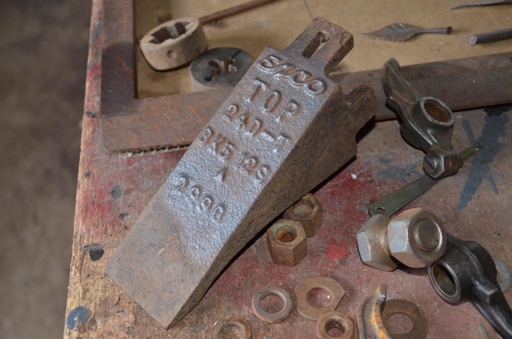

ausfire Posted January 19, 2016 Share Posted January 19, 2016 I was hunting around in the scrap for some sculpture parts when I found a few of these things. They are teeth for a loader bucket or some other earthmover, but I'm thinking they might be a useful hot cut hardie. If I cut the tabs off the bottom and weld on a square section to suit the hardie hole I can't see why it wouldn't work. Would save a lot of forge work. I'm not sure if it's hard faced, tempered or what, so I haven't taken the grinder to the cutting edge yet. A file wants to skid off. Any ideas for a hardie tool or just chuck them back in the scrap? Quote Link to comment Share on other sites More sharing options...
Seek Posted January 19, 2016 Share Posted January 19, 2016 Looks like cast iron. Quote Link to comment Share on other sites More sharing options...
John McPherson Posted January 19, 2016 Share Posted January 19, 2016 More likely cast steel. Give it a good whack with a hammer and see if the lugs break off or just bend. Quote Link to comment Share on other sites More sharing options...
notownkid Posted January 19, 2016 Share Posted January 19, 2016 They are designed to take a beating and keep on ticking, I've certainly put some through some abuse and they didn't break easily. Quote Link to comment Share on other sites More sharing options...
DSW Posted January 19, 2016 Share Posted January 19, 2016 I know a couple people who have use teeth as hot cuts. I have one myself that I have used before I made my hot cut. As mentioned they are cast steel and very tough. Mine is from an excavator and the machine would easily leave tooth marks in solid concrete or stone without any damage to the bucket teeth other than possibly slight wear. Esco makes decent teeth from what I remember. Quote Link to comment Share on other sites More sharing options...
ianinsa Posted January 19, 2016 Share Posted January 19, 2016 That looks unused, probably worth a few bucks to the right guy! So before you duff it stick it on your local equivalent of fleabay! But I'm sure it'll make a good hotcut. Quote Link to comment Share on other sites More sharing options...
ausfire Posted January 19, 2016 Author Share Posted January 19, 2016 I gave those lugs a whack with a hammer and apart from a deafening ring there was no reaction. Would not break or bend. I found a newer file and, with some patience, did manage to file a reasonable edge. I'll cut those lugs off and make a hardie and see how it performs. Quote Link to comment Share on other sites More sharing options...

ironwolfforgeca Posted January 20, 2016 Share Posted January 20, 2016 that is a high carbon cast steel tooth -- you mite get away with 110-18 or better arc rod pre & post heat a must ! weld will want to shrink pulling away from tooth = crack / cool slowly 100% weld they are bolted or pined in I have had to weld them in when tooth bracket is badly worn sooner or later weld gives Quote Link to comment Share on other sites More sharing options...

Frosty Posted January 21, 2016 Share Posted January 21, 2016 Bucket teeth are typically pretty high manganese steel, hard and tough. I doubt any mere human could do anything to it it'd notice. Sharpen it up and see how it works as Jim describes. If you weld a shank to it keep it as cool as possible. Manganese has weird HAZ properties it just doesn't like being kept hot for long. Preheating it is exactly the wrong thing to do IF it is manganese steel. I'd stand it in a bucket of water with the zone being welded just above the surface and weld it fast single pass and let the water draw the heat. Don't quench it though just let the water draw it down. Of course I could be wrong, do it my way and extraterrestrials might come arrest you for abusing one of their sperm. Frosty The Lucky. Quote Link to comment Share on other sites More sharing options...

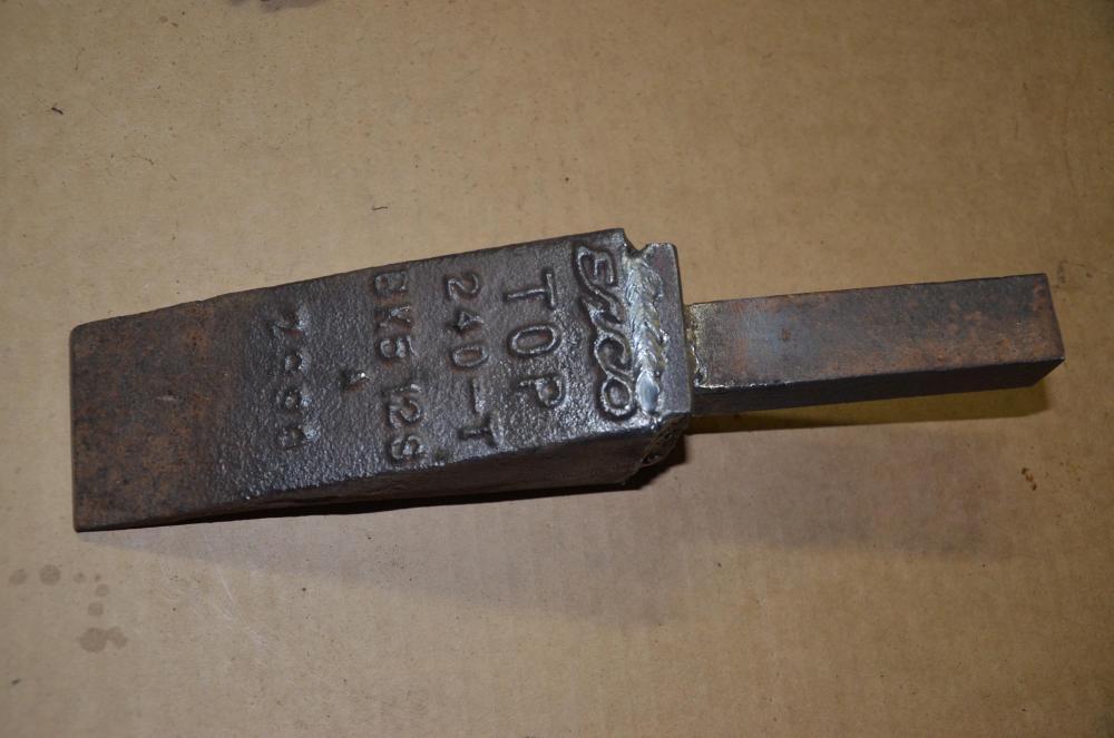

ausfire Posted January 21, 2016 Author Share Posted January 21, 2016 OK, 'tis done and it works fine. I just caught up with the last few posts. Just cut off the lugs and welded on a 3/8 plate and then a 7/8 stem to fit the hardie hole. Not the tidiest of welds but it seemed to penetrate OK and I think it will hold up to anything I'm likely to dish out. I use a hot cut mostly for nails out of 3/8 mild, so it will handle that. Thanks for all the advice. Much appreciated. Here's a pic: Quote Link to comment Share on other sites More sharing options...

ausfire Posted January 24, 2016 Author Share Posted January 24, 2016 Dave, No preheat, stick welder turned up max, Satincraft rods bought from Supacheap Auto. Was going to use the Mig but figured I would save the gas and burn up a few old rods. Quote Link to comment Share on other sites More sharing options...
arkie Posted January 24, 2016 Share Posted January 24, 2016 ausfire, nice job on the hardie. Just curious, if you were able to weld the plate on first, then the bar, why not just weld the square bar directly to the tooth and skip welding on the plate? Quote Link to comment Share on other sites More sharing options...
