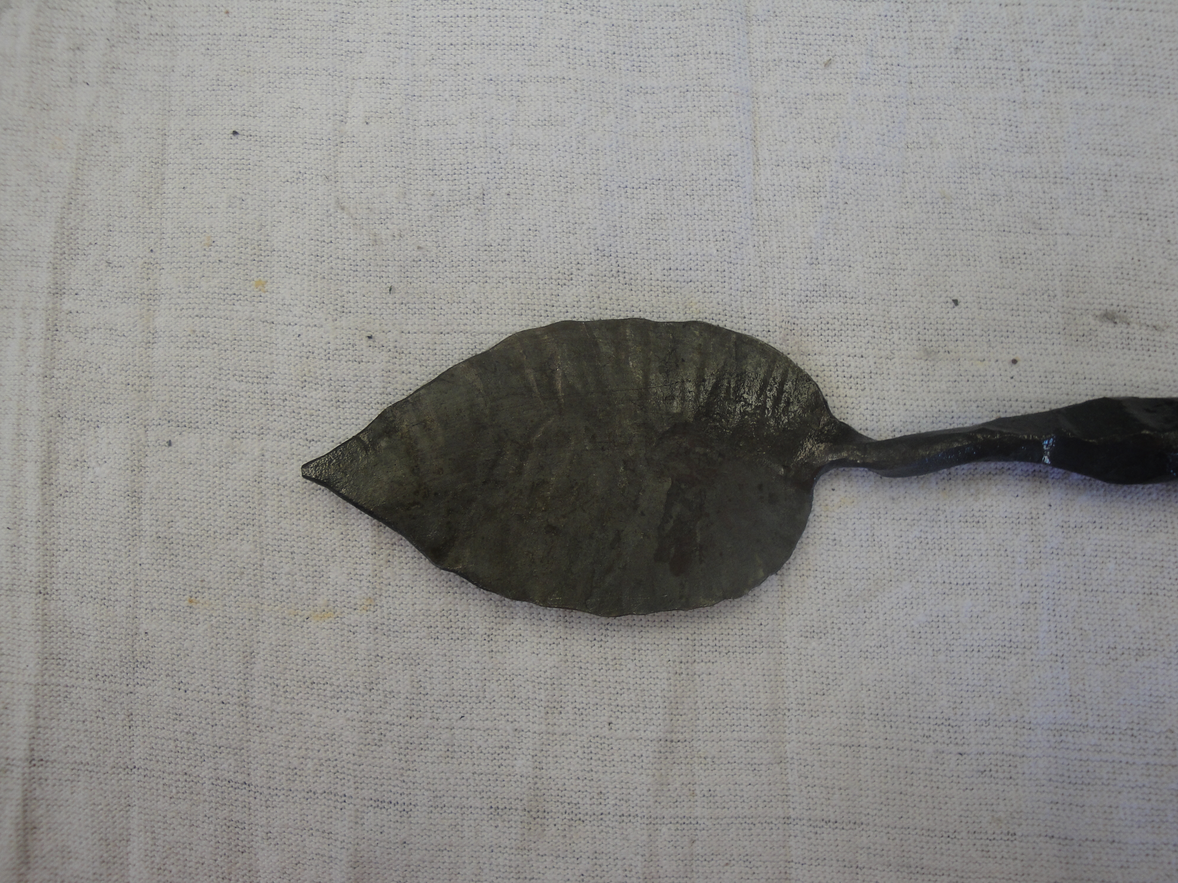

  5. I made this leaf yesterday and used my rounding hammer only. I use the rounded or curved side of the hammer to spread the leaf sections. I'm learning to use all the aspects of or sides of a hammer. On to the Gingko leaf.
  6. Off the subject a little but to welding in a gas forge. I've watched Craig Trnka, a top farrier, video and he has one with him welding some steel stock with out much trouble. He used Iron Mountain Flux and didn't smother it in flux. I notice he didn't use a heavy hammer either. Most likely a 2 lb er. He did scarf the two ends. Watching many of his video's he does a lot of horseshoe forge welding in a coal forge. I am not sure of the carbon content of horseshoes. Good luck
  7. I will try to get a photo in the next few days as I ran out of propane yesterday. I agree that the shape is important and found that I was making the point to long. By doing that, I didn't have enough material left to move it around and spread out the leaf.
  8. I stopped working on the cottonwood leaves for a little while. Sometimes it good to step away. I tried another one today with more success. I didn't finish the one below with veins and the entire shape of the leaf wasn't finished but I think I got the stem/leaf transition area near or below where the stem transitions to the leaf. The difference was that I use my rounding hammer and not the cross pein. I use my rounding hammer most of the time and feel more comfortable using it. Jeremy K suggested that idea and when I tried it, I found it worked better than the cross pein. The cross pein seemed like the practical, mechanical, way to go, but I never could get the metal to move the way I wanted. So, I tried the rounding hammer and success.

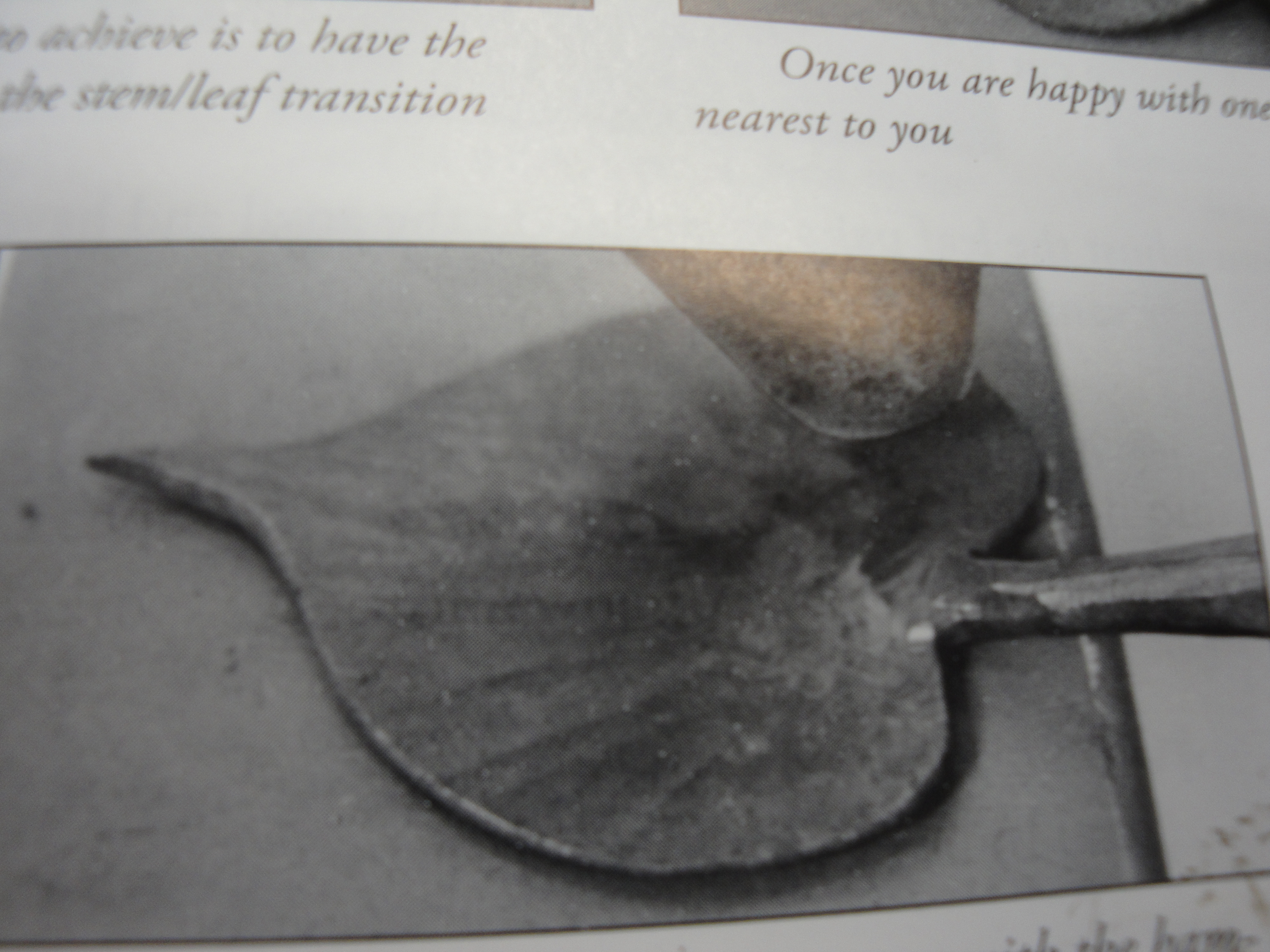

  16. I am working on my blacksmithing leaf phase and ran into a problem with the cottonwood leaf. I've been following the Mark Aspery Vol 2 process of forging a cottonwood leaf. I have not been able to get enough material spread on either side of the stem and down towards the stem area. The leaf is actually supposed to spread out below the stem like the picture. I seem to run out of material to move down to the stem area. Picture the Aspery leaf and my leaf. Any suggestion on how to do this? Sorry about the picture size but I couldn't see how to make them smaller.
