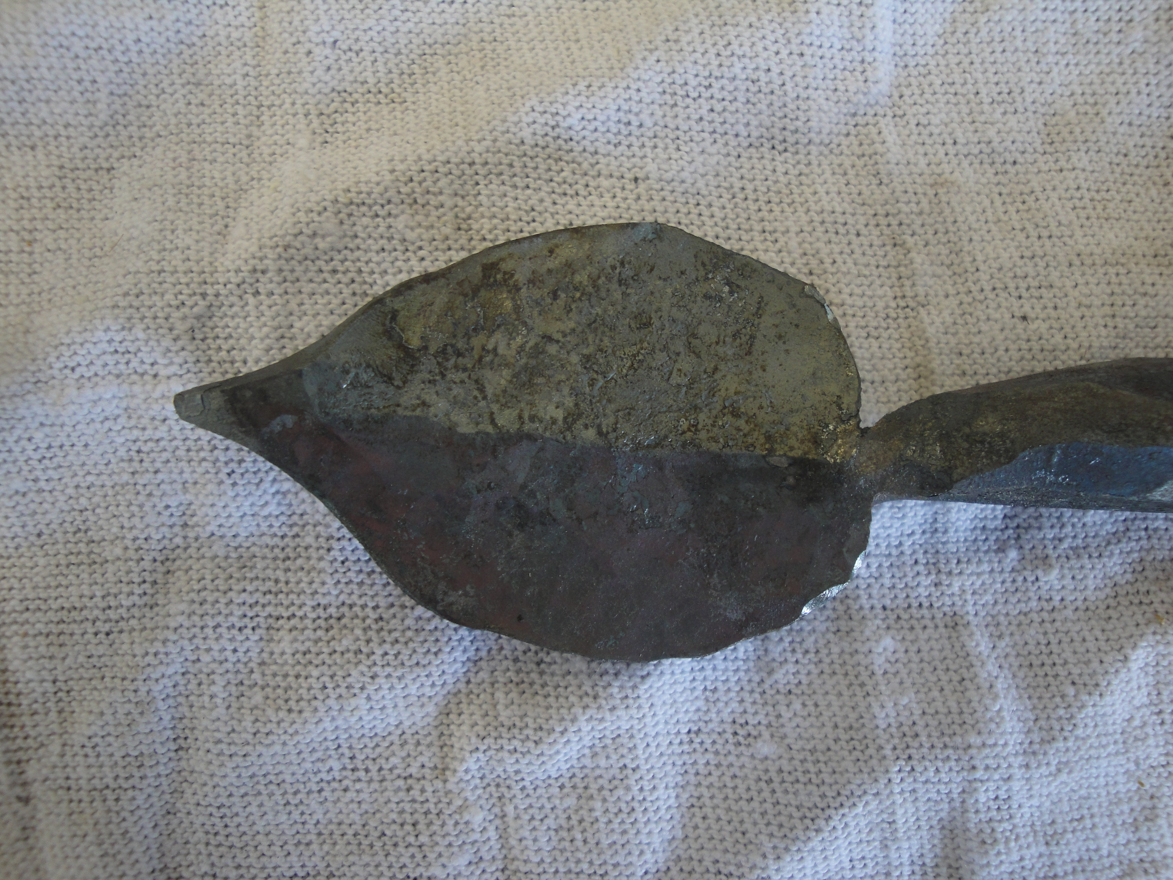

  5. I made this leaf yesterday and used my rounding hammer only. I use the rounded or curved side of the hammer to spread the leaf sections. I'm learning to use all the aspects of or sides of a hammer. On to the Gingko leaf.

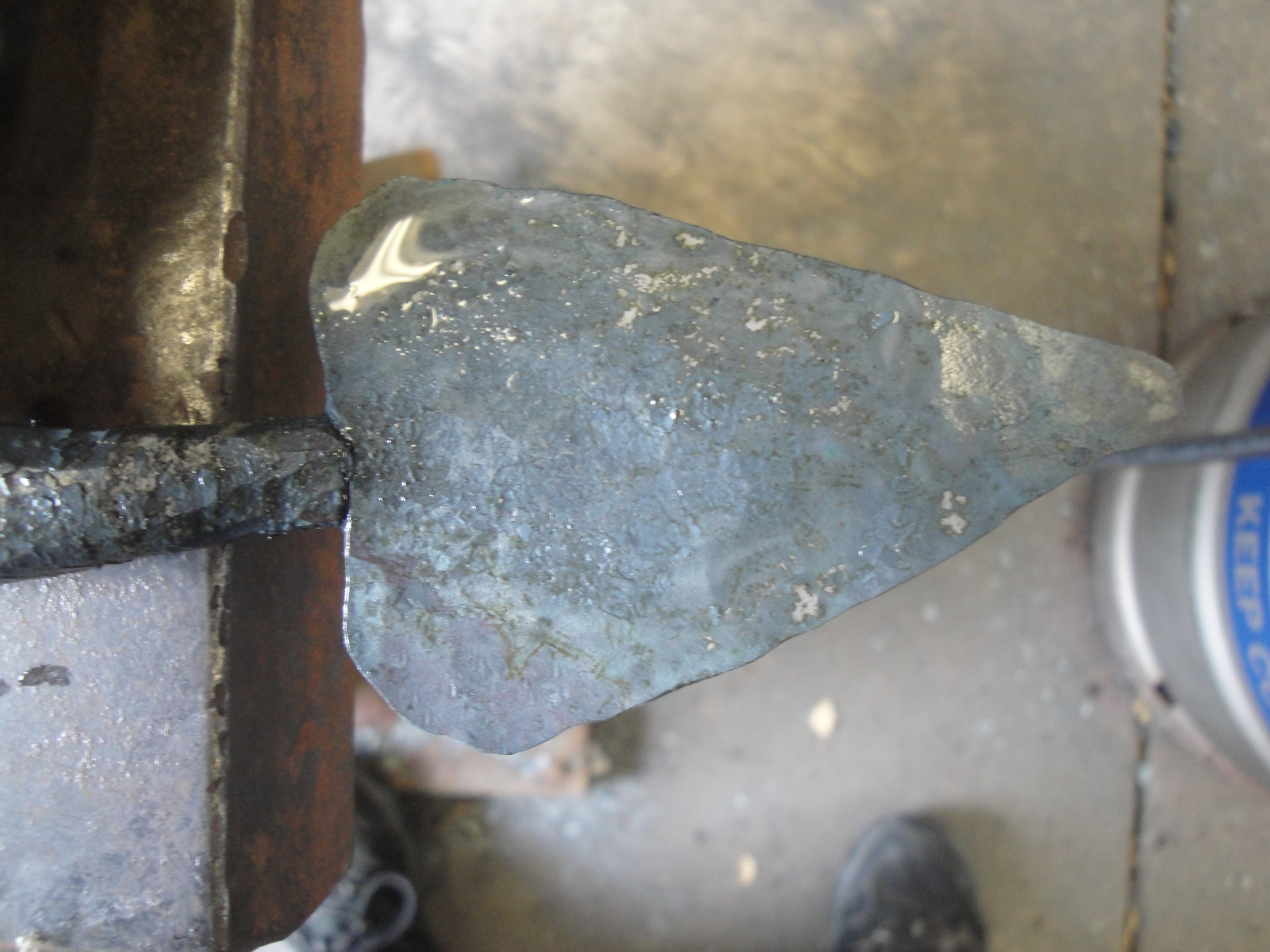

  7. I will try to get a photo in the next few days as I ran out of propane yesterday. I agree that the shape is important and found that I was making the point to long. By doing that, I didn't have enough material left to move it around and spread out the leaf.
  8. I stopped working on the cottonwood leaves for a little while. Sometimes it good to step away. I tried another one today with more success. I didn't finish the one below with veins and the entire shape of the leaf wasn't finished but I think I got the stem/leaf transition area near or below where the stem transitions to the leaf. The difference was that I use my rounding hammer and not the cross pein. I use my rounding hammer most of the time and feel more comfortable using it. Jeremy K suggested that idea and when I tried it, I found it worked better than the cross pein. The cross pein seemed like the practical, mechanical, way to go, but I never could get the metal to move the way I wanted. So, I tried the rounding hammer and success.

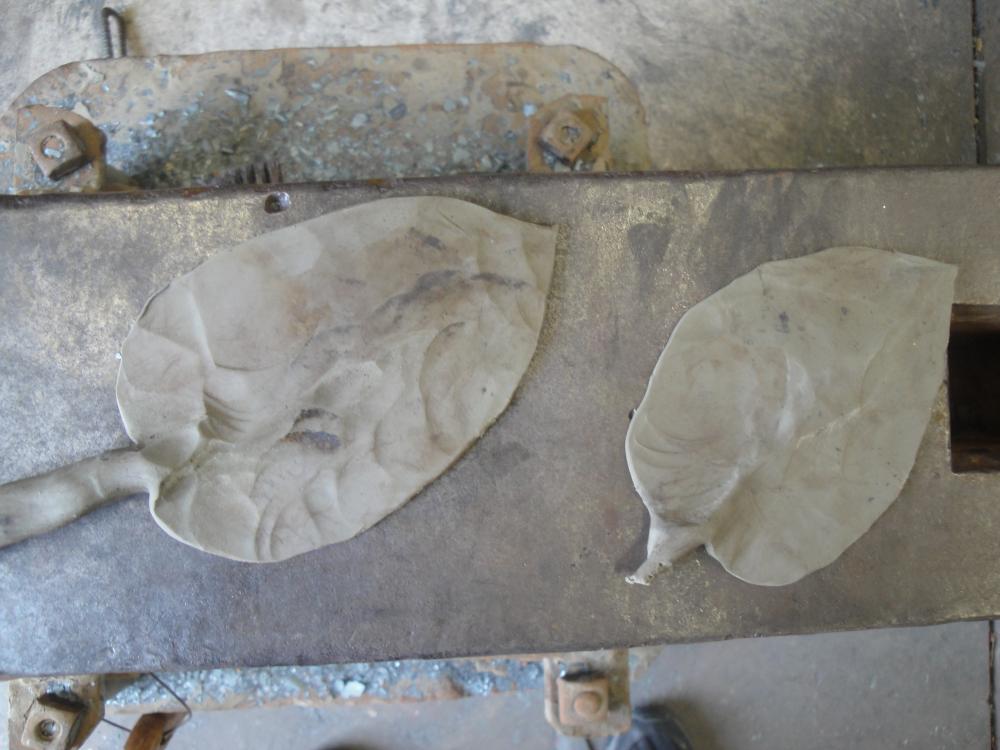

  14. I did two things today. First, I worked in clay and could concentrate on my hammer blows. Second, I didn't flatten the stock as much as before and that did leave me more material to move around. Now, I haven't worked it with steel yet, and I plan on working with the clay a few more times. Photos of clay leaves.
