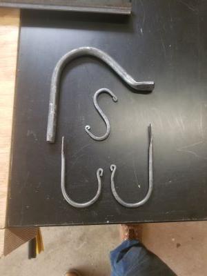

Well, my journey has officially started. Anvil (check), Vise (check), Hammers (check) and Forge (check).
The weeks long journey to get the equipment to get up and running is over and i fired up the forge for the first time today.
It was more difficult than i had imagined, seeing the color of the steel in the forge in the hazy sunlight, gripping the steel with an old pair of pliers and actually working the steel were all challenging. I did not let that stop me i just kept going. i wasnt out there long i just wanted to try. i made a couple things and that made me happy. i learned a little today made a few mistakes many of which i  am sure i will make again. But i did it ! So here is what i made today, be kind, they are by no means perfect or good for that matter but they look like what i was supposed to be making so ill take that as a win.

Next S hook, put the pig tails to the outside of the loop.  Then compare the two and see which you like best.  Pig tails to the outside leave the entire loop open and can not catch on things going in or out of the loop.  Make a variety of lengths of the S hooks as some projects like a longer space between loops.  Make a S hook but also make a C hook and a J hook as all come in handy for different reasons.
On the single loop hooks, arrange them back to back so you can hang things from either side, like when you want to day herbs, straw flowers, and etc.
Great start !!  Add something new with each fire.
Wow, after you said it I noticed the pigtail, yes it seems to be going the wrong way, one of the many errors, if you hadn't said anything I probably would not have noticed and continued to make them that way. Noted and will try to remeber for the next ones.
You are off to a good start, the anvil hold down looks very good and the J hooks the pigtail is right. Can't tell ya how many S hooks I made like yours, sometimes I think I'm a little dyslexic when bending things backwards. It's all good practice, practice, practice  though.

In general most uses of s hooks are better with the finial loop out. But hey, it is a safety hook so things don't blow off in a breeze.

Next fire make an S hook with one loop as before, but the second loop say 3 or 4 inches diameter.  The large end is nice for over a tree limb etc.  Makes hanging a basket of flowers from a tree limb easy.
Nice thing about working metal is you can reheat the pig tail and fix things, either by straightening the pig tail out and reforming it in the other direction, or grabbing the pig tail with a pair of pliers and giving the pig tail a twist to the other direction.  It does not have to be done the hard way, it just needs done.

Those are some great looking hooks for someone just starting out. Great work! Also, your pigtails aren't going the "wrong" way unless you intended them to go the other way ;)
