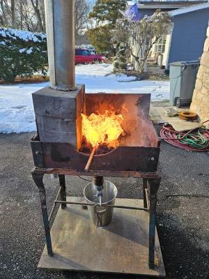

Yes gettting the feel for time, ill learn. Was only the 1st full day of actually working in the fire. Did ok with 3/8 or better stock but not so much in 1/4 for some s hooks to hang the tools off the forge. Could turn my back for a minute with little propane not so much with this. Its more interactive.

Ha, yeah fire control... thats the next mission. I prolly wont be modifing this forge again i will just learn on it. I have ideas for the next one but will save that for down the line, let me get used to this one so can can not melt thinner material in 30 seconds. Not so much worried about bigger more worried about firepot maintanece, and that i am afraid is something i just have to work at. If i can keep it clean and full of fuel the fire itself is plenty big enough for what i need at the moment

hi Again, I moved the blower and switch to the side and it makes it much easier to control and remember to turn it off. i can not believe how much hotter it is than my little mr volcano propane forge. i burnt the tip off many a taper today i am sure ill get the hang of it eventually. i am definitely enjoying the coal forging process and looking forward to getting a proper set up. made some small forge tools today have yet to "finish" them but all the forging done on them poker rake and water can holder ill post pics of them on my other thread ill leave this one to the forge as to stay on topic. the hood seems to work ,poorly but draws, not to worried about that as i will be upgrading that as well when i upsize to a more proper forge. For now my main concern is the small size of my "firepot" it seems to get blocked easily and requires constant attention thus why i made the forge tools 1st. but for what it is i am happy and gives me a good 1st taste of coal forging. thank you all again for everyones input / suggestions you all did not let me down.
Makeshift solid fuel forge
Yeah i must admit i didnt put much thought into the layout of controls and such basically put everything where the previous owner had them not to mention i was exceited to get her fired up. If i move the blower to the right side of forge then i can move the switch to that side as well putting it into my line of sight. The previous owner had an extention cord with a slide dimmer on it that he kept close by. I really appreciate everyones input
And wha-la i got her fired up did not have much time to play was almost time to start the grill for the steaks for dinner so will make the needed tools tomorrow the next day i dont know. i am pretty sure the hood is undersized but its what would fit in the forge probable better to do with out .. to be determined 1st impression a lot harder to get started than my propane forge but once up and going man its hot. i kept forgetting to turn off the blower when going to the anvil that i am sure will come with time. i ll watch some more coal forge videos on you tube but most just skip tru the fire and go right to the hammering.

Added a intake "gate" to the blower along with a switch this morning. Again this is just to see if i cant forge with solid fuel this by no means is intended to be a permanent set up. the intake "gate" is functional all the way open blows paper out of the "pot" all the way closed it barely dances the paper. the hood is next i am going to try and make something out of the old hood parts and what ever else i have stashed in my garage. as i will be pulling this in and out og the garage for use i need to make it removable and then secure when in use this should be fun.
