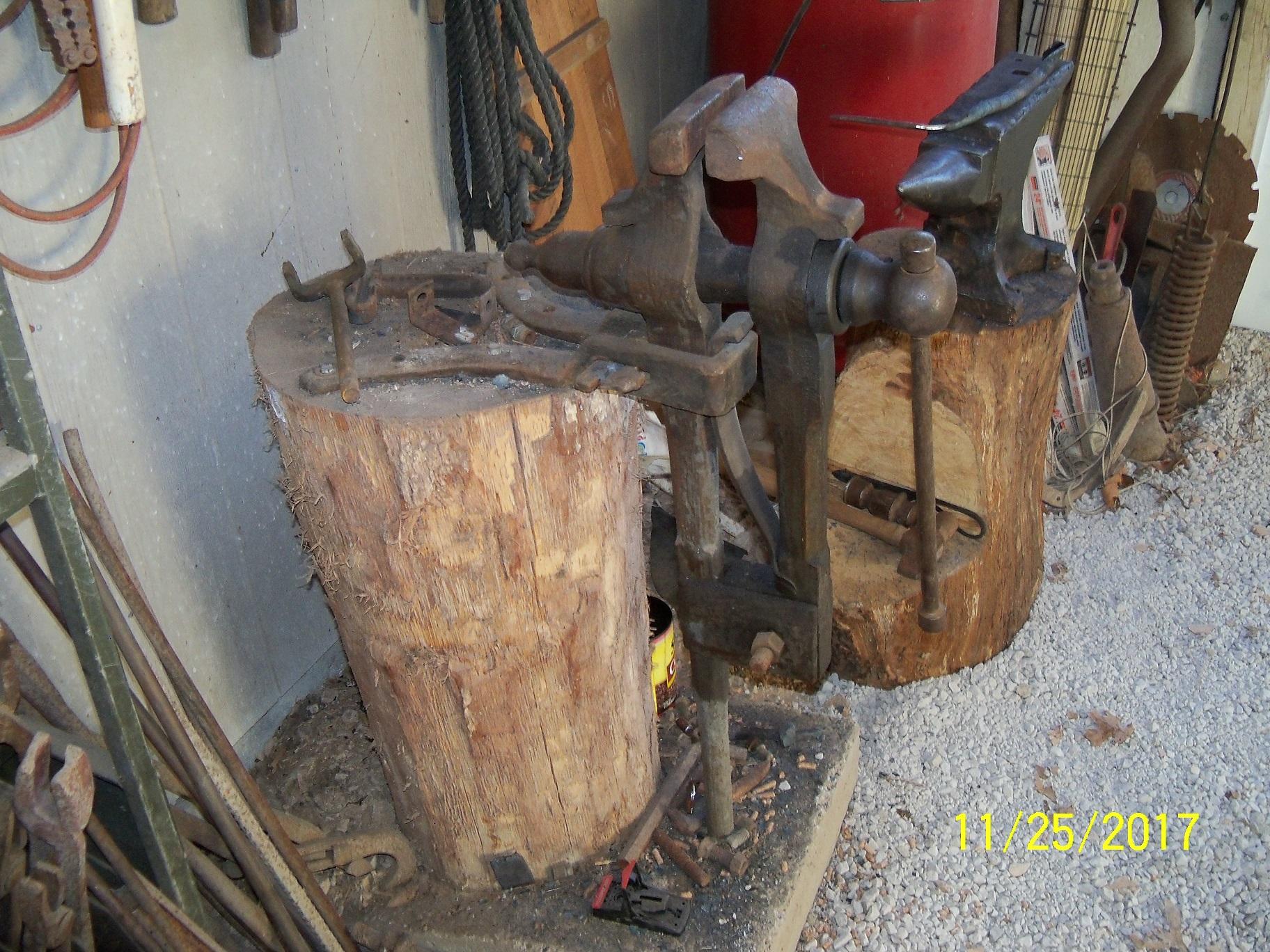

A lock, wegde and spring would get that vise working a lot better. They can be made fairly easily.

10 hours ago, Chip McCoy said:
the 6" vise
That is what is called a Blacksmith leg or post vise. The leg is usually set on the floor with the acorn anchored in a plate with a hole in it which prevents the vise from twisting and allows for heavy hammering on work pieces. There is a section on vises and there are many pictures of the locking wedge's and spring Daswulf referred to. Here are a couple of pictures of our leg vise wedges and another clamped in it I was restoring, making the spring.
Edited by Irondragon ForgeClay Works
add pictures
Chip:  The reason a post vice has a leg is that you can pound on something in the vice and the impact is carried down through post to the floor.  This makes it more solid than one just mounted on a bench where the impact would be absorbed by the bench and perhaps give a bounce back.  My post vice would be too short for me if the bottom of the leg was on the floor.  So, I have a length of 4x4 mounted between the floor and the bottom of the leg.
