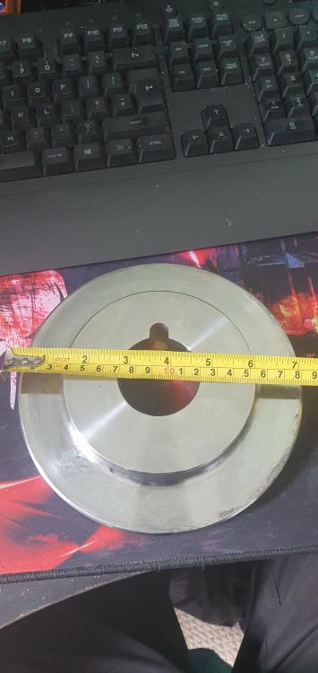

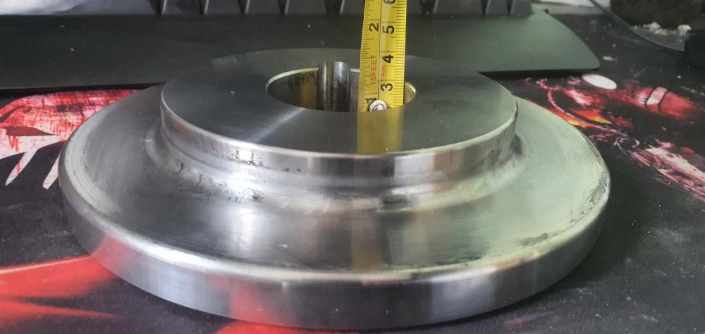

I was asked at work to harden EN24t its a part for a rolling mashine that another worker milled out . there is 6x in total they were using these already but decided they want to get them harder, so they can last longer.
Could you give me advice how to harden it?
(I am using a gas forge for this) from topic (problem with forge. Welding temp)
I would heat the steel to 820/850°C how long i should keep in in the forge for?
do i just quench in any oil? or sould i use something specific
then the tempering : what temperature sould i temper it? or should i temper it at all? these wheels are used in rolling mashine for rolling a 60/40mm mild steel box section 3mm thick
thank you guys for any advice.

At our facility, we have very specific requirements for roll form wheels. Not my area, so I don’t know the specifics, but they are all hardened and most have additional surface treatment. In the past the surface treatment was TD coating (high temperature thermal diffusion of Vanadium Carbide into the surface layer, produces a very high surface hardness, but the polishing operation is very critical to longevity.) I can’t really offer much more, but to get really good life out of roll wheels, they really need to be looking at a professional service. While expensive, the return on investment is quite significant.

EN24 is a very high strength steel alloy which is supplied hardened and tempered. The grade is a nickel chromium molybdenum combination - this offers high tensile steel strength, with good ductility and wear resistance characteristics.
EN24 is a very popular grade of through-hardening alloy steel, which is readily machinable in the “T” condition. (Refer to our machinability guide). EN24T is most suitable for the manufacture of parts such as heavy-duty axles and shafts, gears, bolts and studs.  EN24T can be further surface-hardened typically to 58-60 HRC by induction or nitride processes, producing components with enhanced wear resistance.
