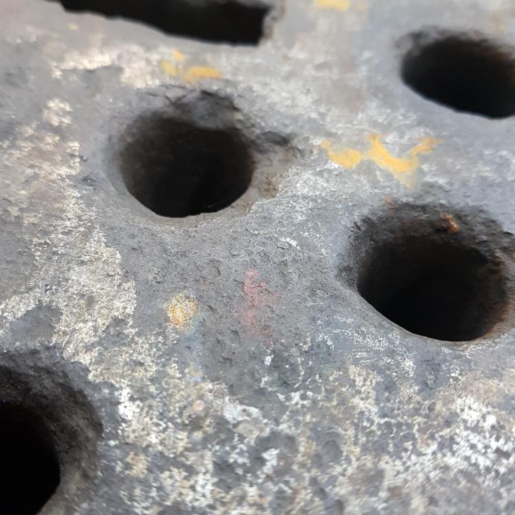

So it took me some time but finally here are the pictures as promised... hope you can see the chipped edges... The swageblock thickness is about 10cm a little bit less than 4 inches. If the milling idea comes up once more I would mill of 3/8" or so...

Yes that's an other idea. Don't touch the swageblock, and use it for rough work. If it must be perfect then use a custom made bolster plate with nice clean rounded edges... Thanks Thomas
