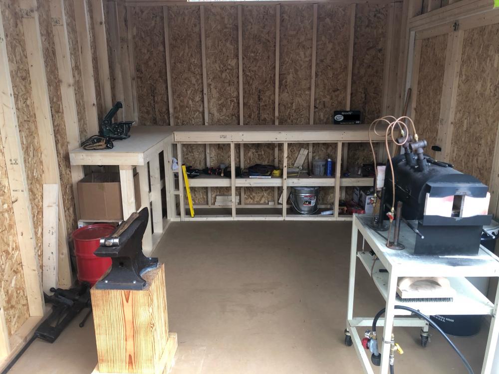

  1. Cutting a hole would likely be the best solution practically, but it's also quite permanent. In the event that I don't bring this shed if we move, the new owner likely wouldn't see the use in it haha. At present I have a few concrete blocks leveled out underneath where the anvil sits and I have a wide deck jack bridging the gap. The improvement is actually quite decent, definitely better than I expected, but I'll be curious to see how it holds up to repeated abuse. It's fairly easy to access the underside to check though. If it ends up failing I'll probably end up using some cribbing.
  2. Hi everyone, I moved about a year ago for work and initially lived in an apartment without much room for forging. This past summer I finally was able to move into a house with enough room for a small shed shop to primarily use for forging. After working through HOA requirements I was able to get a 10x12 building (pre-built) to get started. I'm not so much concerned about that size of the space, I've worked previously in part of a garage that was that size or smaller. I just wanted to run my progress by some more experienced folks on here and seek some advice on a few topics that I am encountering during the shop set up. My chief concern, that was either an oversight or an overestimation of the shed stability, is its connection to the ground for forge work. The yard is somewhat sloped and the building was setup on blocks for leveling. I realize that a concrete slab would be a much better foundation than block piers but that option is currently unavailable due to cost and accessibility for now. Regardless I am looking for another solution to improve the connection to the ground under my anvil. Without any additions, setting the anvil stand up over one of the block piers supporting the runners offers the best support, but these are not located in great spots for working around the shop as you could imagine. I am curious as to other solutions that people might be able to think up. I'm currently tossing around the idea of using a wide deck jack (suitable for working on motorcycles, ATVs, etc.) under the location of my anvil to improve the connection. I'm not looking for it to support the load of the building, rather to help transmit force through the floor into the ground. The jack would be adjustable so it could get a "perfect" fit under the building, and I could still move it as I'm adjusting the locations of everything in the shop as I work more with it. Just my current thoughts. Additionally I was curious on methods for fire/sound proofing. The interior is of course wooden and I was considering armoring up the forging area with something to help with this. I'm honestly mostly concerned with dropping hot steel on the floor, but I might as well cover the walls in the area while I'm at it. I've seen mentions of cement board, sheet metal and more and was curious what people would recommend. I'm near Raleigh, NC for location purposes. The above picture is just for spacial reference. You can see that the area is roughly split in two for a forging space and then a recently built workbench area. The forge and anvil move around easy enough until I find out where I like them and there are plenty of openings for ventilation. I've also just installed my CO monitor and got a fire extinguisher brought in as well. I'm planning on building a support on the short leg of the work bench for the post vise in the future and will eventually run power over for lights and outlets. I just wanted to share my progress so far and get some advice on a few issues coming up, as well as any other suggestions for improvements, setup, etc in the future. Thanks for looking!

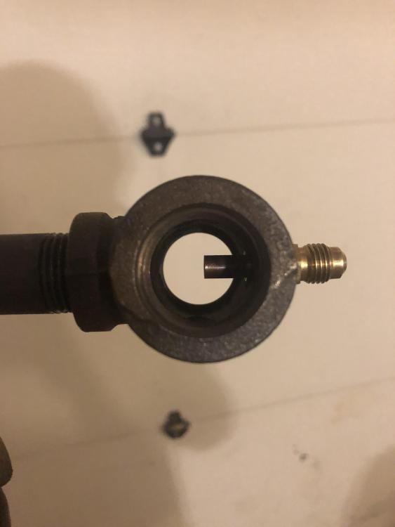

  7. The cast nozzles were made using 3D printed forms that mimic the 1:12 taper spec that seem to be the standard. The taper starts approximately 1/2” into the lining measured from the shell. Once up to temperature the forge is only running around 8-10 psi. I’ve tried cranking up the pressure some but it doesn’t do much besides speed up the sputtering sound.

  9. And by "heat issue" I mean for the burner components, sorry.
  10. After trimming more tips for these burners they're pretty close to even with each other, but the front burner is still running hotter. A new tip on the back burner took care of the excessive "richness" that it was showing. The flames themselves also look fairly similar. I decided to run the forge up to temperature and stick some steel in there to see how it performs, and, given that I was under more optimal lighting, I might dare to say that it's looking rather yellow to me, although I kind of want to order a thermocouple or something to measure the temperature so I know for sure. The dragon's breath is mostly blue with some orange in there, but it would change to green every now and again, probably due to some copper that wound up in the chamber from fiddling with the copper tubing and sanding down mig tips all day. The forge worked wonderfully for an hour or so and then both burners began suffering at almost the same time. I heard the change first and then small pops/poofs at the tip itself would happen occasionally and the burners began sputtering rapidly, even with the doors wide open. I shut it down right after. During the cool down I flipped them back on and they would only sputter the same way. I'll check/clean them out for debris tomorrow, but I'm curious if this could be a heat issue as well? Let me know what you guys think, thanks!
  11. Bending the tip didn't seem to do much, and I went ahead and replaced the tip on the back burner, as filing it down some more didn't do much. I was too aggressive with the tip file. I went ahead and made another pair of T's, making sure that they line up with the mixing tube. I'll swap those out and see how it goes.
  12. I guess I'll find some more T fittings and try and do a better job at centering up that hole for the MIG tip just right. And by "lifting off" you mean how the flame tends to wander from the flare opening, which looks to be a problem with both burners, correct?
  13. I run tip cleaners through them pretty thoroughly after I sand each little bit down, I saw what you meant and ran the cleaner through again. Shaped up a bit better.
  14. I've since placed the burners back in the forge. I started tuning the front one and I think it's pretty close, definitely improved. I've been working on the back burner and have trimmed off quite a bit of the tip, but it still appear to be weaker than the front one and tinged green, but it's shape improves whenever both burners are running. I'll post pictures below. YouTube link here. Front Burner Back one, not as clean a cone. Likes to smoosh into the floor initially, cleans up when both are running. Both running together, front one is clearly hotter. Frosty, my mig tips are 0.023". In terms of determining alignment I've basically just eyeballed it. I had help making these with a bridgeport and they look pretty good. I left the front burner in the forge because it seemed to be running very well, but the rear one had issues so I took it out and took some pictures of the tube.
