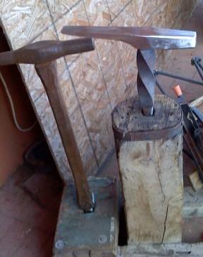

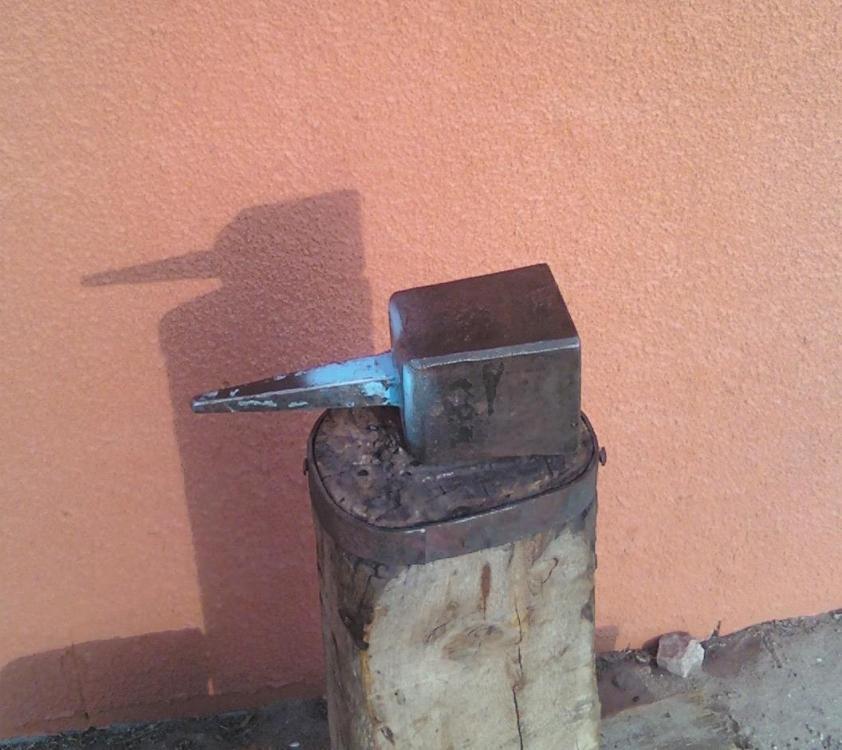

ThomasPowers Posted August 7, 2020 Share Posted August 7, 2020 Funny I've seen a lot of medieval and earlier anvils with smaller than 1' sq faces, Viking era ones could be quite small from the archaeological finds. My 5" anvil is in the upper end of a lot of excavated ones. (Laying on it's side to show the spike that goes in the stump.) Now some larger ones did exist: "Cathedral Forge and Waterwheel", Gies & Gies has some nice illuminations of smiths at work. Need a horn? A simple stake anvil is not that hard to make; just tedious if you don't have a striker or powerhammer. These are made from sledge hammer heads Quote Link to comment Share on other sites More sharing options...

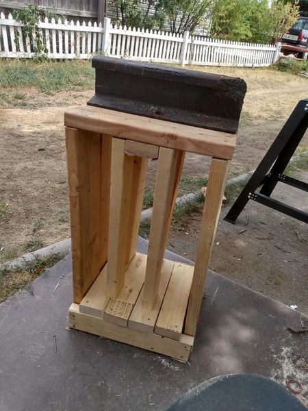

Tracemaster Posted August 27, 2020 Author Share Posted August 27, 2020 (edited) I don't know if this is the right place to post this, so please let me know if it is. I have made a couple of posts looking for advise on building forge and anvil stands and i finally got them built (after a lot more hassle than it should have been). Here they are, i built the anvil stand from scratch, but i wanted to start with the forge stand (since it was the one I knew I would need help with. However in the process of helping me the person that did got so frustrated they just went and bought me a tool stand from harbor freight. I have not mounted the anvil, as I am still deciding the best way and best location to do so. Edited August 27, 2020 by Mod30 Thread's merged Quote Link to comment Share on other sites More sharing options...
Glenn Posted August 27, 2020 Share Posted August 27, 2020 The way you have the anvil mounted is ok for light work. Turn it on end so the mass of the track is directly below the hammer (vertical) for a little better performance from the anvil. Quote Link to comment Share on other sites More sharing options...
ThomasPowers Posted August 27, 2020 Share Posted August 27, 2020 I'd bolt a piece of sheet metal to the forge stand so you would have a place to lay down hot items to cool and have it extend enough you can put firebricks on it to make doors for your forge. Quote Link to comment Share on other sites More sharing options...
Irondragon Forge ClayWorks Posted August 27, 2020 Share Posted August 27, 2020 That along with casters to move the forge around easier. We seem to move the propane forge a lot. On the forge an air curtain is a nice addition, saves a lot of heat on your hand when putting stock in or taking it out. Quote Link to comment Share on other sites More sharing options...
Tracemaster Posted August 27, 2020 Author Share Posted August 27, 2020 I was thinking about removing the angle iron you see on the forge since it seems like they would get in the way. I decided to mount is horizontally for, simplicity, mobility and cost efficiency. Smart thinking with the sheet metal, would aluminum work or does it have to be steel? Quote Link to comment Share on other sites More sharing options...
Frazer Posted August 28, 2020 Share Posted August 28, 2020 Aluminum will work, it is a much better conductor of heat than steel is and will therefore char the wood below it much faster than steel (there is a reason why most heat sinks are made of aluminum), but it would still be better than nothing. Regarding horizontal vs vertical, I don't know why vertical mounting would be any more expensive or less mobile, but if you prefer to use it as is, it looks like it will work well enough. Quote Link to comment Share on other sites More sharing options...

JHCC Posted August 28, 2020 Share Posted August 28, 2020 Tracemaster, a couple of diagonal braces on that stand would also not be amiss. Quote Link to comment Share on other sites More sharing options...
