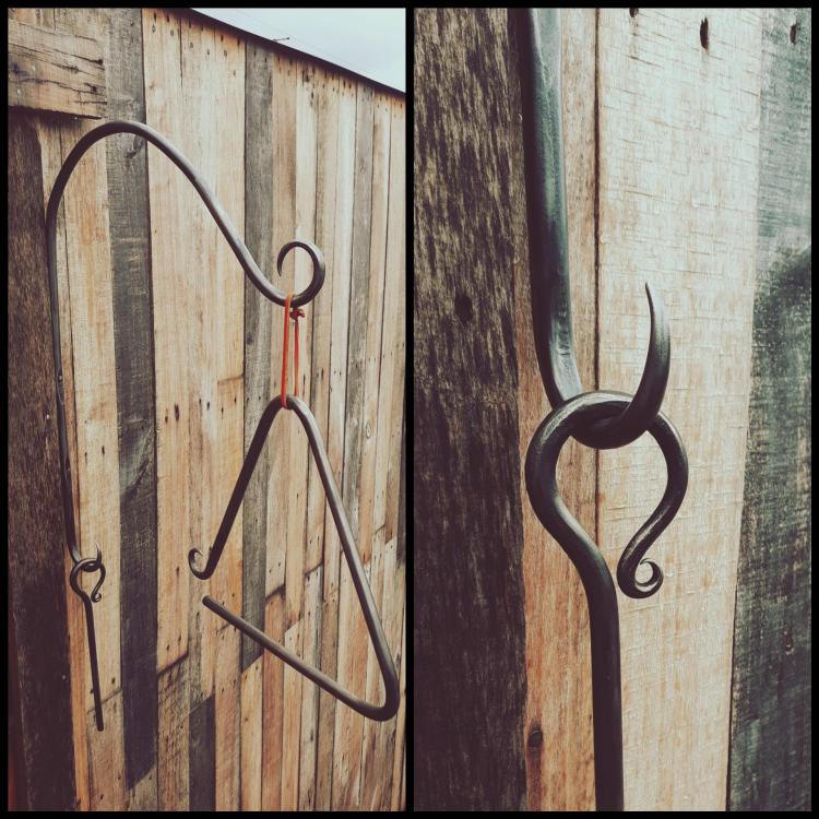

CrazyGoatLady Posted December 4, 2019 Share Posted December 4, 2019 Here's the dinner bell for my FIL. 1/2" round from crusty old bar. The clanger, or whatever is called, is a horseshoe. I wire wheeled the triangle then heated it with a torch then coated with paste wax. He has a small one that he can't hear, but this one will bring the cows home! Quote Link to comment Share on other sites More sharing options...
BillyBones Posted December 4, 2019 Share Posted December 4, 2019 Nice triangle, i have heard it is not the easiest task in the world to get it a nice triangle shape with all the sides the same. I have never tried one so i do not know. Quote Link to comment Share on other sites More sharing options...
ThomasPowers Posted December 4, 2019 Share Posted December 4, 2019 I've always made them so the sides are not the same length so you get different tones when rung. CGL---very cleanly done for a crusty old rod! Quote Link to comment Share on other sites More sharing options...
CrazyGoatLady Posted December 5, 2019 Share Posted December 5, 2019 Thanks guys. Billy, I looked at a lot of examples and a few videos. This one was inspired by John Switzer. I did a different finial than he does. Started at 37". I tapered both ends 1 1/2 ". Then just measured the distance equally and bent it there. Easy peasy. Thomas thanks. That piece of bar looked like it had barnacles growing on it. Quote Link to comment Share on other sites More sharing options...
ThomasPowers Posted December 5, 2019 Share Posted December 5, 2019 I like that sort of thing for "pre-aged" pieces but the areas that get forged end up looking different. Bends don't mess with it as much. Of course the first few heats where all the crud comes off is an amusing time---PPE to the rescue! Quote Link to comment Share on other sites More sharing options...
CrazyGoatLady Posted December 5, 2019 Share Posted December 5, 2019 It was the longest piece of round rod I had. The barnacles were mainly on one end. You can tell on the far left of the picture the texture is much rougher. I don't wire wheel things much, but I figured this might benefit from it. Plus I couldn't figure out how else to get rid of the gas forge rust from the piece! I have trouble with that from time to time Quote Link to comment Share on other sites More sharing options...

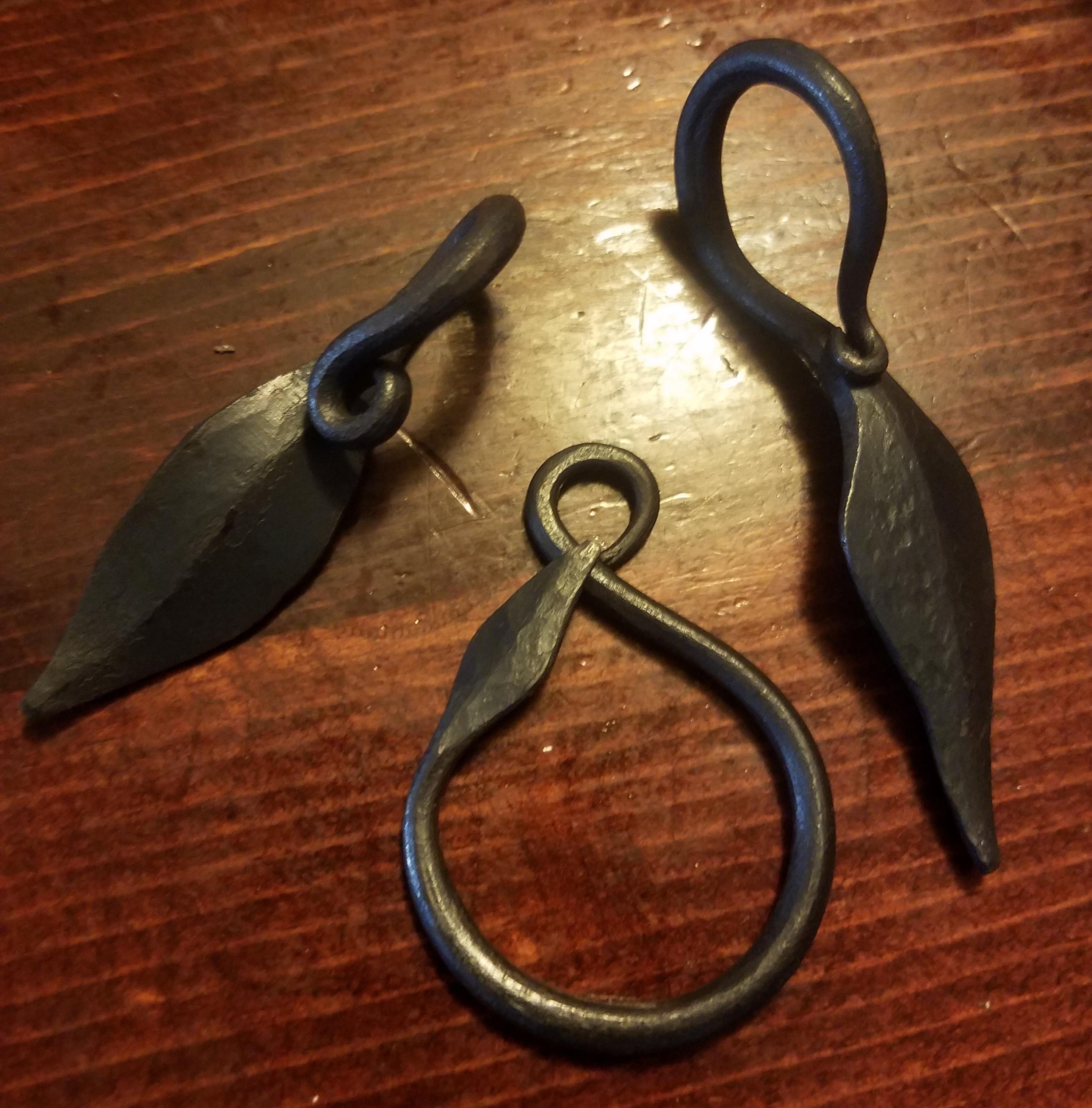

CrazyGoatLady Posted December 6, 2019 Share Posted December 6, 2019 Thomas, you look just like Santa! I think Billy deserves some coal, though. I don't know how much coal is, but I bet he could use it. Haha, you're posting at the same time as me, Billy. Olfart, nice. I like those. I made some small things. I'm on a leaf kick right now. Thought my husband can take the key rings to the guys at work for gifts. The one in the middle is a pendant for my daughter. Figured I'd put a leaf on it also Quote Link to comment Share on other sites More sharing options...
ThomasPowers Posted December 6, 2019 Share Posted December 6, 2019 Leaves for the family tree CGL? Need to deep punch the initials, clean and forge braze with brass and then grind till only the initials are in "gold"... I have a better pic with a much brighter red shirt where I do make a pretty good "Santa's evil twin Skippy". Last year I went down to the factory floor to wish my line a Merry Christmas the last day before the break and ended up spending 2 hours as all the lines were shutting down and taking selfies with me---and of me offering their supervisors coal... Quote Link to comment Share on other sites More sharing options...
