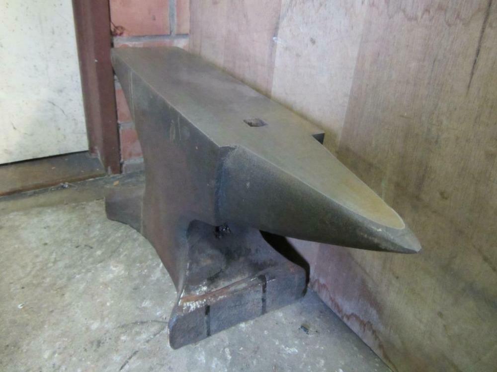

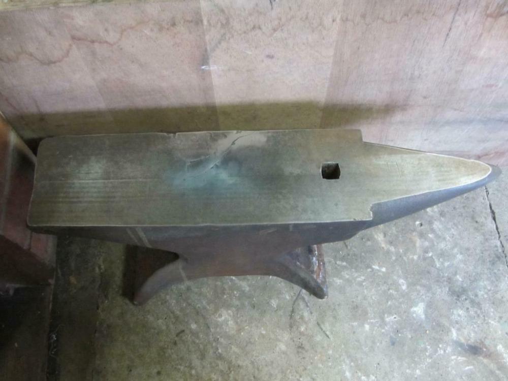

BartW Posted September 17, 2019 Share Posted September 17, 2019 Hello All; Well; after I've shed some tears, I've found a destroyed anvil. I was looking for anvils as usual; but I let this one go ... as it's essentially destroyed. But there's a lesson here: NEVER mill the face of an anvil. Even grinding is nope (except in case where you know what you're doing). The pics below say enough. You can even see where base comes peeking through the top plate. Also very strange horn shape. Probably someone who found this (good) anvil; but wanted to sell it for 'new', and had access to a large mill; so he probably milled off most of the top plate. Sad ... Quote Link to comment Share on other sites More sharing options...
Stash Posted September 17, 2019 Share Posted September 17, 2019 Wow, that's a shame. Glad you knew better than to buy that abomination. Steve Quote Link to comment Share on other sites More sharing options...
Kozzy Posted September 17, 2019 Share Posted September 17, 2019 I just want to slap people sometimes. So many posts (elsewhere) from people who plan on "fixing" what is already a perfectly serviceable anvil by milling, grinding, or welding that I have almost given up trying to explain why that's a bad idea. The other one that comes up often is "welding those worn edges so I can grind 'em nice and square again". Ugh. If you want a brand new looking anvil, buy a brand new anvil. Save the repairs (if one *must* try such a thing) for real basket cases that are already far beyond the usable stage. No matter how you say that some places, it seems to fly right over people's heads and some dolt chimes in about grinding those (minor) dings down and tossing on some weld bead. Can you tell it frustrates me? Hard subject not to get tossed off the forum for using lots of expletive words regarding. I'll just say "Golly that's a sad anvil in the photo" and do my swearing out loud. Quote Link to comment Share on other sites More sharing options...

Bob Brandl Posted September 19, 2019 Share Posted September 19, 2019 You know what makes me want to slap people? People whining and fussing about what other people decide to do with their tools, and stating opinion as gospel truth. I'll grant that whoever worked on that anvil does appear to have wrecked it, but that was their decision and they have to live with it. I've done more than a few repairs on anvils and other blacksmithing tools, and more than a few of those times I've used a mill or grinder. Should someone work with mills, grinders, or other cutting/grinding/welding tools without knowing what they're doing and the particulars of what they're working on? No, of course not. But if someone knows what they're doing, or knows someone who does, it's a perfectly valid way to fix something/clean something up, as is welding up an anvil face or corners if necessary. It's a shame about that anvil, but it's not your problem to deal with, it's theirs. Quote Link to comment Share on other sites More sharing options...
pnut Posted September 19, 2019 Share Posted September 19, 2019 2 hours ago, Bob Brandl said: I'll grant that whoever worked on that anvil does appear to have wrecked it, but that was their decision and they have to live with it. I do agree that people can do whatever they want to do to their property and it's really no ones business. In this particular case though ,they're not living with it ,they're trying to sell it to someone who may or may not know how much damage has been done to it. Hopefully they're being honest with whomever they're trying to sell it to. I use a vertical rail and am happy to have it, but I would like to have a German or London pattern anvil ,so it does make me a little bummed to see an anvil that might have been usable turned into something unusable. Oh well there's more anvils out there. I just have to go out and look for them. Pnut Quote Link to comment Share on other sites More sharing options...
BartW Posted September 19, 2019 Author Share Posted September 19, 2019 Well it isn't mine, and given it's not my property the owners can do with it pretty much what they want. It's just sad. Especially when It might have been usefull for someone searching for an anvil. Quote Link to comment Share on other sites More sharing options...
jlpservicesinc Posted September 19, 2019 Share Posted September 19, 2019 Education and the ease to good information and hence knowledge is so easy today that anyone ruining such a piece of history is well a travesty. Owner, not owner who ever.. Would someone take a piece made a few hundred years ago and cut it into pieces.. LOL.. This is a joke of sorts as there are many, many pieces of history everyday that are ruined both by personal arrogance and in search of something better or to make better. Historically people were smarter in certain aspects vs today though we all have access to more information than ever. Common sense being one of them.. I am not a smart person. but, my interests have lead to hours and hours of information searches. I have said it time and time again. I hate to see a piece of history. anvils, vises, forges, steam engines, water turbines, dams, etc, etc, etc destroyed but it is human nature. Instead of fixing or keeping existing infrastructure it's easier to spend on new ,mentally. Prosperity does strange things. Do with, instead of without.. this past weekend I spent time at the NEB fall meet and had the choice of 8 different anvils. LOL. I chose the one that was swayed back like a camel but was quite.. It had 2 flat spots. What more does one need. This is what I made. Quote Link to comment Share on other sites More sharing options...
Nobody Special Posted September 19, 2019 Share Posted September 19, 2019 You could take a Monet and cut it up for dishrags too if you owned it, but I would still consider it a darn shame. Milling that down like that is NOT a fix, and they didn't know what they were doing. Heck, it doesn't even look like they milled the bottom first so that it was level. Quote Link to comment Share on other sites More sharing options...

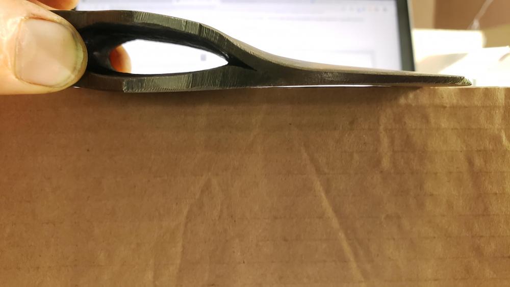

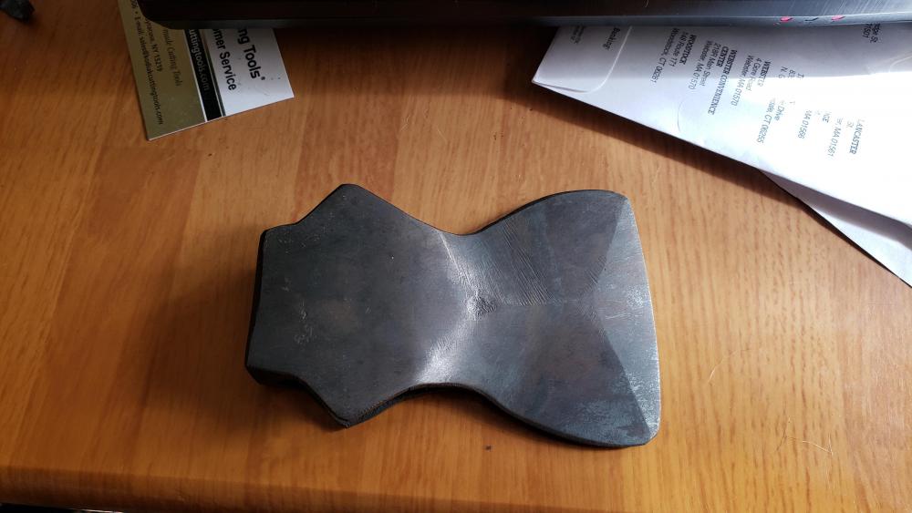

jlpservicesinc Posted September 23, 2019 Share Posted September 23, 2019 I never did post the photo of what I made on that swayed back anvil. So here it is. Had I known this thread would have came up. I would have taken photo's of the anvil too. Skill dictates what full possibility is. It is not the tools or the equipment that make an item outstanding. It is the person doing the work..... !!!!!!!!!! Where a perfect anvil comes into play is when you move into a professional realm where each divet in the anvils face is a problem for the finished work. "Time" is the cost with damaged faces. I stated it as damaged faces to make a particular point. In the olden days anything of value was in mint shape. A smith whose work were perfect and his tools were perfect showed the level of proficientcy with his tools and skills. If you walked into a shop where the guys tooling was all beat up it would have made you wonder what is the crap the guy was pedaling. Don't get me wrong. If the guy who had worn tools and was producing great work. this comes back to my previous statement about it's the skills that dictates the outcome. But, as time marched on many believe it's the tools that produce the perfect work vs the person behind the tools.. I see this all the time today. People thinking it's the good tools that produce good work. It's one of the reasons I love going to the NEB meets and using the equipment they have. It lets others see the level that can be achieved. Mild steel, welded eye, off center eye, with rasp only welded onto one side (flat side) As finished (hardened and tempered in water). You can see how flat it is for working on an anvil that was swayed back like a camel. Again every swayed back anvil has 2 flat spots. Anachronist58, that is a sweet anvil. I'd use the heck out of it. I love the way the sides round away. I miss my old HayBudden for the generously rounded far side corner. Made for easy tapers on scarfs. these New sharp edged anvils are terrible as the corner is always in the way. Because they are new I hesitate to round them back as far as I like and will take me 3 or 5 years to get there. Quote Link to comment Share on other sites More sharing options...

George N. M. Posted September 23, 2019 Share Posted September 23, 2019 Jennifer: I have always known asymmetric axes as "carpenters hatchets" because you could use them to trip a piece of wood without leaving chop marks. Around here you occasionally come across large asymmetric broad axes which were used by "tie hacks" to smooth two side of tree trunks for use as railroad ties. IIRC the helves of these were S shaped so that the tie hack could stand and still have the axe head parallel to the ground. "By hammer and hand all arts do stand." Quote Link to comment Share on other sites More sharing options...
jlpservicesinc Posted September 23, 2019 Share Posted September 23, 2019 Thats cool. There are many different names. Siding down, hewing, etc, etc, etc. this is smaller than most and can be pushed pretty easy with the thumb as well as swung. The idea behind forging it really is the unknown limits only encounter when one believes there should be a limit. Besides it is a neat demo. Quote Link to comment Share on other sites More sharing options...

ThomasPowers Posted September 24, 2019 Share Posted September 24, 2019 Welding can repair an anvil IF DONE RIGHT. Most welders don't know the correct method and so their work may cause long term problems. (See the Gunther/Schuler anvil repair process.) Milling: I have seen 3 or 4 anvils now that I would have advised milling on the face and dozens that were damaged or ruined by doing so. (A friend had his milled down till the face was too thin to work on; many years later it took around 5 hours for a professional welder using industrial equipment to get it back in working condition at an anvil repair day.) People making major changes to their tools when they do NOT know much about them but are working from their own or others preconceptions is generally Not a good idea! Quote Link to comment Share on other sites More sharing options...
arftist Posted September 25, 2019 Share Posted September 25, 2019 I disagree that welding any anvil will improve it...except an already hopeless case. Especially just to build up edges. Quote Link to comment Share on other sites More sharing options...
