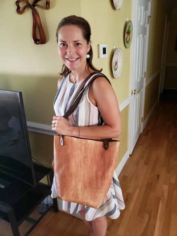

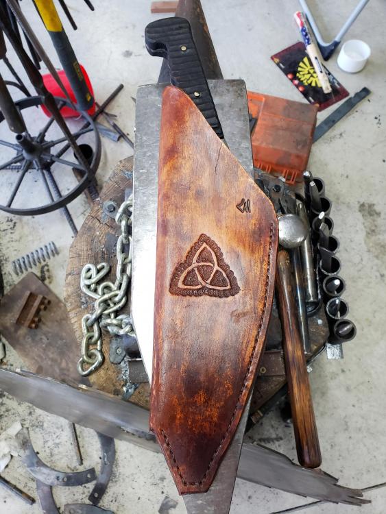

  1. I get most of mine from Tandy. Craftsman grade double shoulder. 6-9 Oz for sheaths. I did buy some superior grade for a tote I made for my wife.

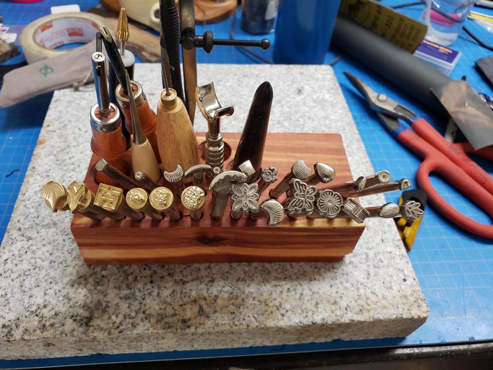

  2. I couldn't do it without my pony. Definitely wet the leather. I also made this little cedar block to hold most of the tools.
  3. It's really not bad at all. I have only been working with leather a few months and have really picked up on it fast. You can look up #cmaggardmetalworks on Instagram to see some of the sheaths I've been making. I just watched a bunch of YouTube videos, ordered some stuff and went at it,which is also how I started making knives and blacksmithing.

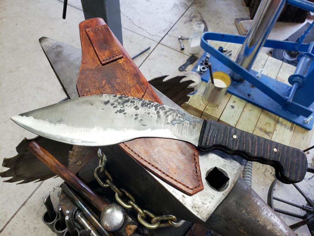

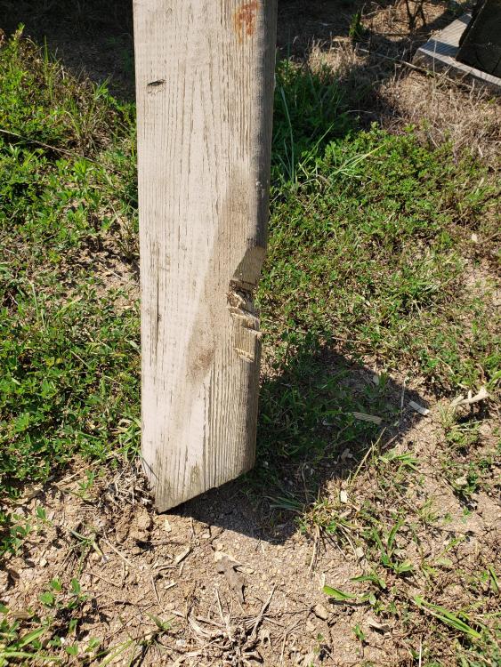

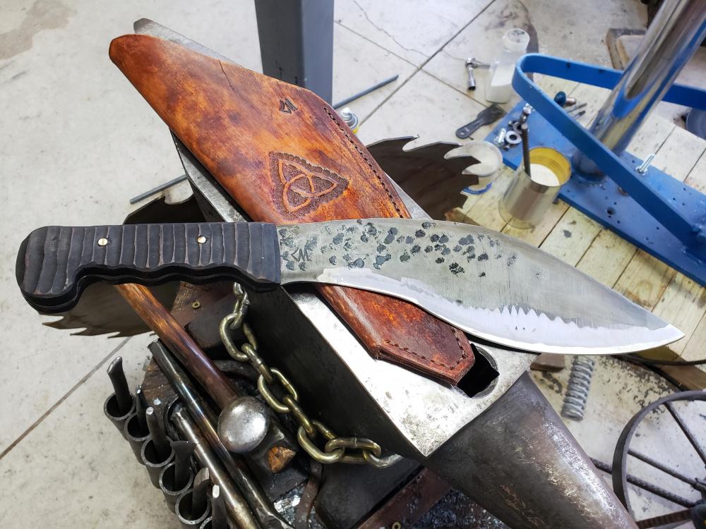

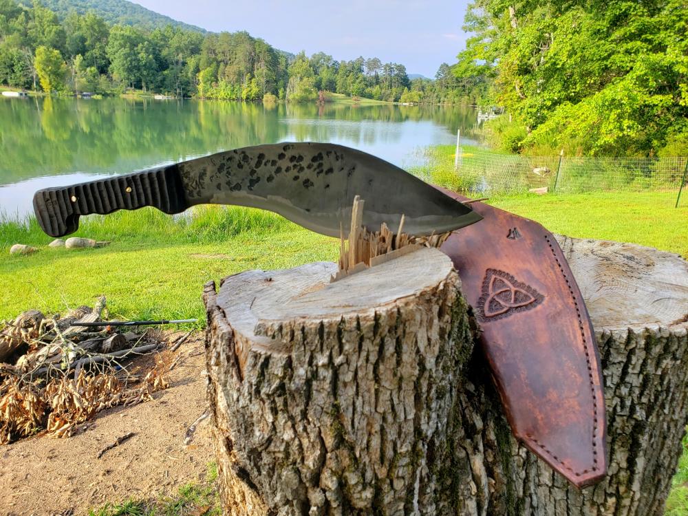

    This was made from a 29 inch saw blade from a mill. Sparked like xxxx, and hardened up good. I gave it a good test on this board, and it did perfect. I ebonized walnut, then sanded back the top for the handles.

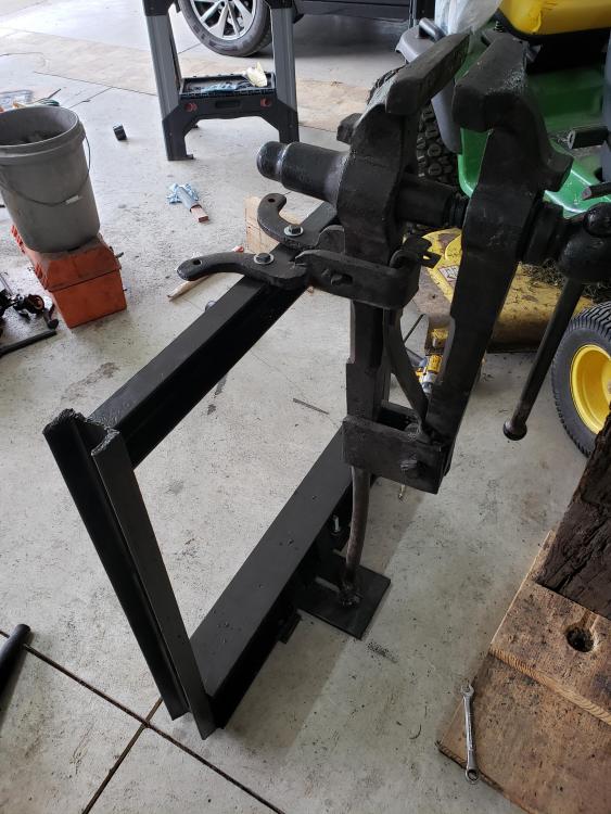

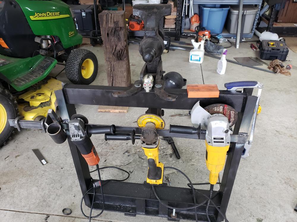

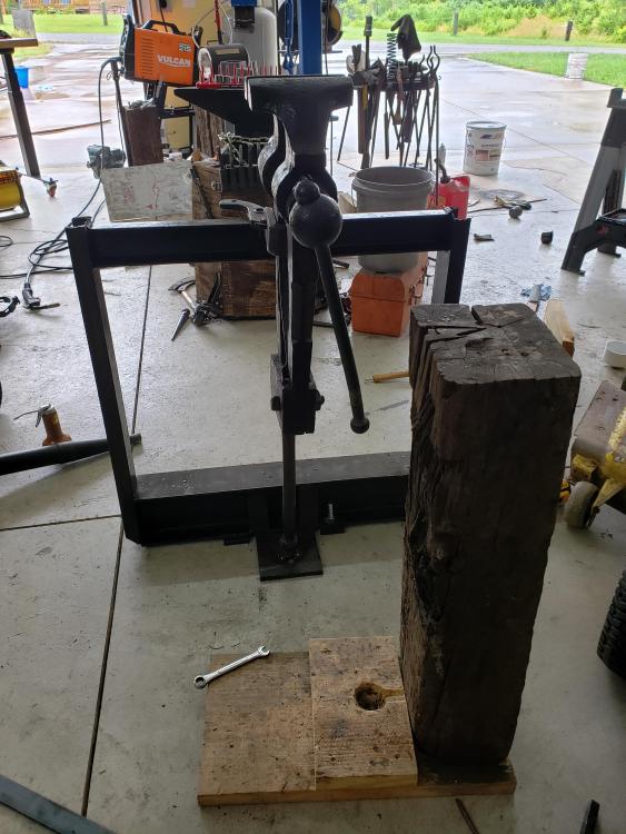

  10. You can see my first stand in the last Pic. After it rocked on me and got me burnt, I put it on the metal one with cement anchors. Added the grinder holding bar later.
