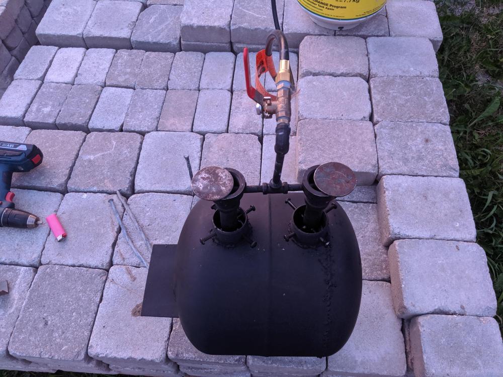

I am having a very confusing issue. I have built my own forge and burners. I have 0.35 tips and a 0 - 40 psi regulator. My issue is that for some reason I can't get that jet like burn. It doesn't have that jet like sound or pressure. I am at my witts end and I don't know what else to do?

Unfortunately, there are several bad choices involved in the forge construction shown in that video. The only change that you can use to help yourself now is to the burners.
Go to Ron Reil's burner pages on the Net, and look up my MIG tip upgrade to his drilled gas jets.
Did a quick scan of the forge video.  Doesn't look that bad to me, though I definitely advocate not just sealing the refractory blanket, but putting at least a skim coat of refractory over it for protection.  I've used a single layer of 2" refractory blanket for insulation (as it appeared was used in the video) and it has worked fine for me.  For the size chamber I would expect one 3/4" burner would suffice, but two isn't all bad (though it would certainly be nice to be able to modulate them independently).  I also don't like the video's use of a ball valve for metering gas, but you say you are using a regulator, so if it is a correct selection and working properly you should be fine there also.
It can be difficult to make a clean and centered drilled orifice for a single burner, got to be that much harder for two on the same pipe, even with the tee fitting in between.  If your regulator is working properly, that is most likely your problem, as Mikey indicated.
I figured out my major issue... Not enough air. I came to this conclusion by taking my burner out and blowing down the air intake and instantly the flame went to what it should me. How can I solve this. It needs more air.
I assume you have the chokes all the way open (I'm sure you do, but pays to ask).  Did you use tape on the joints?  If so pull the mig tips and make sure they are not clogged...a common problem to get little bits of tape stuck in the tip.  Pays to do that anyway to make sure they are not clogged but if both are acting the same that would be quite a coincidence.  It should be pulling the right air.  Those are 1-1/2 x 3/4 reducer fittings?  You're running at about 5 lbs pressure or so to test? Did you shorten the MIG tips?  if so you probably need to ream them out with a torch tip cleaner.  I seem to keep coming back to the jets....  If they are not blowing, or blowing in the right direction they will not entrain enough air. If you look directly down the burner, are the tips pointing straight down or off to the side?  Once more, both burners are acting exactly the same?

Listen to Mikey....look at Ron Reils site, that is basically what these burners are.

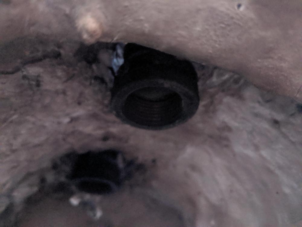

Note - looking at your picture, pull the burners up so they are above the level of the wool.  They will just burn off in time located so far into the forge.

I use for the fittings something called pipe dope (recommend buy my heating friend.) I have not trimmed or touch the tips at all. The bell reducers are at 1 1/4 all I could find but I just bought the 1 1/2 today to see if it helps. And the Jets were a little off but I'm correcting that when I replace the bell reducers. The forge burner level was lower then normal because I thought at first that was the issue. I'll keep it above the wool line from now on.

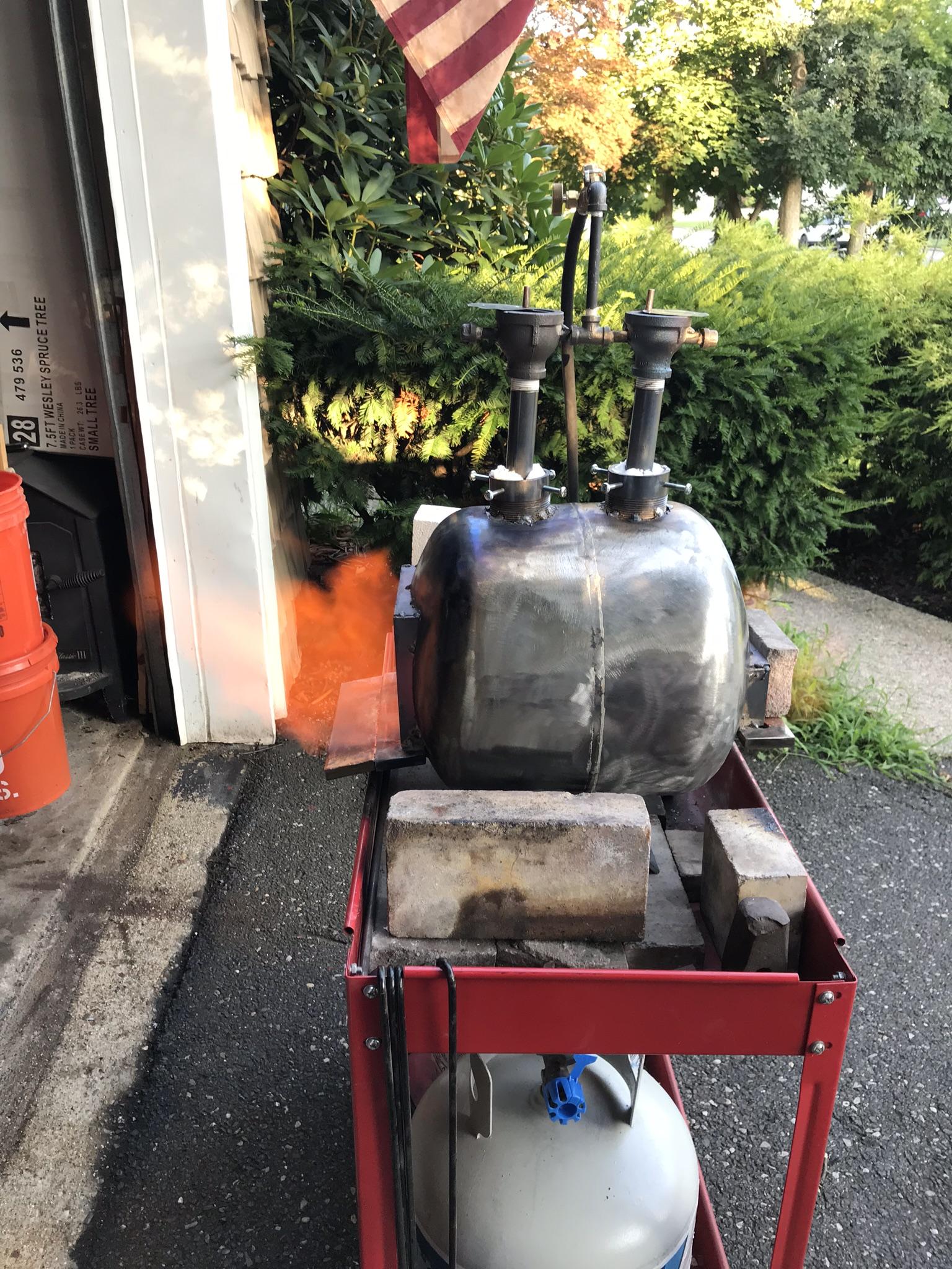

Hello all. I am new to this forum, and came across this thread while searching for the answer to a question about forge welding temperature. I’m posting it here however as I have this same forge built from the same video. I’ve learned a lot reading the site so far and fiddling with the forge I’ve built to try to get things running properly and here’s my question. Is flux required to forge weld, does it actually lower the required welding temp (or have I read that wrong) and is mild steel harder to forge weld because of its lower carbon content? I believe I have the answers from reading other posts on this site but I have nobody to confer with in my area on the subject so I’m looking to confirm. (Not required to weld but highly recommended, it does lower the required temp, and mild steel harder to weld than higher carbon steels.)
As for this forge build here is what I’ve learned so far with my version. The entire assembled burner I have is approximately 9 inches tall. The chokes are currently set at half open, with the pressure regulator on my propane tank set to 17-18 psi. Using the same parts list in the video posted above. I have found that a small 20lb propane tank is insufficient in being able to supply fuel fast enough. I experienced constant freeze up and a 40lb tank immersed in a small container of water performs much better even in cold temperatures. The lining is 2 inches of ceramic refractory fiber blanket that has been rigidized and coated in ITC-100. The floor is refractory cement (2300 degree rated if I recall). The top welds around the collar were a little sloppy so I have some of the ceramic blanket around them to seal any gaps. Where the burners are mounted with set screws, I found I MUST have that gap closed or the fuel/air mix would not stabilize. Once sealed it was a noticeable difference.
Currently running, the jets are approx the same size, stable with no sputtering and a consistent light-med blue (according to my eyes anyway). The DB starts out more blue with a hint of orange at the tip upon first start up but after approx 20 mins or so it is more orange throughout. I try to keep the front and back openings sealed as good as possible with firebrick while heating pieces.
I purchased a high temp thermometer that reads 2350 degrees F after 20-30 mins operating. I believe this is hot enough to achieve forge welding. I have flux ordered and will try again once it arrives, but having read several articles describing it being possible without flux I tried and failed. I believe I am making some sort of mistake at this point since the thermometer reads an adequate temp for welding (I think).  Also, the pieces don’t appear to have excessive scale while in the forge but they do scale considerably upon removal which is why I believe I’ve failed at welding thus far. I have posted some pictures of the forge while building and will also post some video of the forge running and temp readings. I’m hoping they all work for everyone. Thanks for your time and I’m looking forward to hearing some feedback etc. I hope it may have helped with your questions HazenDart.
