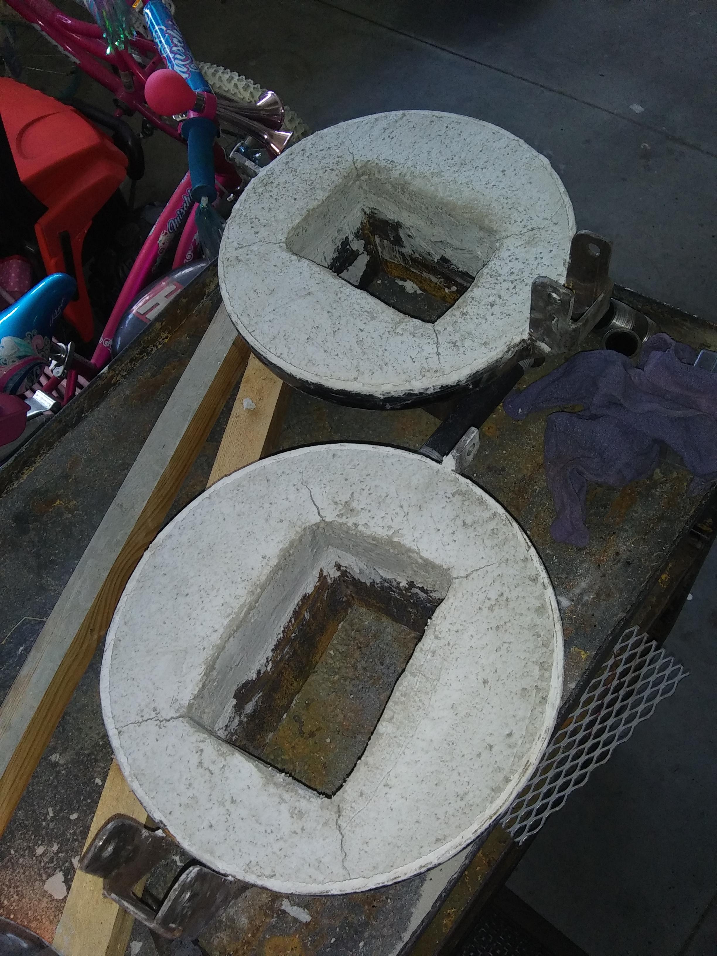

Thanks, Buzzkill. Yes i think that was some of the chemical moisture cooking off as its been set up for a couple months before being ran this hard. I am either going to trowel in a forge floor to use up some reale state or cut about 2.5 inches off either end. If I cut the ends, i am going to have to relocate the hinges and latches. I havent heated up anything significant yet. As for my purpose, I plan on experimenting with seeing how different metals heat, move and forge. Then i plan on moving to small things like leaves, bottle openers, steak turners and maybe oyster shuckers as I live in a coastal town. Ultimately, I dont plan on forging a claymore or anything huge, but I definitely would like to forge a knife. Thanks again for all the help and advice!

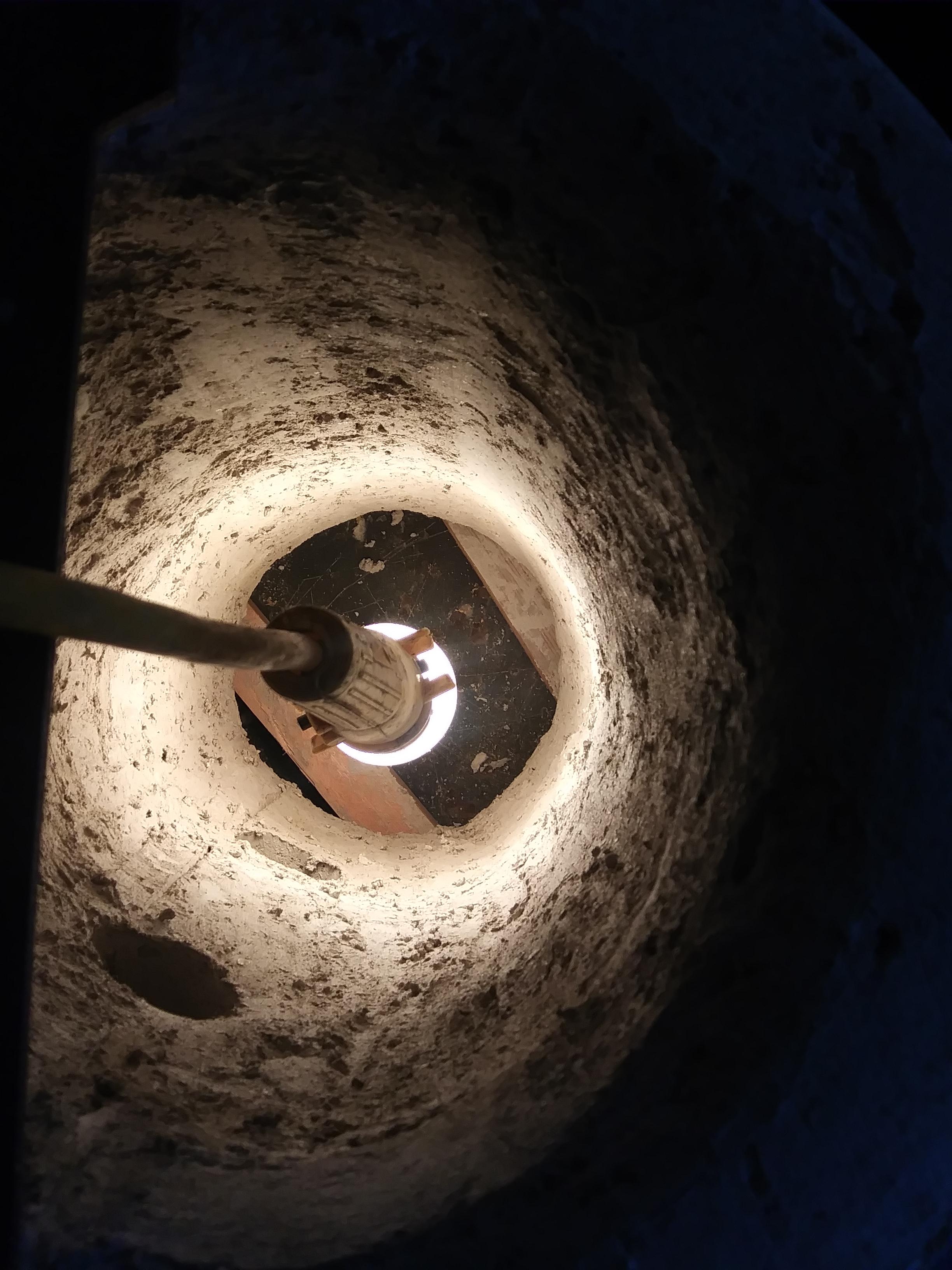

Ok new video. For kicks and giggles, I fired up two burners and ran it for 20 minutes before I took this video. She's pretty hot, but the story will be told when I evaluate fuel consumption. 20191122_162337.mp4

Just a quick update video. There is a lawnmower blade in one end and a piece of half inch no name solid stock in the other. Since I am so unfamiliar as to how the forge responds to heat and how the metal reacts, I just stuck a couple pieces of junk metal in to see how they take heat. I ran the forge for about 5-10 minutes at around 20-30lb pressure on the regulator. Both pieces of metal got cherry farily easily and fairly quick. I only have one burner in. The only time I tried two didnt turn out as smoothly as with one. Im going to have to study on it some more. Probably have to put throttle valves in and gag one so it doesnt steal all the fuel from the second burner. Take aways: 1. I still have a ton to learn. 2. The neighbors are going to hate all the racket associated with forging. 3. It was enormous fun! How does the flame shape look to yall? Is there any thing else I need to consider? I am going to look up some pf that reflective paint to coat the inside with also. 20191020_165311.mp4

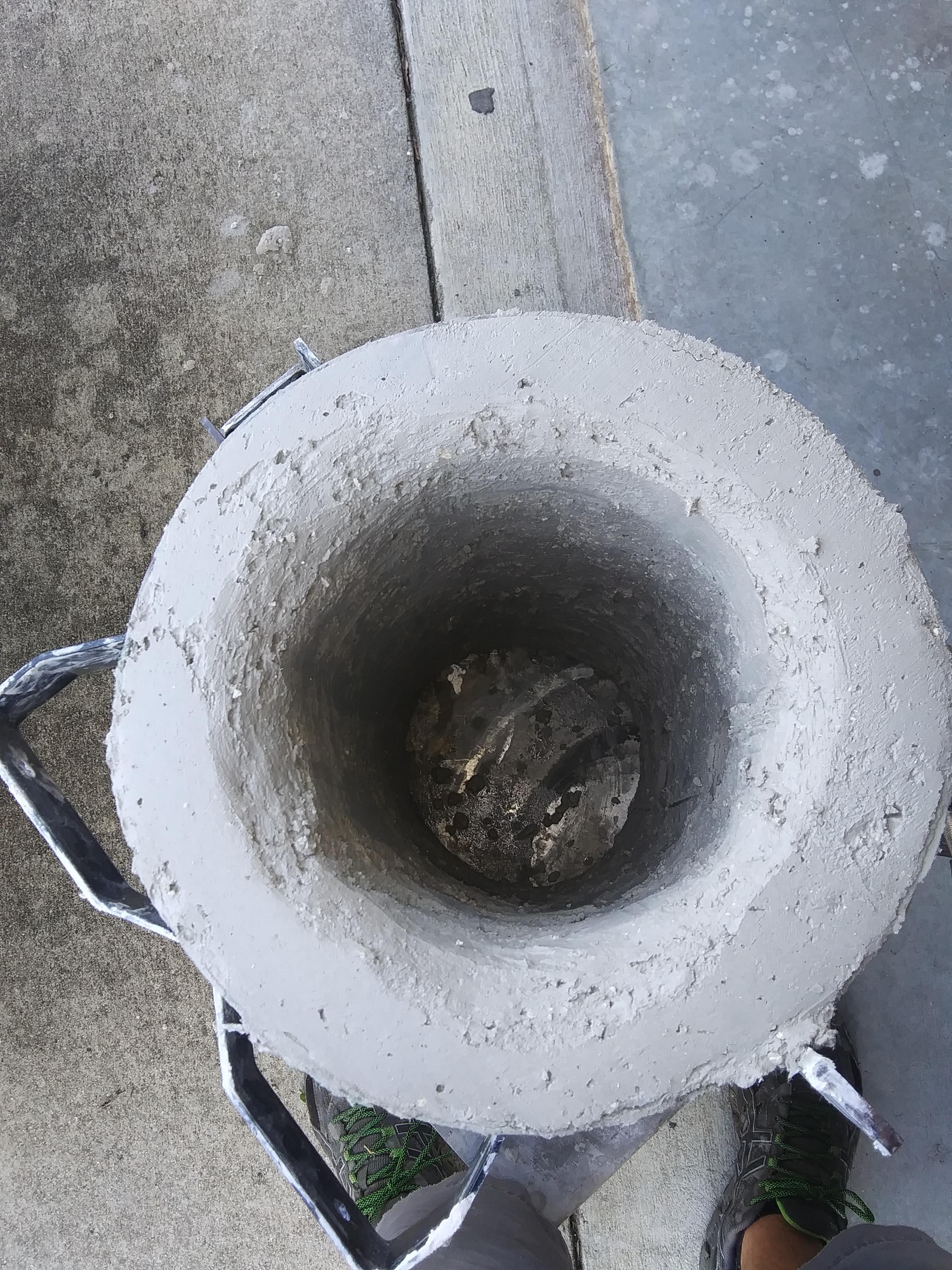

PNUT, i read somewhere that people had put theirs in a bag or container. Honestly, i forgot all about that step. The guy I got it from said in the industry where it is used, the best way to cure this type is to put heat to it. Low-fire or a lamp. Im glad it didnt crack. I will see how it takes heat when i get the lids fitted back up. Frosty, holy cow! 350lb hammer! Wow! I also have a piece of steel that looks like a big hockey puck. It is about 4" diameter and about 4" tall. Theyre used on rail cars to roll with the weight of liquid in tank cars. They dampen the "slosh" when the train stopps. It is good and flat, i just wish it were bigger! I also have 2 pieces of plate steel that are about 2.5-3" thick, I believe. Youre right though, whatever you use to bang out stuff with ends up being the anvil. My dad always said I could tear up an anvil... Hopefully i wont prove him right.
Yeah, Frosty, being an extreme novice, I cant swear to the technical aspects. However it didnt crack over night and it seems to be extremely hard... We shall see shortly how it performs. I see your point, Thomas, about the sweet spot. If this hobby of mine, turns into a habit, i hope to be able to justify a few hundred in a real anvil someday.

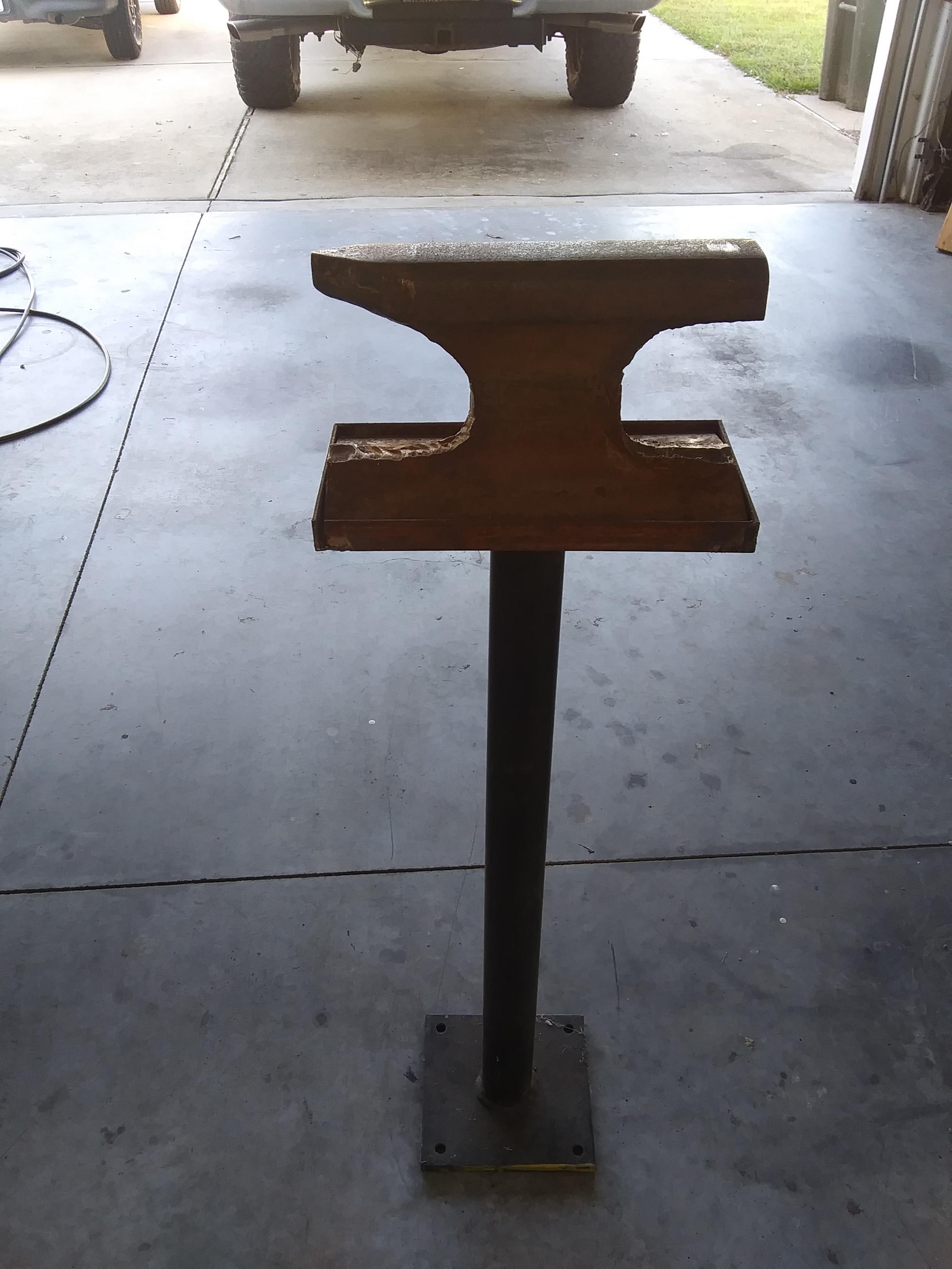

Also, for those on a shoe string budget like me, here is a very low cost anvil I made to get started on. I always heard you can have GOOD, FAST or CHEAP, but only get to pick two. I guess my two are CHEAP with half GOOD and half FAST...
...ever see that episode of Andy Griffith, where the city slicker comes to sleepy Mayberry? He's all in a hustle and bustle to get where he was going, but due to car trouble, he got held up. The slow pace of town was very irritating to the man and he was heard several times saying "For the love-of-Mike, just DO IT! DO IT!" Well, thats how you guys have mist likely felt with my questions ands and anxieties with this forge build. After a long wait on the refractory, I finally DID IT! I practiced my mixture consistency on the lids. It was more down and dirty than I wanted, not as smooth outcome as the first go at the refractory, but overall I am very happy with it so far. As I trowled it in and rolled the shell, I found that the mud tried to peel off as gravity worked against me. Not to be deterred, I trowled in as much as I could and then stood the shell on end to do the last bit. Thankfully, it held together so far. I lowered a drop light inside to slowly heat out the moisture. Should I worry about the cracks in the corners of the door openings? Can I just patch them after it cures? As always, thanks for all the helpful advice. Hopefully soon, I will put the burner(s) back in and see how she does.
