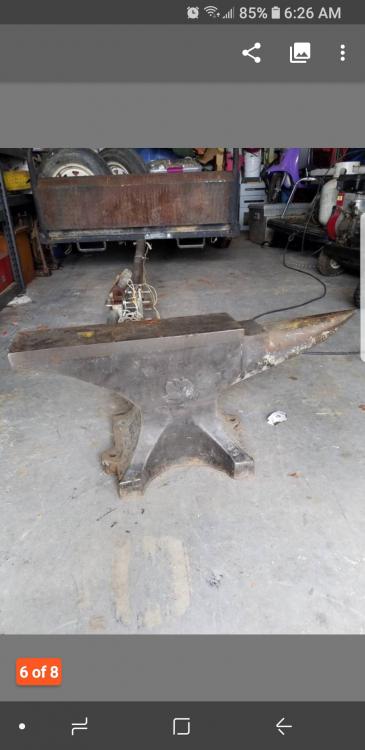

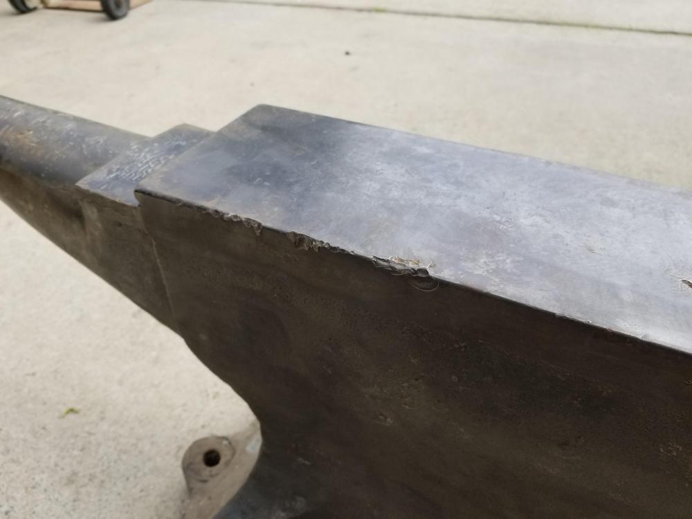

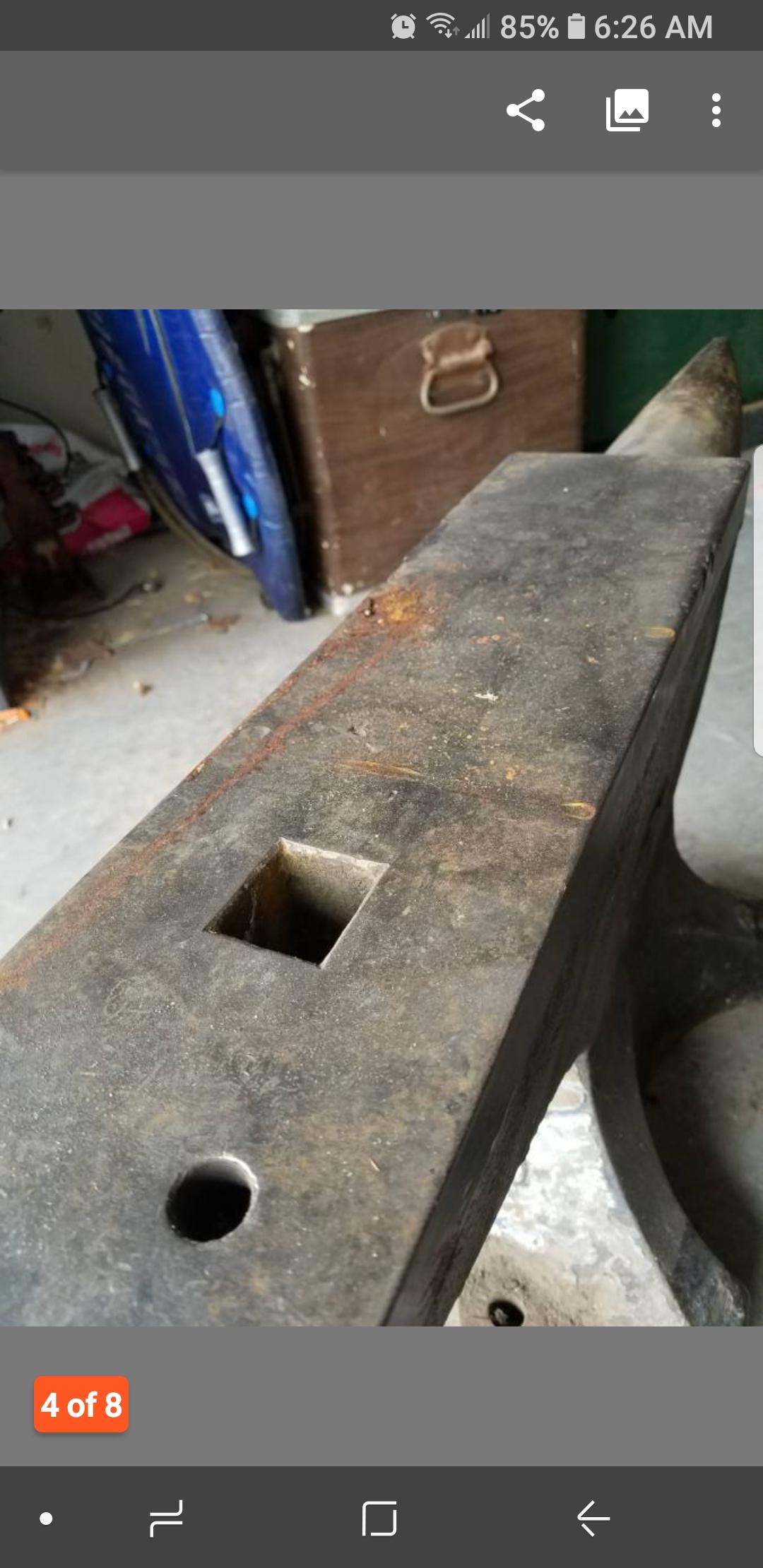

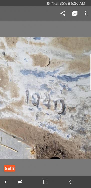

Brand new here. Thanks for any input. Thinking of purchasing this anvil. It is a 300lb Fisher. Rebound is fantastic and top plate is quite thick. Does have several chips along the edges but still a lot of clean edge. Also has a small chip in the face. That's the rusty looking spot in the close up of the hardy. That surface rust wiped off with my finger. Also the horn is really beat up, lots of long dents like it was used under a cutoff tool. (Is that something that can be repaired?) The guy is firm at $1500. Looking for opinions from more knowledgeable folks. 20190307_112715.thumb.jpg.49ef4e9671db6b894948bf729ec75754.jpg

That's about as close to a brand new anvil as one can get in the used market.  The edge chips are no big deal.  I don't see a closer photo of the horn damage you mentioned and the one which shows it doesn't seem to be more than superficial.  There is typical cutting damage on the table but that's what the table is there for.
But...that's a lot of anvil for most people.  Way more than the average guy needs.  $ 5 a pound is pretty high..up there toward some new offerings.  The real questions starts to become whether the money saved on a lesser anvil can be used for other smithing stuff and if that gives a greater benefit than the offered anvil at that price.  I'd personally lean toward a lesser anvil and more other toys unless I was diving into smithing whole hog and already had every other toy I could want.
In this area, that anvil at that price would likely find a buyer pretty quickly.  It's quite high but all anvils are high now...and some areas quite high is becoming a new normal.  I'd pass at that price, but if you choose to bite, it probably wouldn't be a foolish move in *my* area (location location location!) as it's possible to resell at about the same price with some patience.
A lot of pricing is location- based- is there an anvil drought in the area, or is it anvil rich? In my area, eastern PA, that might be a little spendy (at least for me). That said, that is a great looking anvil. The edge chips are pretty insignificant, and are typical of Fishers, which has a hard top plate. The top plate isn''t as thick as you  think- they are usually not more than 3/8 to 1/2". They are cast iron bases, so they cast  in a false plate for marketing purposes. Even at that price, if I didn't already have a few anvils, I would be very tempted by that one. Offer a bit less and use the chips and beat horn as bargaining ammo. Good luck.
