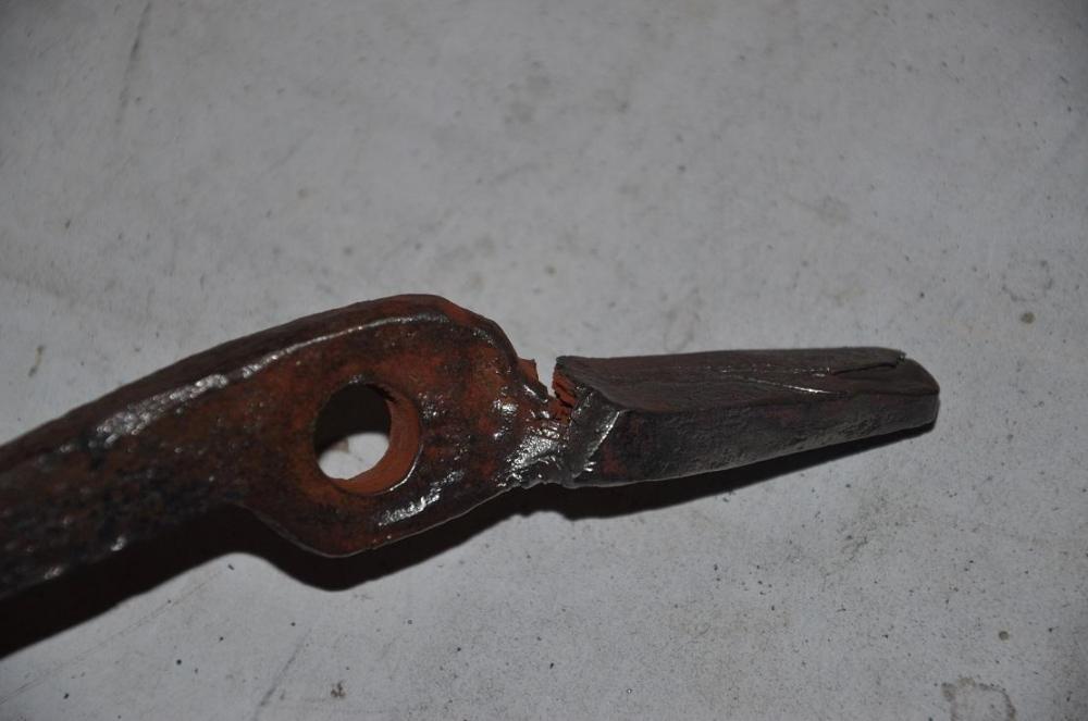

Speaking of old tongs, I found an old pair in the scrap with one broken rein. I had a *thought* that the long intact rein would make a really good neck and head for a bird sculpture, using the rivet hole for the eye. Only trouble was the offset. Got it really hot in the forge to take off the offset and sure enough -  wrought!! Even at almost sparking heat it just fell to bits. End of bird project.

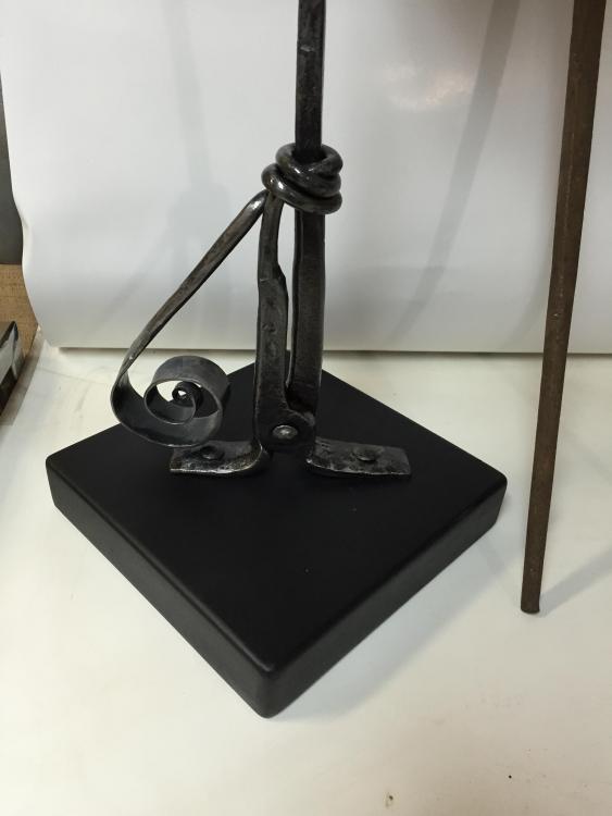

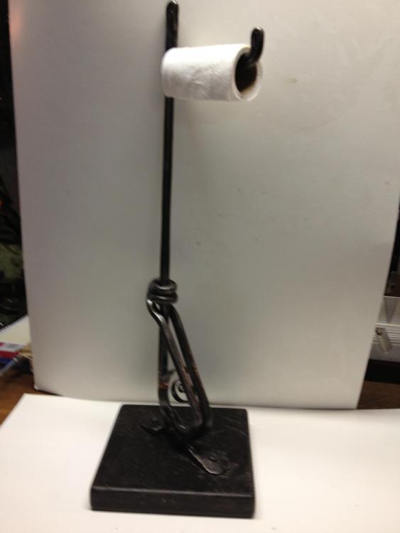

Greetings Aus,
        Old broken tongs make great after dinner roll holders. I made one and ended up making 2 more for friends that visited my bathroom. Fun and easy to make.

Nice idea, Jim. Spreading the jaws like that would make for some neat wall hooks, with one rein twisted and scrolled as a lower support. A bit like your roll holder side-on. Hmmmm.
Cool idea, Jim! And a nice piece.
