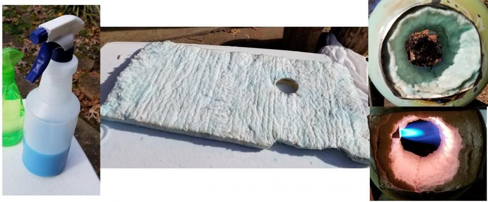

Ceramic wool:
This is easy.  It is available online and from current members here.  I found a warehouse for Harbison Walker International a half hour from me and was able to get a large amount at a good price.  Go with 1” material at 8# density. It is best to use two layers rather than one 2” layer.
Measure the circumference of your forge substracting ½ “ from the diameter (half the thickness of your wool) and cut ever so slightly large.  This will create a fit that is tight enough to keep the wool rigid in place. Before adding the second layer I rigidized the first layer and burned off the water with my burner.  The color of the dye faded to white as the wool heated up. When it was basically gone I stopped the burner. It took about five minutes, maybe a bit more. The second layer is added using the same math measuring from the new, smaller diameter created by the wool.
Ridigizer:
I bought fumed silica on Amazon and made my own using Jasen’s recipe.
"...used a cup of fumed silica in a pint of water. Idk if it's proper amount but it worked very well on my forge."
Add a drop of food coloring so you can see the rigidizer and ensure coverage.
Per Frosty:  It’s is critical that you butter the wool by spritzing it with water prior to applying the rigidizer.  Do this for both layers. The rigidizer should run between layers and bond them together somewhat after the second firing.

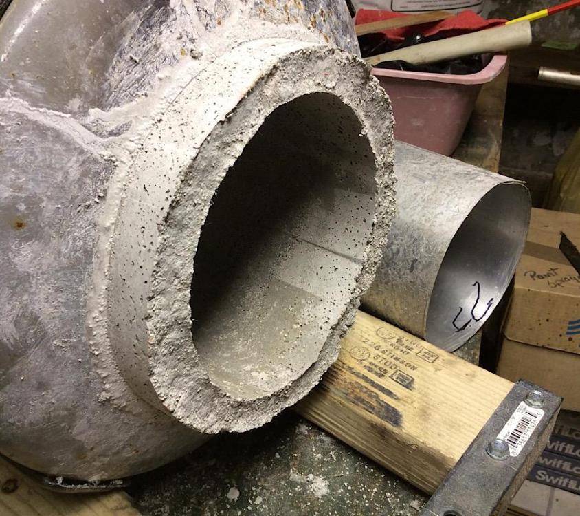

This post is just an example.  It is my response to the challenges I had before me.  Namely, I had to figure out how to cast the interior of the forge with kast-o-lite 30 and deal with the large rectangular opening for the ribbon burner.  In the end I chose to cast using a form made out of thin metal sheathing and a wood block shaped to fit the curvature of the metal cylinder.  Both were lightly coated with Crisco as a release agent.

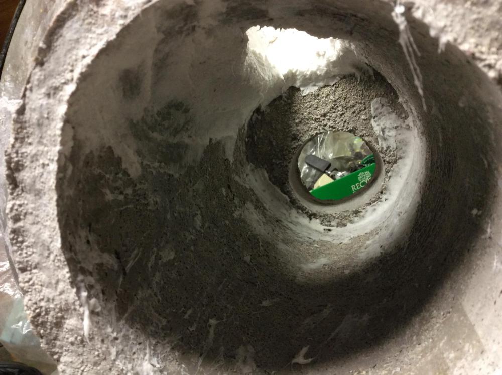

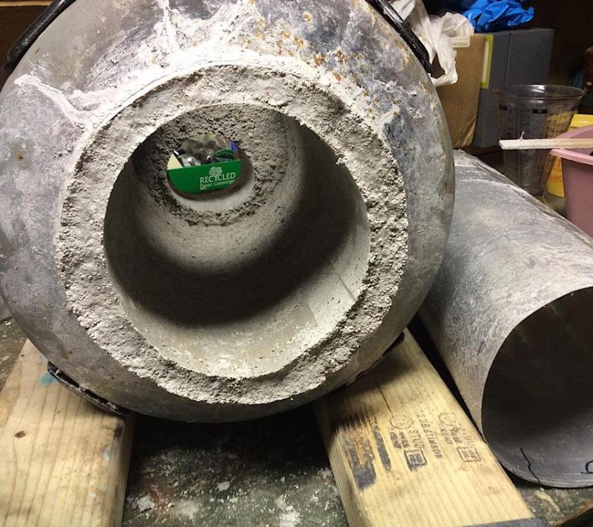

I first cast the bottom of the forge and the back wall.  I did this by making a round band of the sheathing slightly wider in diameter than the rear hole in the forge and stood the forge up on its end with the sheathing acting as both a support and a form for the castable.  This allowed me to have the castable protrude past the outside wall of the forge in order to protect it from dragon’s breath.  The back is not pictured but you will see how I did the same with the front of the forge as well.
Once this casting dried (inside a plastic bag with a wet rag inside to keep 100% humidity), I moved on to the next step of casting the rest of the forge.  Tip: do the casting inside the bag so you can pull the garbage bag up around the forge easily and seal it once you are done.

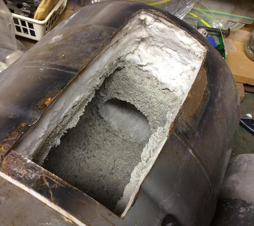

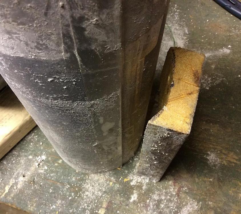

Next, I stood the forge on end, inserted the wood block and the cylinder, and pressed the castable into the space between the rigidized wool and the metal form.  I used a stick to compact it in.  It took two pounds of castable to do the back wall and hole and six pounds to do the rest.  You will notice how I used a ring form (metal sheathing) to shape a projection out of the front hole of the forge.  I have no idea how well this will hold up in use but I like the idea of managing dragon’s breath and adding a modicum of volume to the forge.
Here is a better view of the front.  You can see the difference in the casting between the part that was formed and the area that was just free cast.

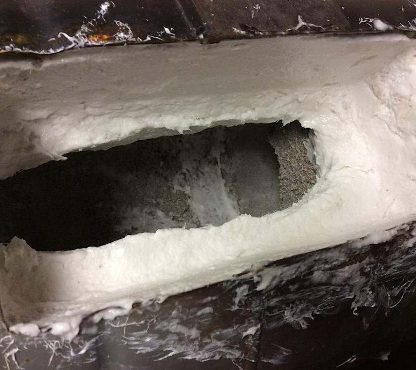

The next problem was dealing with the hole for the ribbon burner.  If you are using regular burners I think it is easier to deal with.  This, I learned, is one small drawback from using a ribbon burner with this type of forge.  I could have tried casting the port for the burner when I did the interior but getting to all the areas and making the forms work was annoying.  Therefore, I chose to experiment with Inswool Moldable since I had picked up a gallon of it when I got the other materials.  Here is the hole after I cast the interior:
The situation, as I saw it, was that I wanted the burner to sit back a little ways from the interior of the forge and I wanted a tight fit to eliminate heat escape from the burner hole.  I decided to create shelves with the castable that would support the burner in the desired position and also create a gasket between the inside of the forge and the burner port.

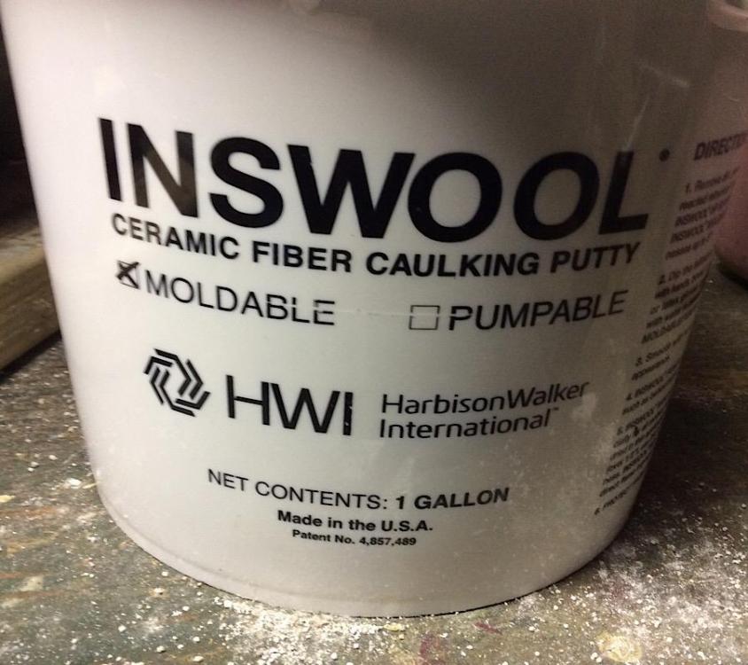

This is the Inswool Moldable.  It is rated to 2300 degrees and creates a hard flame face.  It requires minimal treatment in terms of drying/cooking before it is ready to use.
It has the consistency of a light clay.  It is not as dense as clay...I guess it is more plastic.  I simply put on a rubber glove and formed it by hand.  It was quite easy and, if it works out with long use, promises to be a very useful material for making forges.
My cast shelf for the burner:
I wrapped my burner in plastic wrap and used it to shape the Moldable.  I ensured that the ports in the ribbon burner were not obstructed, of course.
The only other bit of work I did was to create a small ridge in the interior of the forge to act as a barrier from the swirling plasma in the forge.  I found in my test firing (while cooking the rigidizer on the wool) that the burner did not like being right in the line of fire.  I figured that the shelves setting the burner further back was the most important fix for the problem but decided that diverting the vortex away from the burner face wouldn’t hurt.  This is what I came up with:
The picture isn’t perfect, but you will see the small ramp/bulge at the bottom of the burner port.  This is a contiguous part of shelf casting, it is not simply attached to the wall of the forge.  The mass of Moldable looks large in the picture but most of what you see is just a light surface smear from my messy hands.  The raised lump is only about 3/4” wide and high.
It is entirely possible, and possibly better if this Moldable proves weak, to do this with kast-o-lite.  However, I really found my method to be very flexible

Thanks guys.  Frosty, I have to admit that I was curious to hear your thoughts on the Inswool Moldable.  I need some real time on the forge to determine if the shelf/gasket  I formed works well.  Also, I have no idea if the baffle I made inside the forge adds up to nothing or if it will, indeed, benefit the burner.  You and a few others on here could help with insights on that.
Lou
I don't know anything about insulwool Moldable, if it works I can think of all sorts of places it'll be perfect. I'll be watching for your results.
I don't know how your baffle will work, I'll be watching for your results on that too. Keeping the burner block as out of the heat as possible is something I'm always interested in. A: baffle or deflector or spoiler or ? to redirect the flame around the burner sounds like a good idea if it works.
